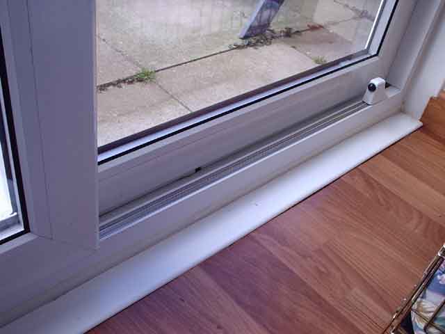

Hello there. Maybe someone could help with a query with my upvc patio doors. It opens from left to right and the door slides on the inside of the static side. When it rains I get water collecting in a gulley on the inside - there is a space about two inches wide where this water collects. I also get quite a draught caused by drain holes which are visible from the inside of the door. If you can make sense of what I am on about, I really would like to know if this is right. I wonder whether the d/g company have in fact put the doors in the wrong way round! Any advice would be very welcome. thank you :confused:

not sure if this is going to work but I will try anyway. If the picture comes through, you will see the picture is taken from the inside of my house and slides on the inside from left to right. The gap between the runner and the window frame is where the rain water accumulates.

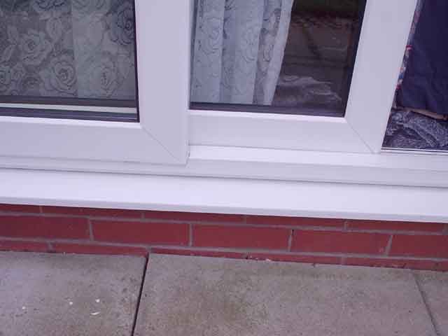

Sorry to be a pain, can you do another photo on the outside? Would like to see the bottom cill.
I had to write to the admin@diynot to add the pic as you will remember I had probs putting it on so not sure if they will oblige me by putting another on. If I know its no bother I could do this
No, they are very good and without you, me & others the forum would fall down! It can be very important to look at photo for better understanding and stop any misleading info.
All I can say is, it's either put in the wrong way round or a very bad design, I would say it's the wrong way round. As you says the rain onto the patio door will enter to the bottom runner on the inside. Need to be taken out and refit again and looking at the frame & the cill that should say as it is.
