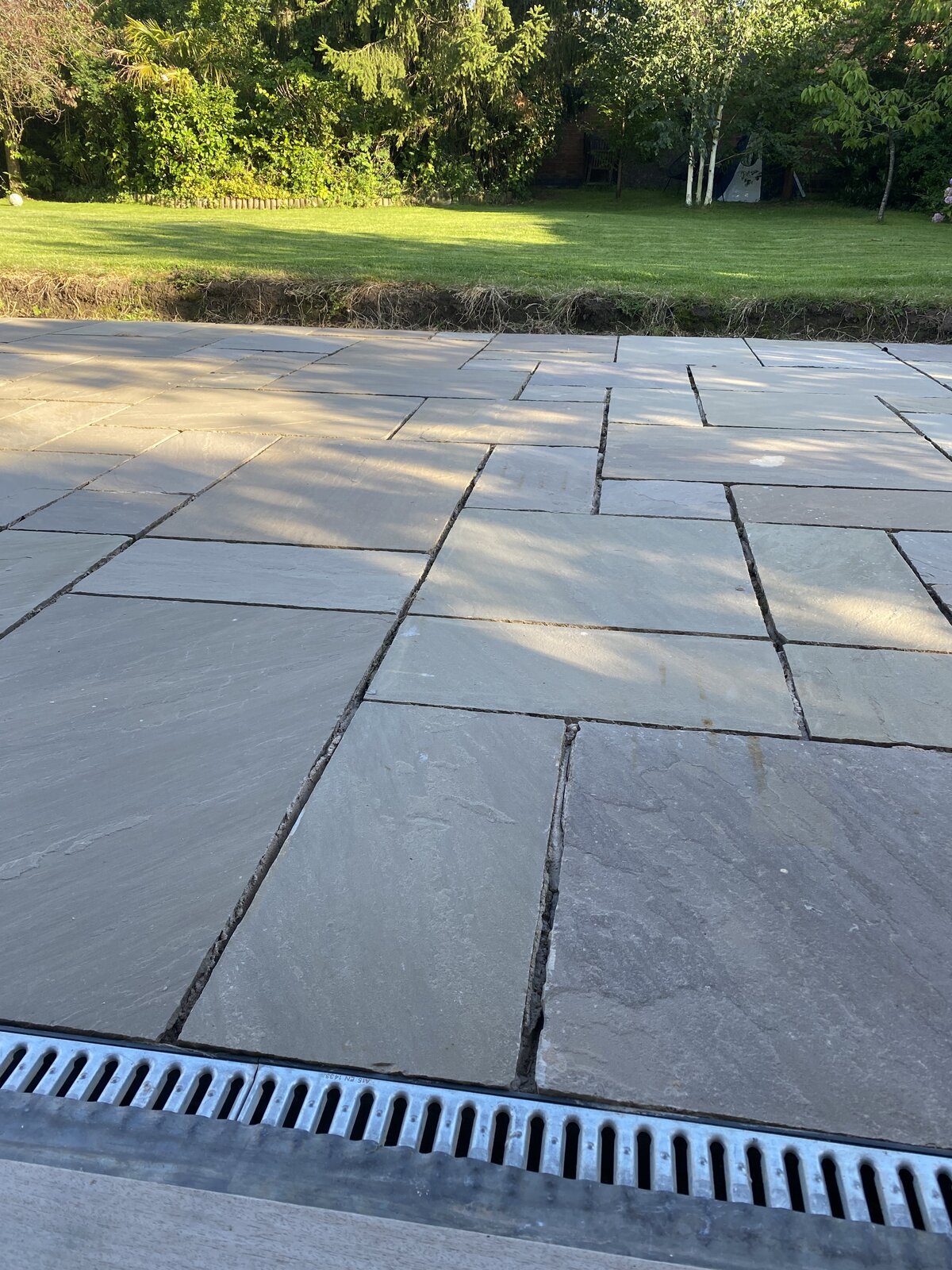

Hi - I have a question about a patio that a tradesmen is currently laying for me.
It is halfway through being installed and we haven’t noticed any problems yet, but on doing a little bit of searching of the internet (just so I am a little bit more educated on the topic when he asks me questions), I have a question/concern
The patio slopes towards the house (average of about a 3% slope) and a drain has been installed along the length of the house by the rear bifold doors.
Reading online it seems to say a patio should never slope towards the house, but I just wondered if it is OK in our situation given the drain installed?
Thank you in advance
It should drain away form the house ideally, I'm gonna hazard they wanted to save a few quid on a pipe run back to an existing gully next to the house which incidentally should technically not be done, really the drain should drain into an new soakaway. Or perhaps they thought that draining it the other direction would cause a too big a step up to the lawn. Anyway they're plonkas.
Thank you very much. They did mention wanting to keep the step as low as possible up to the lawn - maybe that is part of the reason
Are we looking at problems in the future (e.g with our foundations) and so we should ask them to start from scratch?
Thank you all very much
Just about the patio level. It does slope towards the house as mentioned. I just wondered what is considered a ‘good’ slope. It doesn’t feel really steep, but it is noticeable (perhaps for the same reason as mentioned - to reduce the step up to the garden)
If I put a spirit level on it, the bubble is all the way at one end next to the door, but is more level nearer the garden
Thank you again
Get the hosepipe out, discharge water onto the patio nearest the lawn and watch what it does -- that'll tell you what will happen in the rain.
Mine slopes away from the house and goes onto the lawn and borders, but if it sloped towards the house I'd have it run into a drainage channel which would then go into the main waste (as my rainwater does from the guttering).
