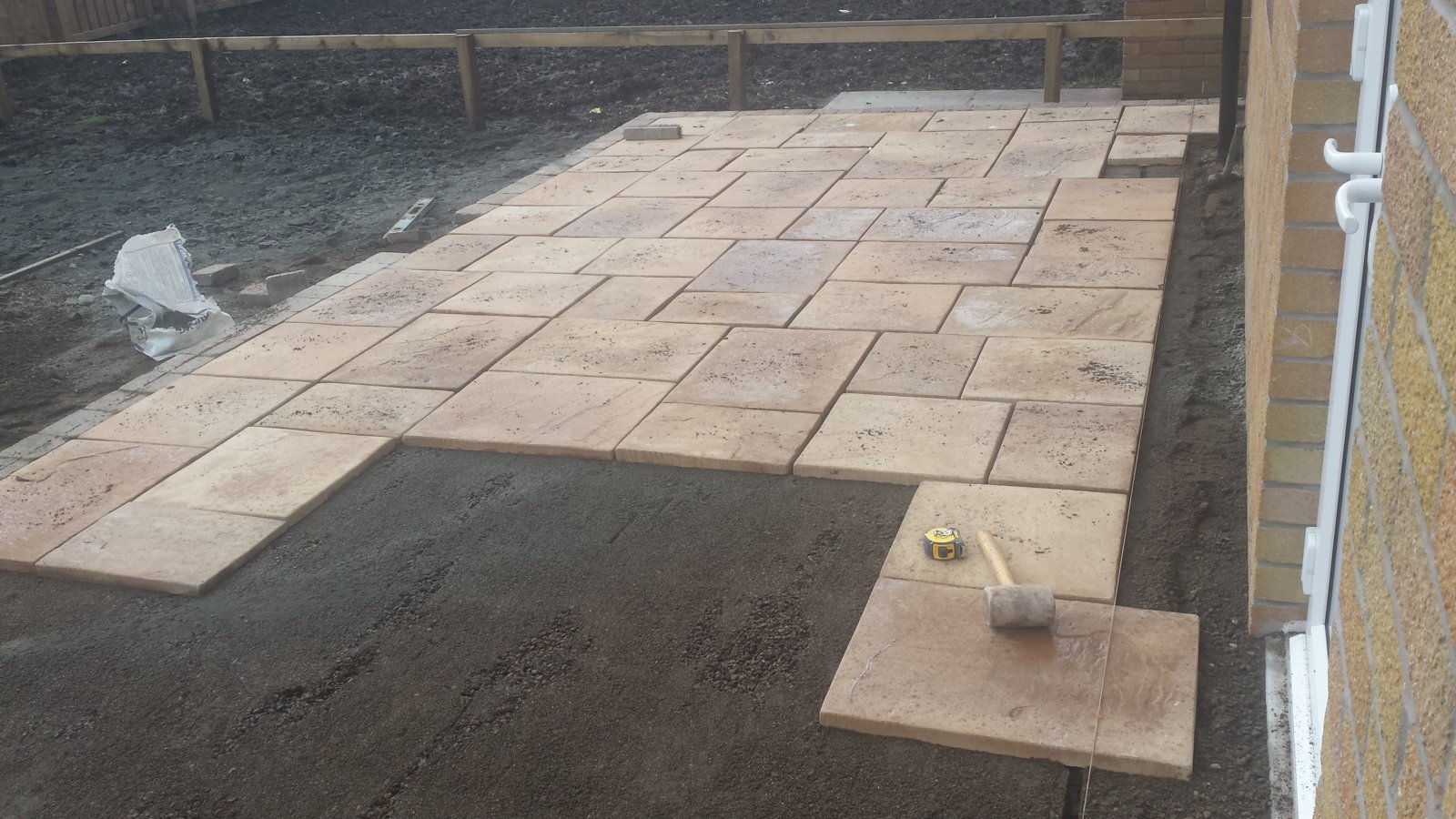

I have just finished building a small raised patio area.

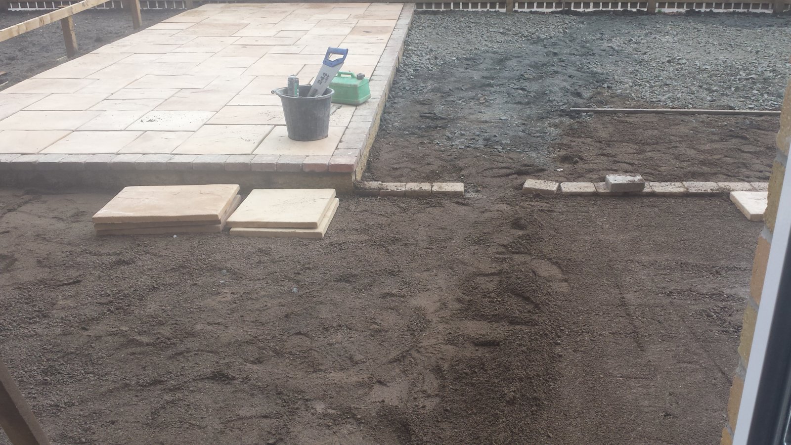

I was recommended by a handyman I know that I could lay a sand base and then just sprinkle some cement on before i laid each slab (400mm x 400mm) for stability.
We laid a base of hardcore and then just about 1cm of sand, flattened it and then sprinkled some cement powder on before laying the slabs.
However just realized that we have made a mistake insofar as we used builders sand rather than sharp sand for the base above the hardcore.
After some reading I can see this was obviously the wrong thing to do. What I want to know is if we need to take all the pavers up and relay or if it will likely be fine. Im hoping that because it was just a thin layer over hardcore it wont be a problem??
After reading through articles I can see we have clearly done it wrong so I am not trying to find out if this is a viable method. Just wondering if it will likely be okay or if it all needs redoing? Thanks
Building sand doesn't lock together like sharp sand so it's no good as a base
Your handyman is not wrong you can just lay slabs on a sand base or use a mortar mix
You could see how the patio fairs and leave it or
personally I would be lifting the slabs and starting again chances are you will have to do this in the future anyway
Don't kick yourself too much we all make mistakes - we're all human after all
I made the same mistake... It's been 4 years since done. Ground levelled with power compactor, weed fabric, 2 inches of sand compacted by hand then power compactor. Not moved in all that time even as use as motor cycle standing.
what I'm saying is how firm is the compacting of the sand to make the difference.
Thanks. Both of those are really useful, also just nice to hear that other folks make mistakes too. Its going to have a shed standing over about half of it so im tempted to just lift up the slabs infront of the shed that will be walked on.
Ill think about it over the weekend and then decide on a course of action on monday.
Sircerebus666 might be right though, might just add to my peace of mind to redo it all now.
Someone I know made the same mistake, slabs laid on soft sand.
He may aswell have laid the slabs on mud, they were all over the place, so he had to re-do it.
