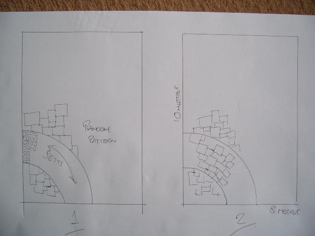

I need help to decide what paving pattern will be best in my back garden.
I want to use paving in a random pattern, and also break the pattern up with a half moon of cobble setts (100 x 100) as shown in diagram 1.
The cobbles must be exactly the same stone as the main paving flags that are to be used in the random pattern.
This is the problem; it's difficult to get 100 x 100 cobbles and paving flags made out of exactly the same stone.
My question;
Maybe I could build the half moon out of the same material as the main patio area, random pattern again but just shaping them as shown in diagram 2.
From a build point of view is this a nightmare?
Does anyone have any good ideas?
Many thanks.

not a nightmare from a build point of view, will just need setting out properly. What paving are you thinking of using? Indian sandstone paving setts 100 x 100 are obtainable to match indian sandstone paving
That's right, Sandstone. I noticed today that pavingexpert will provide a layout plan for about £50, is it worth it? Saves me getting it wrong.
Thanks.
in that case 100 x 100 setts can be obtained from most decent suppliers (proper paving suppliers, not builders merchants!) Up to you with the plan. Im used to laying it and would lay the setts first. The random pattern is easy once you get used to it.
...but do plan it out on paper first. If you buy a pallet load of stone slabs in a kit then you'll have no choice on the number of different sizes you get, hence the need to plan it carefully.
TBH I steer clear of random patterns these days - most customers think they are too "busy", especially with the detailing you are going to use. My advice would be to use a repeating two or three-size pattern for the rest. You are going to have a lot of cutting to do, too, around the curves. The good thing aboiut stone is that you can cut and grind it to shape without major problems. Just take your time with a good grinder.

I did wonder a large area of random flags may be too much.
I agree it needs to be planned carefully on paper before I start. I will get pavingexpert to design the layout, I've asked him for a quote. Maybe I can upload his layout so everyone can see if it's a useful service.
Thinking about it, you say you would lay a repeat pattern using 2 or 3 different sizes, could I use a repeat pattern using 4 different sizes?
