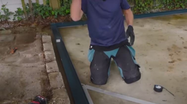

I want to build a small garden room, one of these:

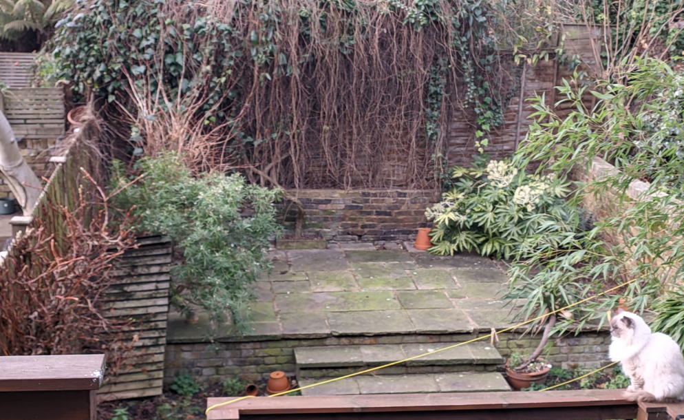

As it's made of large panels with tght tolerences, the base needs to be square and level. The spot I have for it is on a raised patio laid with York stone slabs. It's reasonably level, but not perfectly so. The base for the shed is a metal track that rests on foam strips. Ideally I would build it on a concrete slab but I want to leave the patio as it is, so the question is, how can I install the base on the slabs so that it is on a flat, level surface which will remain so? I was thinking of maybe making some shuttering around the base, and levelling inside it with self-levelling screed, would that work? Would it be removable in future?

Do you mean on top of the current paving? would that not damage it?
What about my shutters and pour idea? Would that work if I used a few inches of concrete and rebar laid on a DPM so that it could all be taken away in future?
I was thinking along the lines of taking up some of the paving and re-laying at a later date when the garden room is removed.
You would need need a DPM or something to protect the pavers before pouring on top of it.
You could use decking or similar for the shuttering.
