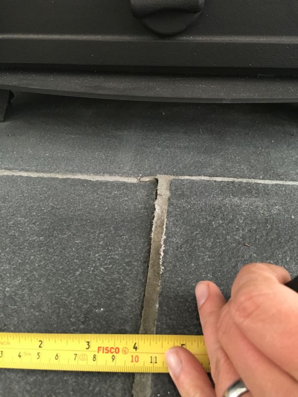

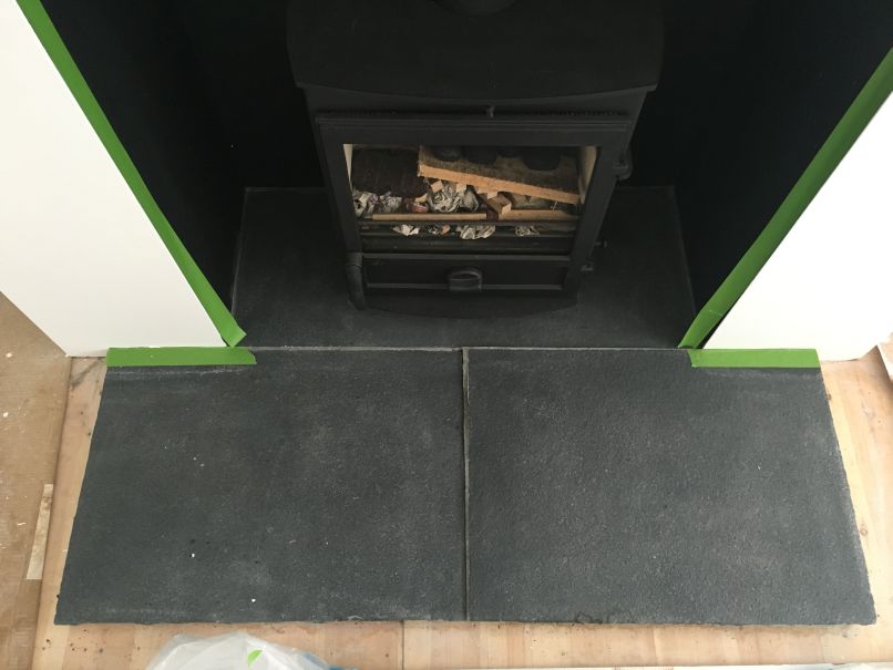

Basically in February we had a multi fuel stove fitted. The hearth is black limestone flags.
I've come to paint up the living room & so covered everything, including the hearth, obviously.

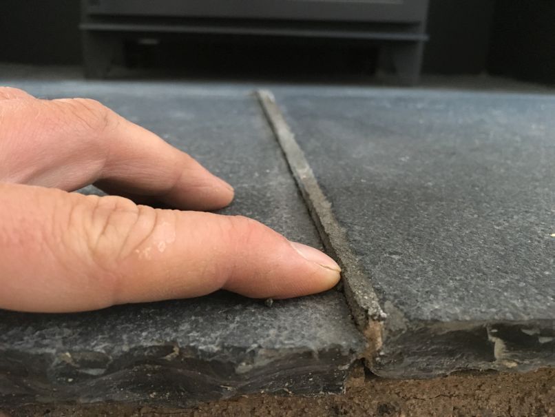

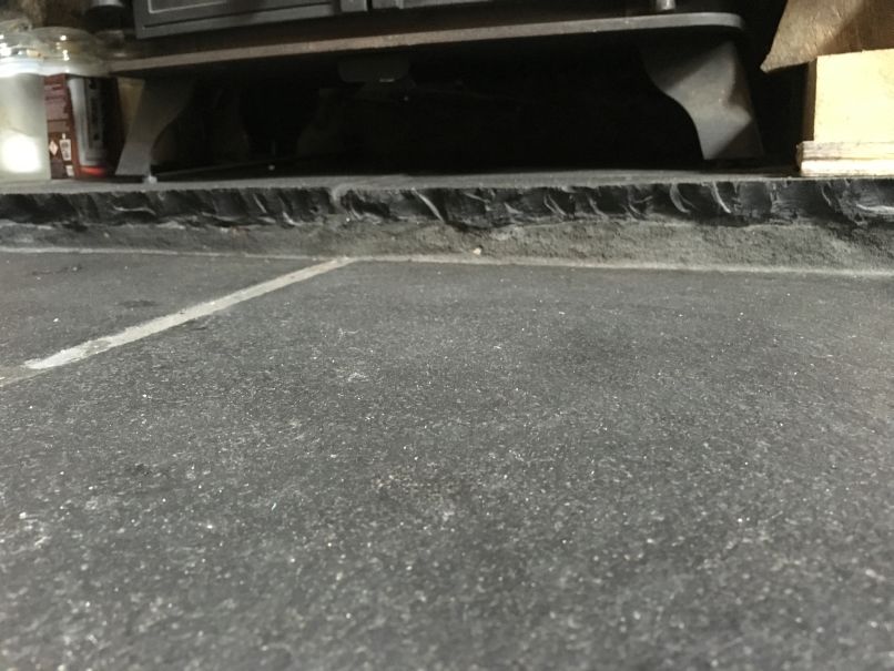

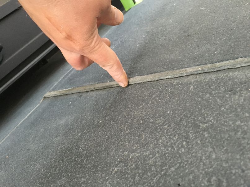

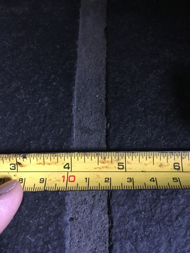

Now i don't know how it's happened. If I or my wife has ended up standing in a bad spot on the hearth but one of the flags has lifted...
If i stand back on it it doesn't go down any. If i stand on the face edge then it does seem to lift it a bit more.

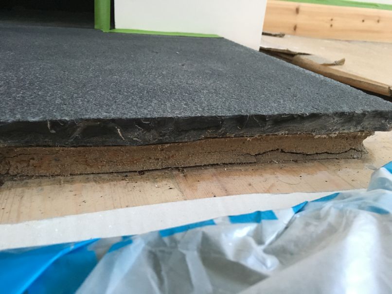

The bed underneath the left flag is quite solid, but underneath the lifted flag it's set, but doesn't feel rock solid like under the left side. Plus it's cracked more. Whether this has any negative effects I've no idea, i just thought i'd point it out.
I'm just wondering what they should be doing to put this right?
I'm guessing lift flag off, knock off all the cement on the underside & the joints to the left & rear flag.
As for the bed ... i've no idea.
And then somehow re-fit while aiming to get it level.
Is it literally as simple as that?
Like i say, it was fitted in February but the ends of the floorboards you can see are a little damp. Surely it shouldn't still be like that? I can understand it being damp to begin with due to the water in the cement mix, but 3 months on?
