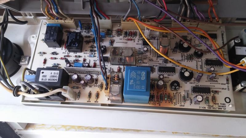

Glowworm compact 100e PCB. Can anyone tell me if the burnt area could be the reason why the hot water is only luke warm? Everything else is working fine.
That scorched area is the power supply components over heating, Happens on a lot of boiler PCBs. Most unlikely to be the reason the hot water is only warm.
Happens because the designers seem to forget the ambient temperature around the PCB is hotter than that of a room and yet they chose components suitable only for operation at room temperature or below.

I think thats just normal discolouration as a result of running hot.
The luke warm water may be a result of incorrect gas settings or sludged up water components etc.

While that cover is off,you could check that when you rotate the front thermostat knob for hot water,the corresponding black pod center insert also turns at the same time.
:idea: :idea: Try the heating thermostat knob first,this will show you what travel on black pod center to expect.
This is to test for broken spindle syndrome.
I'd be checking for dry joints under the burnt areas of the PCB whilst it's out. (power = off), not that it has anything to do with the problem but because it's likely.
Ignore all the other advice, this is the part of the PCB that controls the gas valve and will be the cause of your poor hot water.

It's not the only reason why is hot water is poor, if you want to jump in feet first and buy a PCB then crack on. It's an expensive guess, most people would fault find first.
Pay attention to the solder on the pins of the cable connectors. These joints have to absorb the mechanical vibrations in the cable loom ( fan, flame turbulence etc etc ) and are going to be the first to fail. They fail with a circular crack in the solder all around the pin.

I would doubt that its a PCB fault in this case, although of course it always might be.

I've had this on our Compact 80. The fault was on the PCB. If you look at the PCB, the area to the right hand side of the transformer is discoloured, where components have got warm over time. There is an electrolytic capacitor which dries out, C105. I changed this and got another 2 years out of the PCB before the transformer TR100 then failed. Pity there are no circuit diagrams on the net, it would make fault finding on the PCB easier. We also had to restrict the flow of the hot tap to get hot water out of the boiler, and the pressure was down at 10, not 15.

I've had this PCB fault so many times now I don't even bother trying to diagnose it apart from a) check burner pressure b) replace PCB when adjusting the gas valve higher doesn't work. The scorch marks are the tell tale sign.
As mentioned though, it is not a DIY job as the new PCB is not set to any kind of factory setting and needs adjustment (it fits several different "Compact" models, both combi and system boiler).
