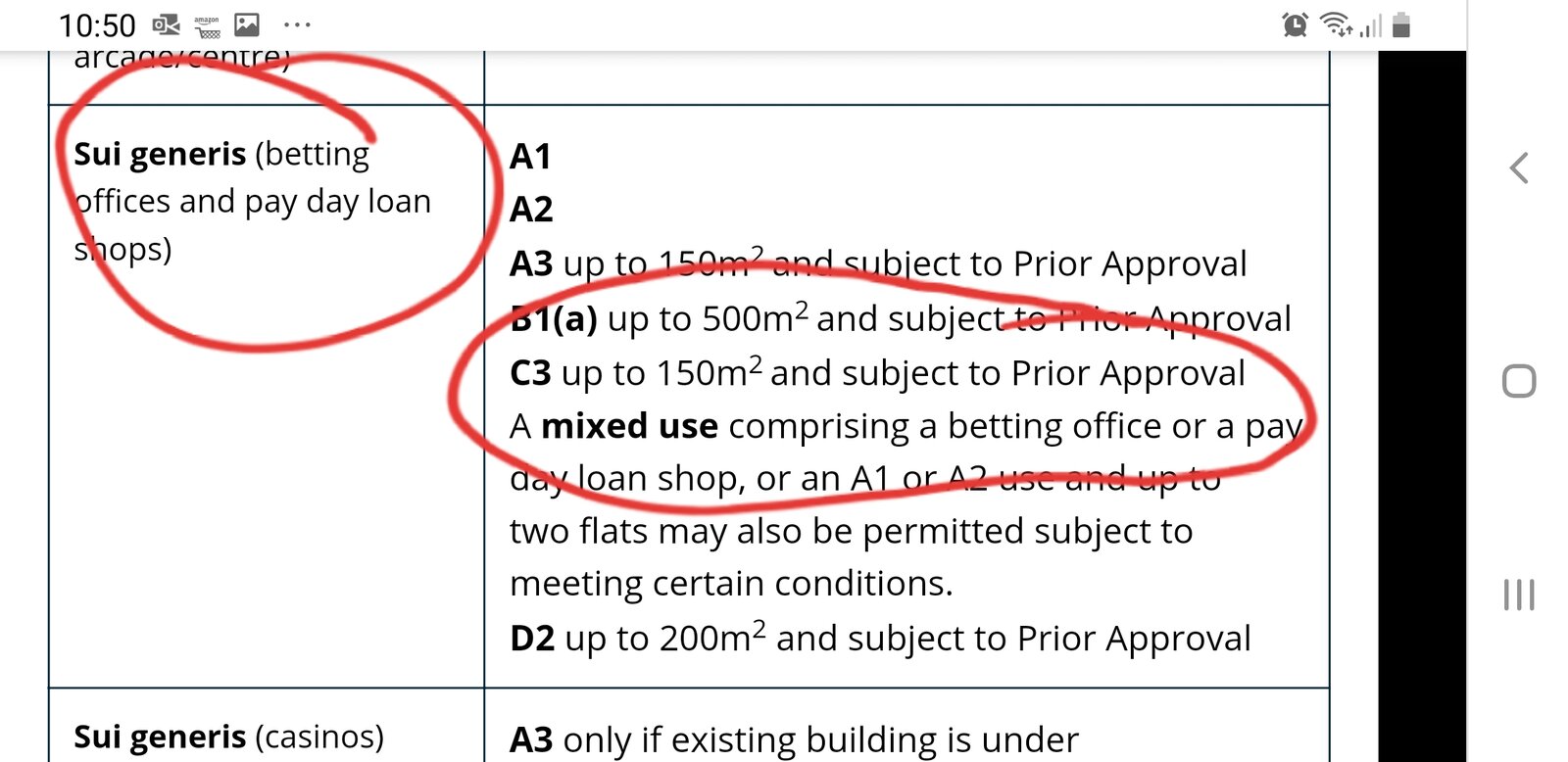

I'm looking at trying to use PD rights to change the use of a betting shop to a flat.
Probably won't get it but as the chance of finding a new commercial tenant in a tertiary parade given the current climate is highly unlikely it's worth a punt.
It's 65 m2 internally so a 2 bed flat would be fine. However if I could extend (which all the other shops have done) I might be able to get 2 x one bed flats.
However the architects I have had initial chats with say that you can't use PD rights for change of use if the plans include extending the property.
Is this correct? Is there any way around this?

Hi Woody
I understand that PD when in respect to residential extensions means no permission needs to be sought.
However my (limited) understanding of PD with respect to change of use is that it's a different kettle of fish.
The Planning Portal says that you can have a change of use from betting shop to C3 but with 'prior approval'

Hi
If I wanted to extend to allow more space given it's a commercial premises I understand that it will need PP. So which way around would you do things?
1) Apply for PP for the extension and once that is granted then apply for change of use based on the proposed increased foot print?
2) Or would you apply for change of use based on the current footprint, and if that was granted then apply for the extension? ie once change of use was established in principle then we could adjust it to include the new proposed extension (once granted)
Hope that makes sense!!
Operational development (under the relevant PD class) must not result in any increase in the building's external dimensions, so I guess you have to extend first, and change use after. If it was me, I'd seek professional advice from a planning lawyer before proceeding.
