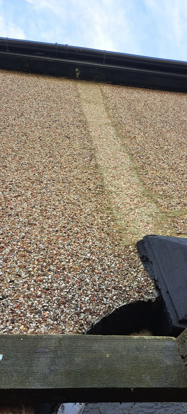

Can anyone advise me on this. I have had a long section of pebble dashing fixed on the outside of an older terraced house. More than happy with they way the wall has been fixed behind and no it was professionally done.
However, not really sure about the finish? I know it is difficult to blend in but there seems too much cement and not enough pebble dashing?
Am I over reacting or will it all be okay?

Could have been applied thicker but a repair like that will always stick out like a sore thumb unless all is painted over
