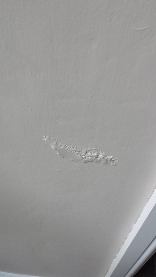

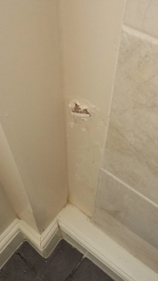

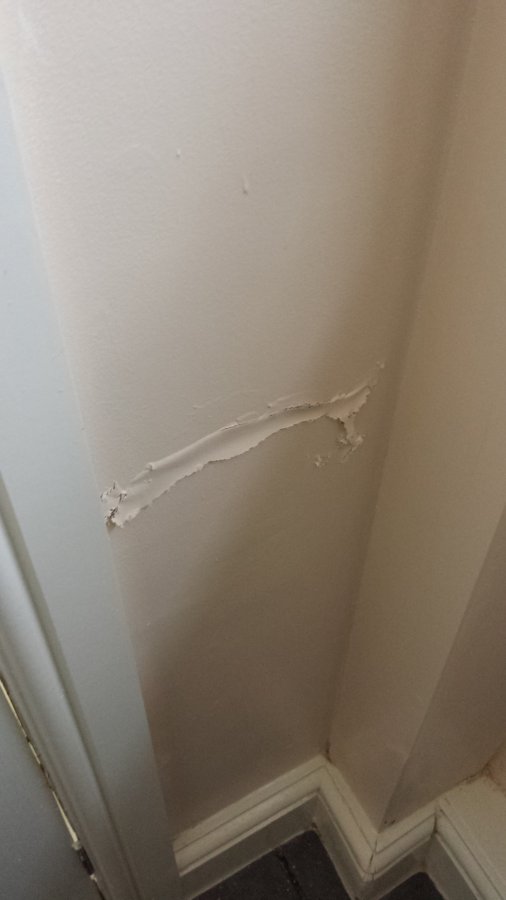

I am looking for some advice please from some of you guys with more experience than me.
I am having a re occurring problem with an internal wall. The wall was re plastered about a year ago, having previously had damp issues from a leaking roof. I have had problems with the paint peeling in the same area. I primed it with PVA and once dry gloss undercoat.
I don't think the area is damp as there is no sign or staining. I am wondering if salts or efervecence from the old brick underneath is the problem. I believe that a alkali resistant primer should be used if this is the case.
Any advice, comment or recommended product would be very much appreciated.
