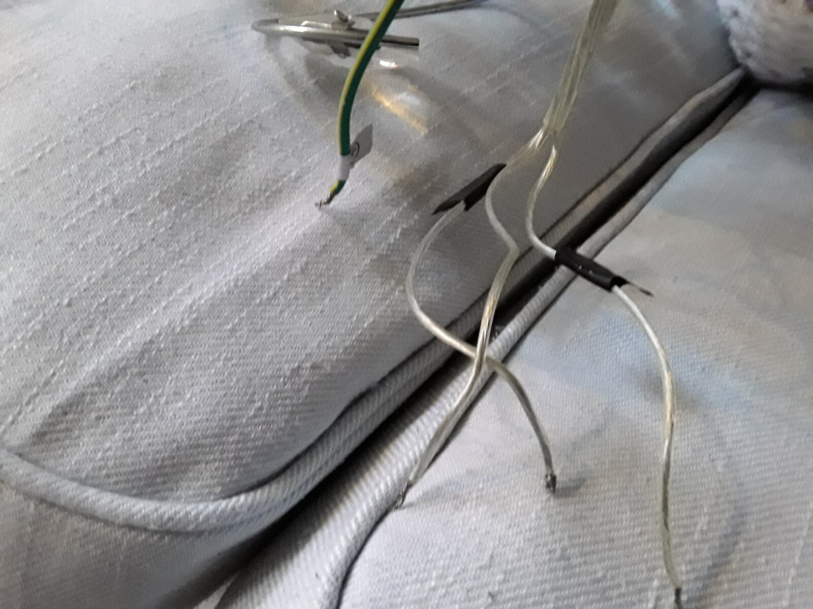

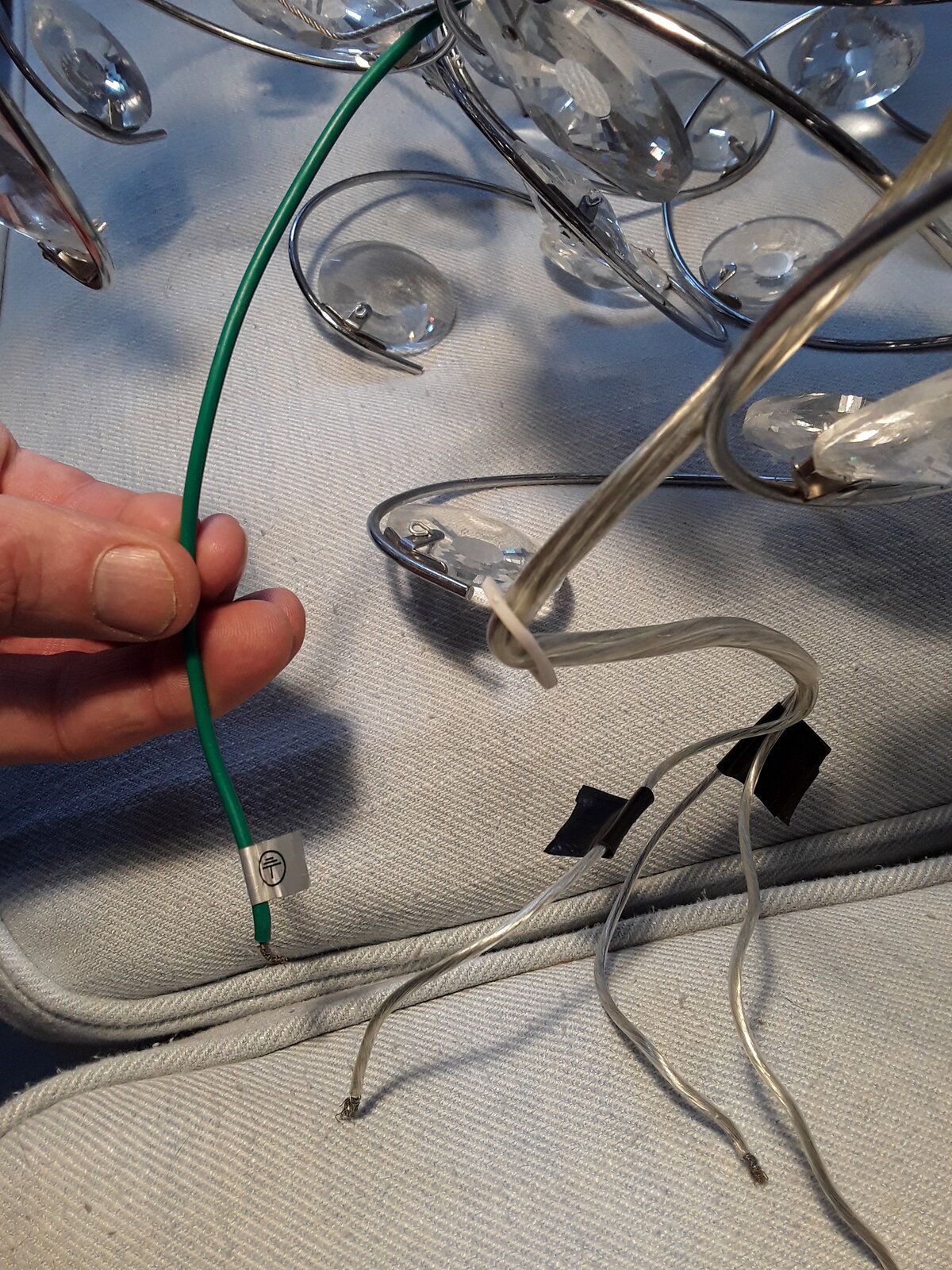

Hi all my plasterer removed my pendant light to board the ceiling and I am unsure which way it goes, I had an electrician fit it when i moved in. I have uploaded 2 pictures showing the cables I have got on the light fitting and the pendant. Please can anyone advise me

Can you show a picture of the wiring at the ceiling ?
Do any of the light fittings wires have a very thin coloured line ?
Ask your plasterer for the photo he took before removing it. Failing that ask him to put it back as part of the job I hope you haven't yet paid him for.
Ask him why he put tape on two of the wires. These may be the L&N connections. But needs confirming before power is applied!
