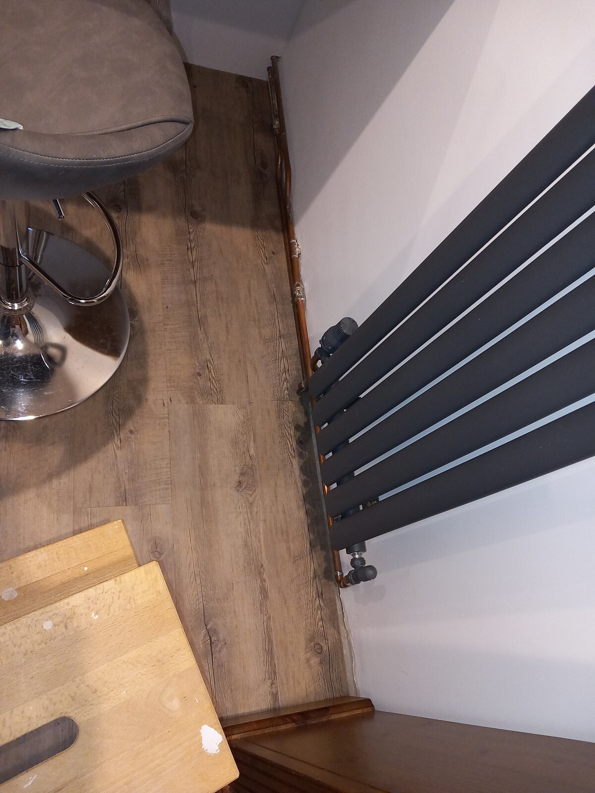

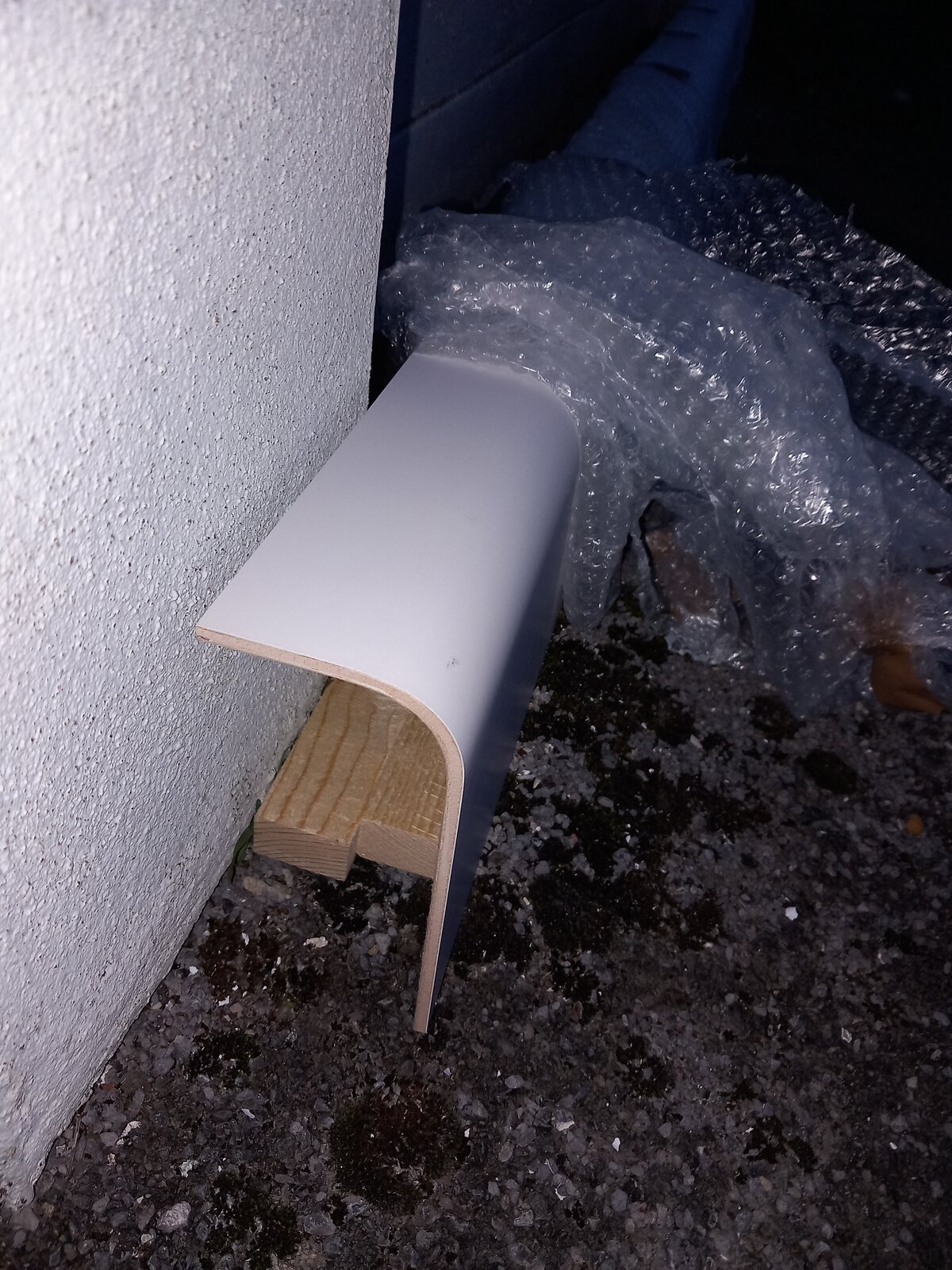

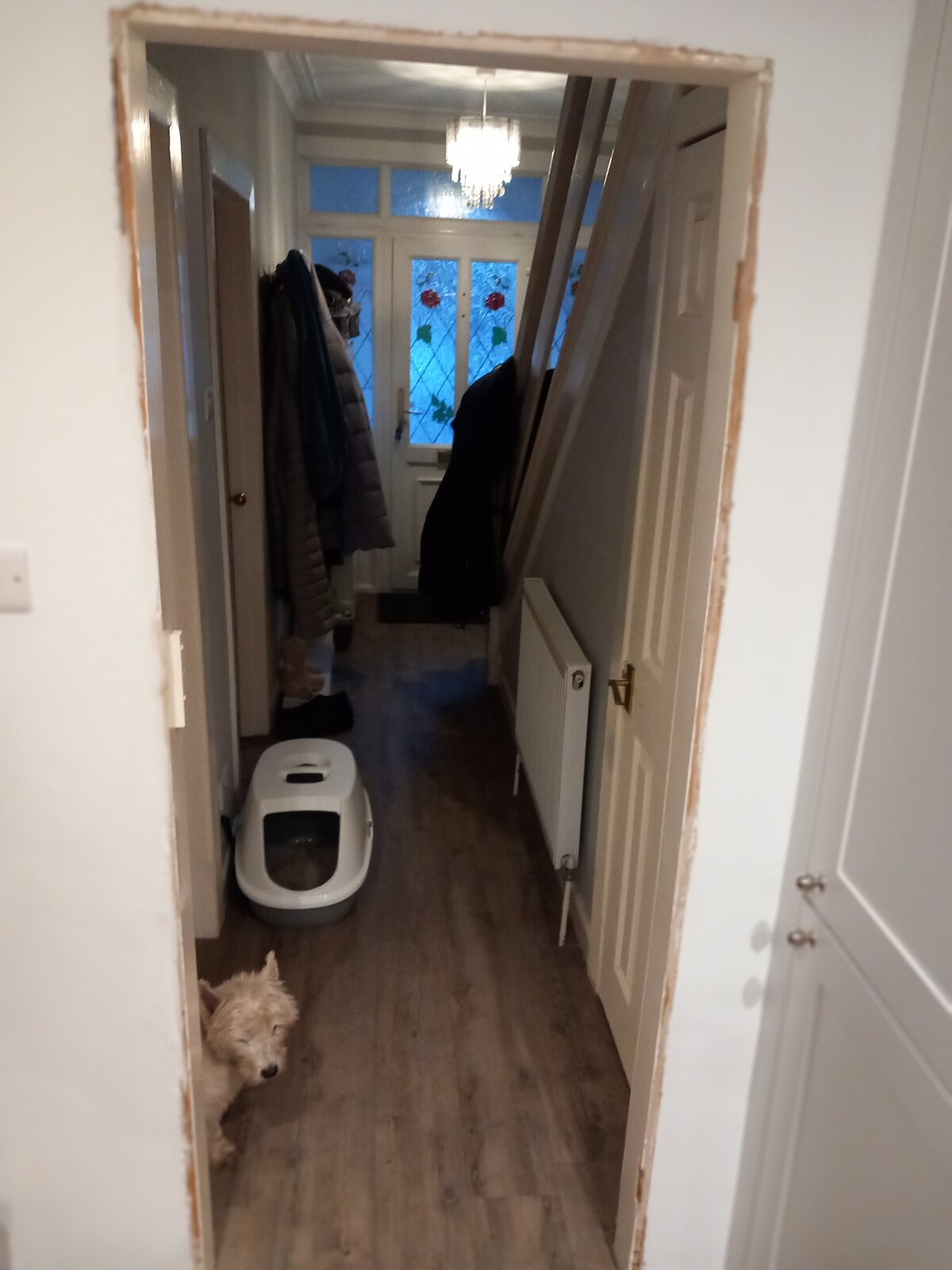

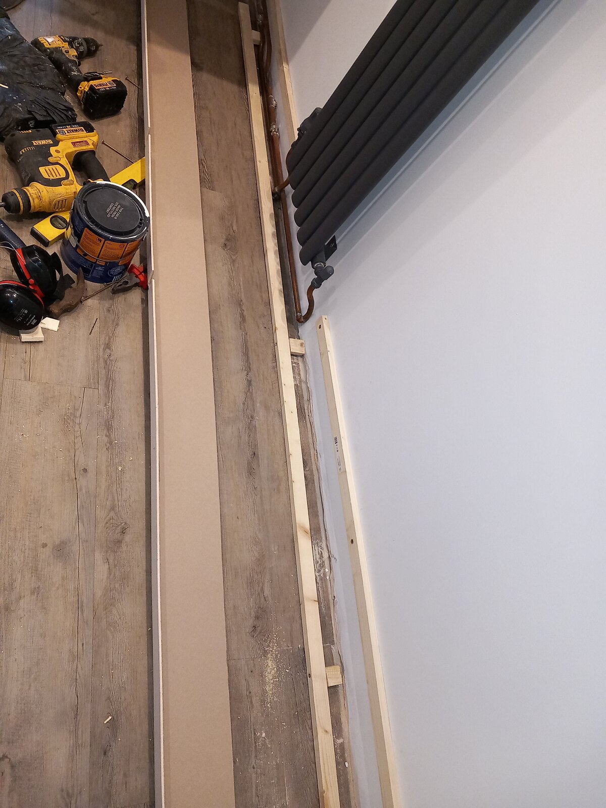

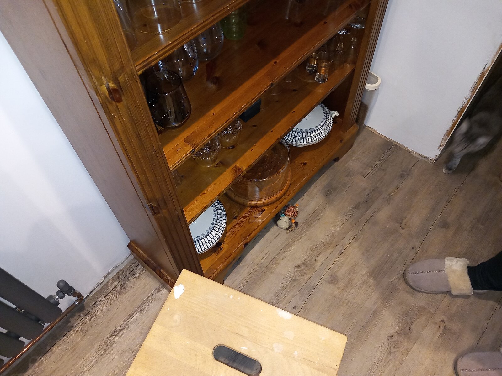

Got some radiator pipes (100mm high 30mm wide)I need to box in so was gonna use pendock. (Used once before) 150mm high and 70mm wide. Glue baton floor and plug and screw into wall. Run the pendock an extra metre behind book case to end of wall them run bullnose skirting from there.
Got some mdf beading which needs replacing (used to cover the expansion points of laminate). Shall I pin and glue or just pin and us it too small for shop saw? Use a mitre mate?
gonna use smaller architrave (not stuff currently used).

You say that you've already installed Pendock - so you should know what you are doing with it. You should also know, as a tradesman, that you never install anything by fixing it to laminate flooring. So you need to either trim back the laminate (which I happen to think is inadvisable, or you need to fix the Pendock back to the wall so that it doesn't depend on being fixed to the laminate, or you need to find anothet solution.

Actually I'm pretty sure it's vinyl not laminate (apologies)that should be ok to glue baton to for pendock?
Also, got some architrave but it's 69mm in width I couldn't find the usual 50mm stuff, is this a bit wide?
You shouldn't use adhesives on vinyl - any solvent may attack and degrade the vinyl, particularly domestic quality vinyl which is a lot softer than industrial/commercial quality vinyl. You will need to get some form of mechanical fix into the sub floor beneath the vinyl (screws screws and plugs, etc depending on what the make up is)

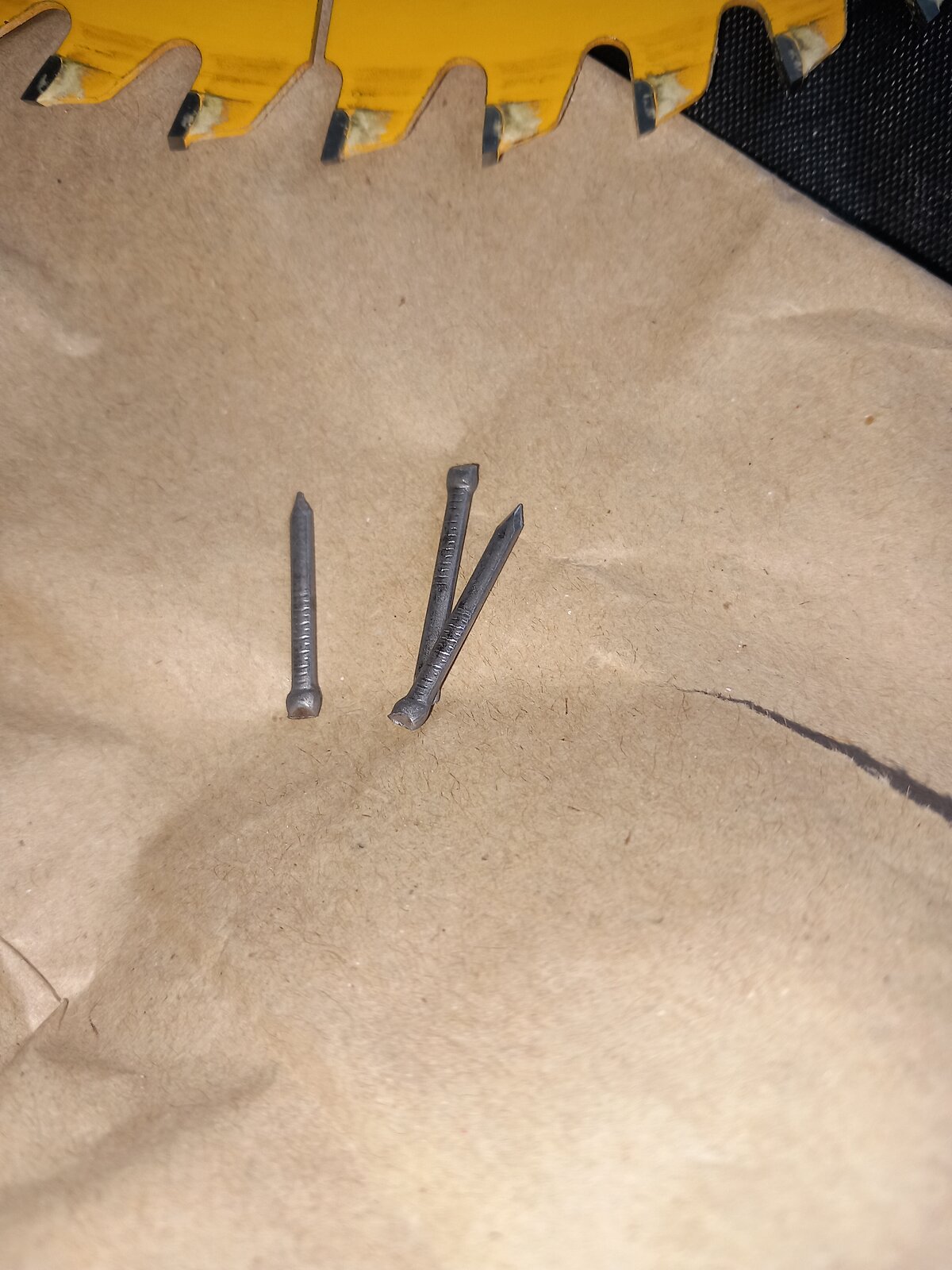

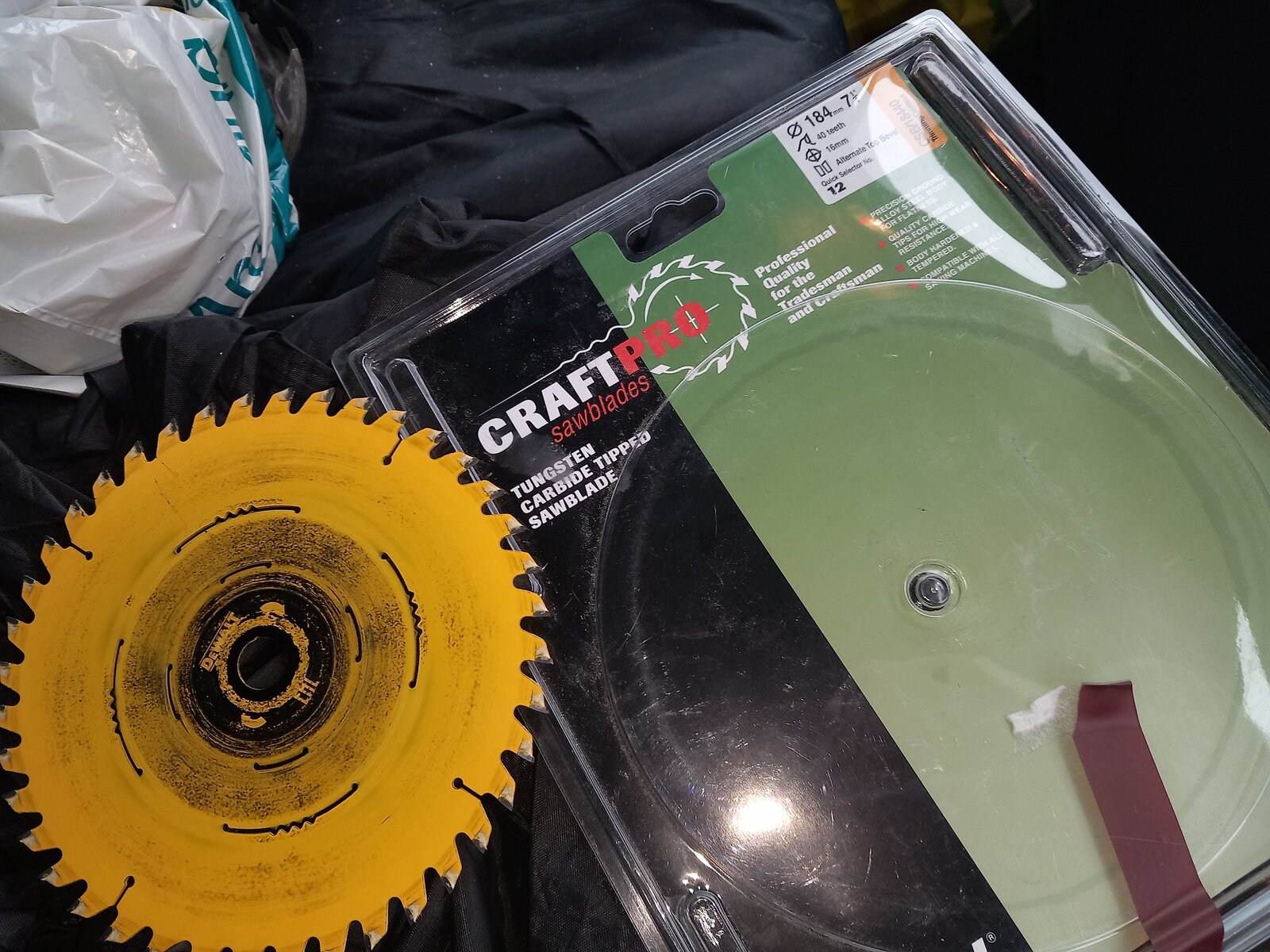

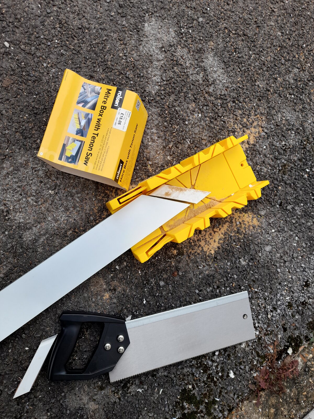

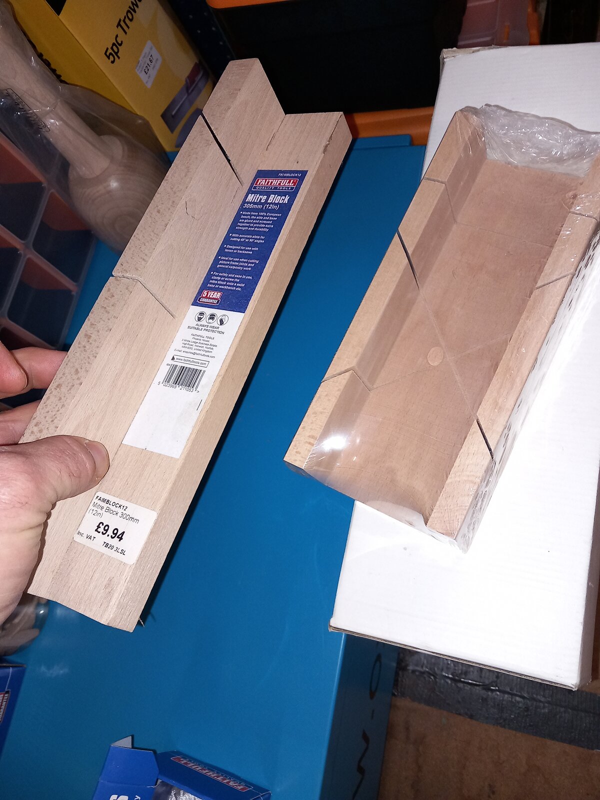

Is it better to use a mitre box for cutting beading or even skirting or architrave than mitre saw? I bought the plastic one , is wooden one better? Also put a finer blade on mitre saw. Nightmare to do got engineer in shop to do it. Couldn't find the 18 or 24 gauge nails the lost head nails just come in 20mm or longer. 20mm too short for beading?
"Manual" nails just don't come in gauges like machine pinners use. In terms of thickness they go veneer pins, panel pins, small nails. With small beading you can pilot drill for panel pins, etc - same with ovals. Remember to blunt the tips on the cheek of your hammer to reduce the tendency to split the beading. How big is your beading?
A power mitre saw can be set up to cut small stuff, but apart from a fine tooth blade you also need to support it below and to the rear with an auxillliary base and fence - basically two pieces of 3 x 1in or 2 x 1in planed softwood glued up to form an L-shape - NO SCREWS, NAILS OR PINS BECAUSE THEY CAN DAMAGE SAW BLADES. Can be held in place on the saw with double sided tape. This is sacrificial, so don't worry about cutting into it

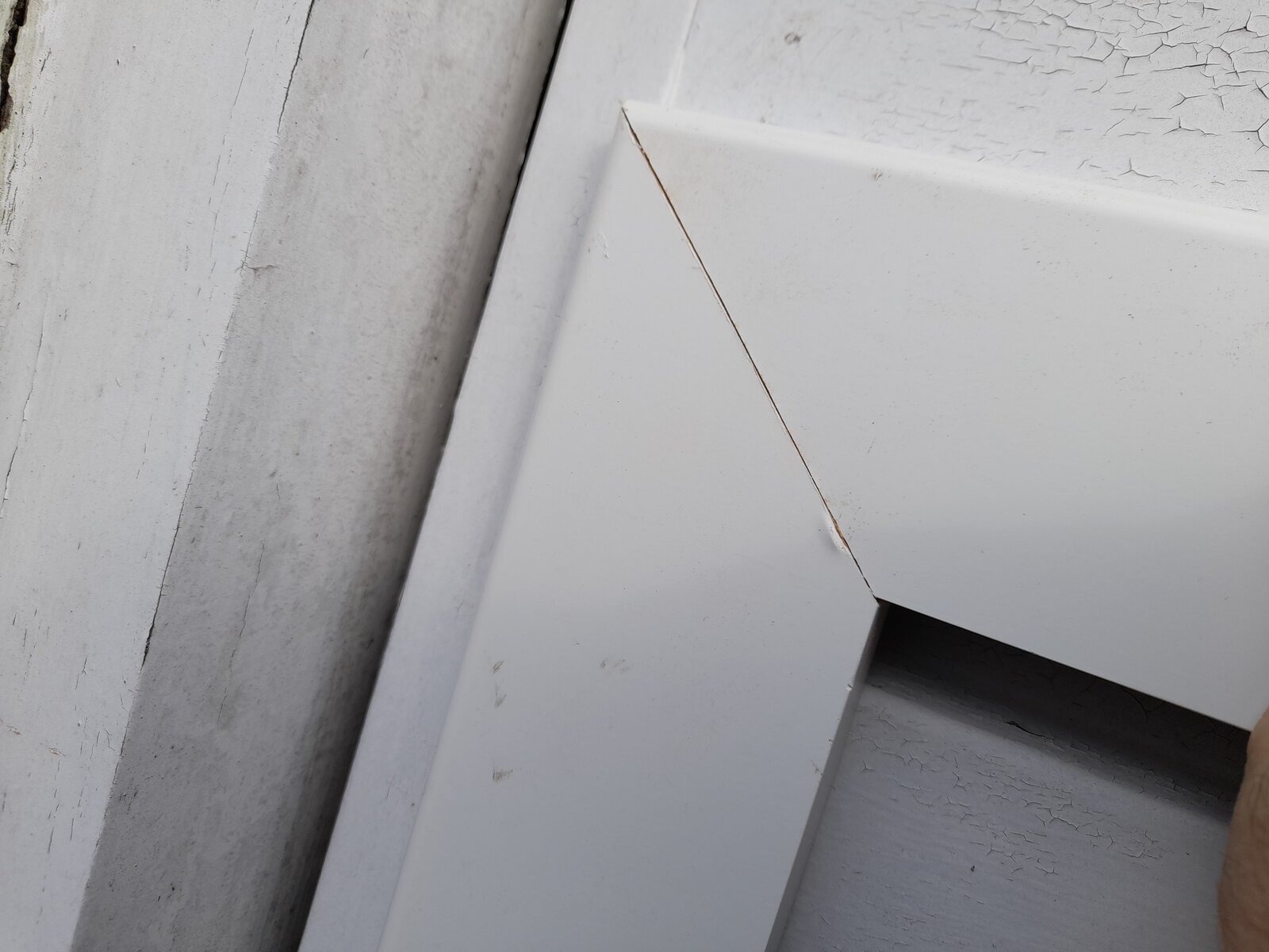

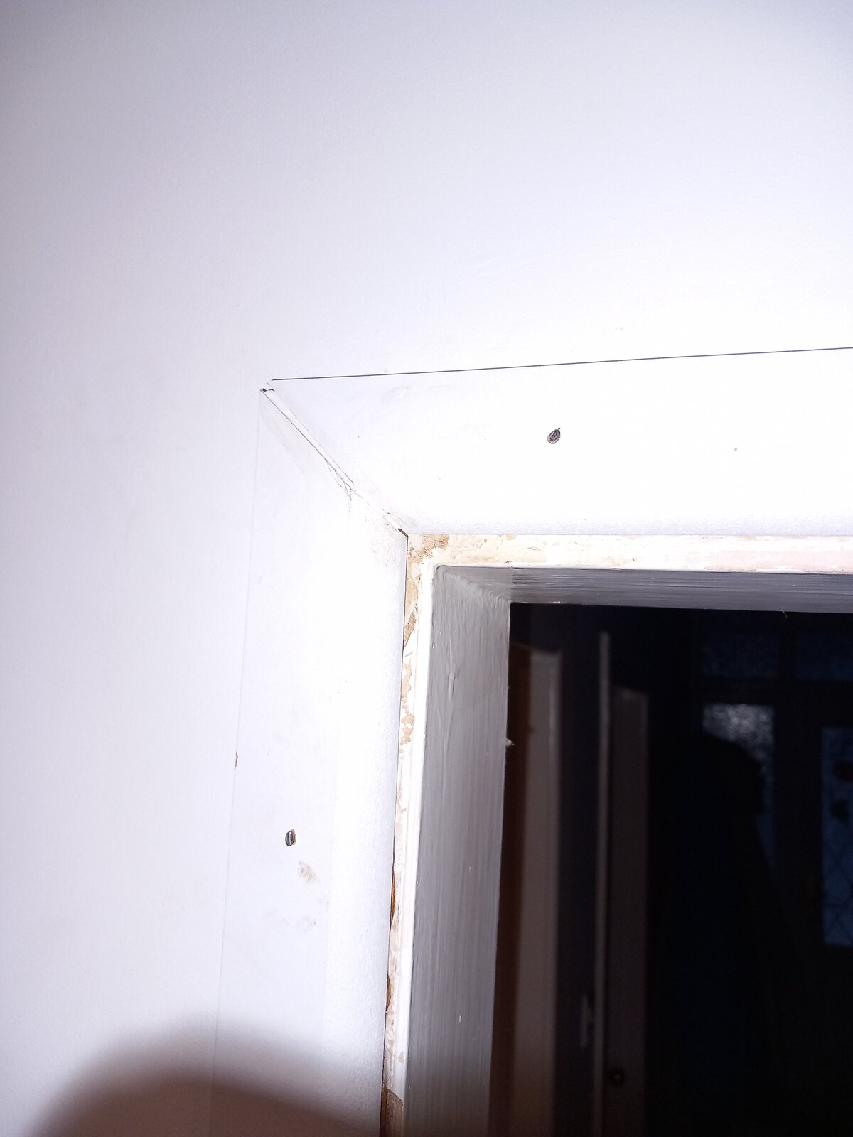

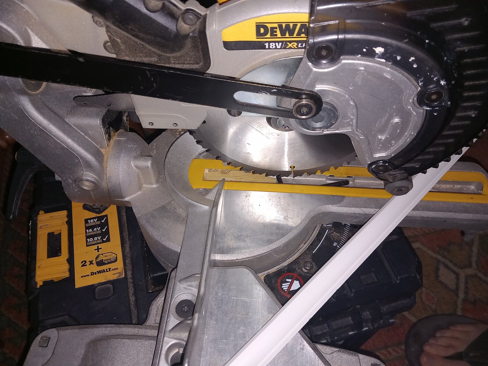

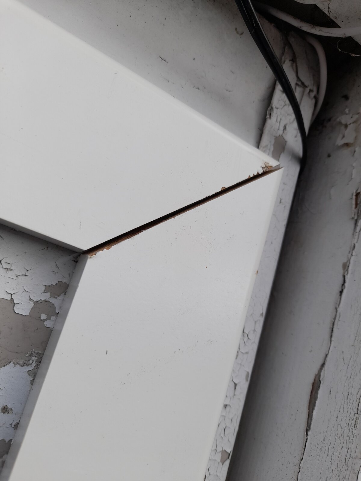

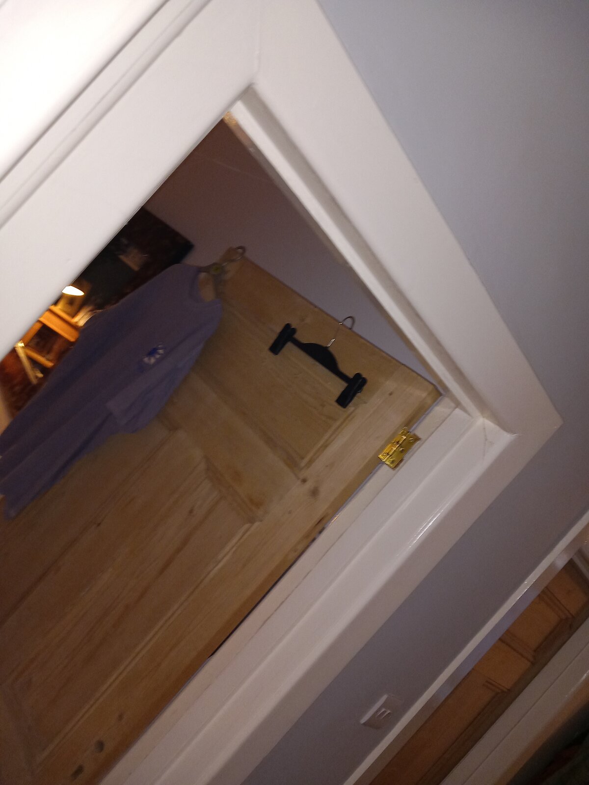

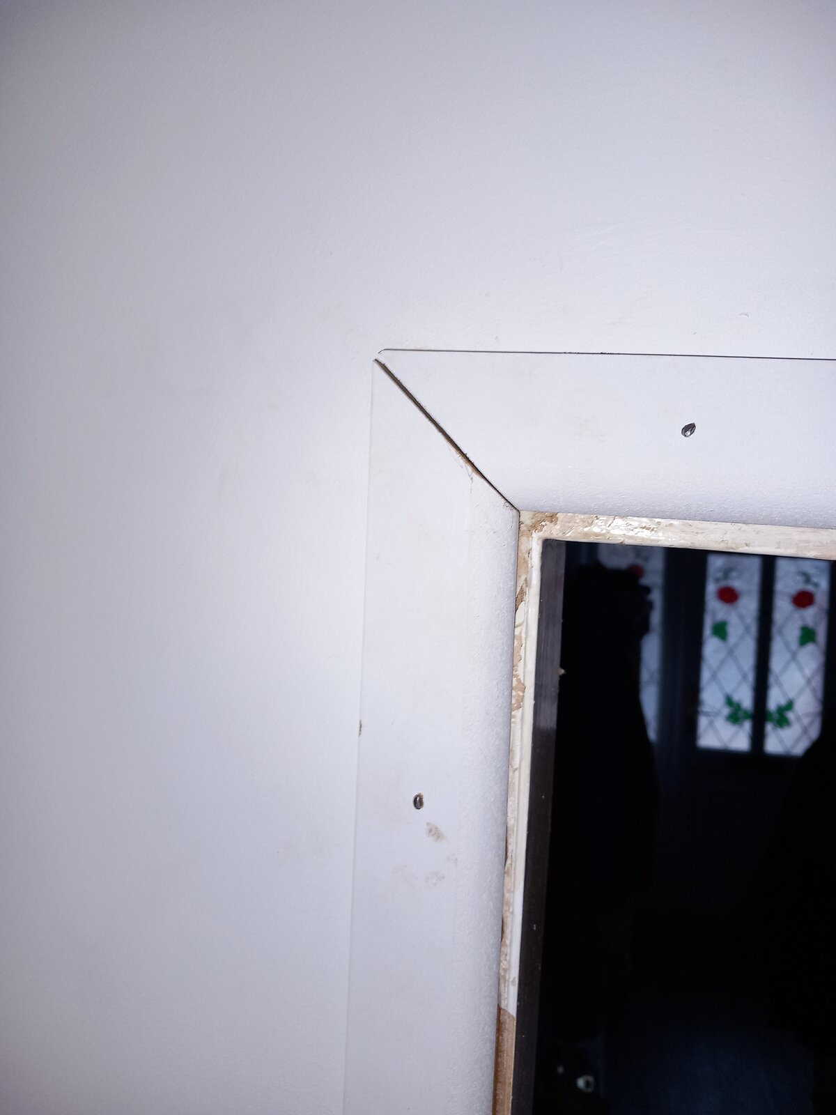

Look how good my architrave cut is with mitre box compared to one with chopsaw(big gap). Chopsaw must have something wrong with it. How do you cut skirting in mitre box? I tried (in pix but not successful) too narrow to lay flat.
Then you need to recalibrate your mitre saw. I seen to recall telling someone (maybe even you?) how to do this a while back on this very forum...
You might also like to know that I've done 3 short projects since September where I needed to produce nice tight architrave corners and outside mitres on skirtings (gaps = a pull). I did so using my 12 year old deWalt 216mm mitre saw on bevel cut (i.e head canted over) which is checked for accuracy from time to time, and adjusted as necessary. There were no complaints about my mitres...
For skirting with a manual mitre box you'd probably need to look for the Emir-style skirting mitre box which allows you to feed the material through the box and where the saw can be canted over to make the cut (or the cut can be made vertically). With bigger stuff you might still have to make adjustments to the joint face with a block plane to overcome cupping, etc
Here is the Emir style mitre box I was talking about. They are used with a panel saw (30 yo 24in/500 to 600mm long). It should be possible to make one of these yourself. In fact, you might have to as Emir (Emmerich-Berlon Ltd, I believe) have now stopped making wooden tools altogerher

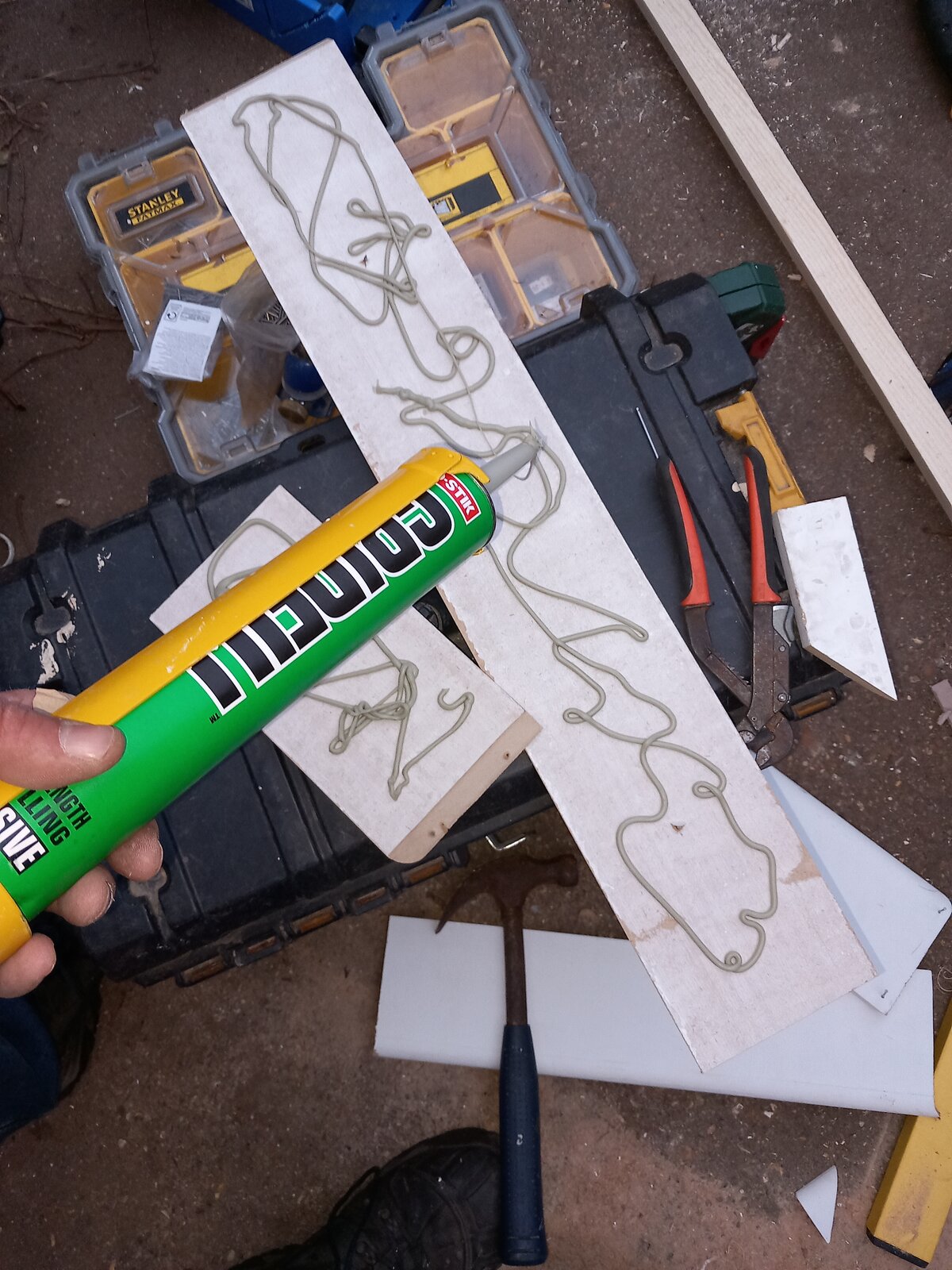

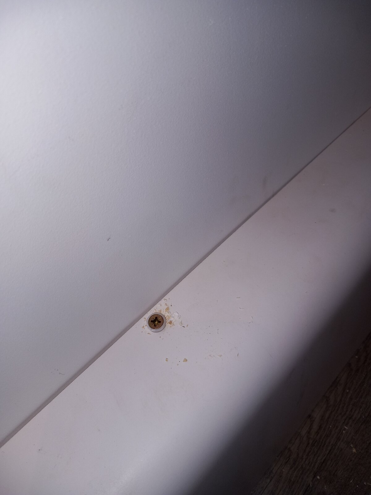

Decided to neither screw through vinyl or glue baton to vinyl but to screw baton on floor to wall then next piece of into that and bottom of penfock into that. Pendock is only 75mm wide.
Won't damage vinyl then or go through a kitchen pipe under floor

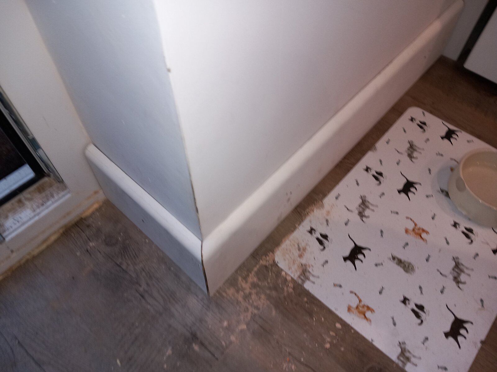

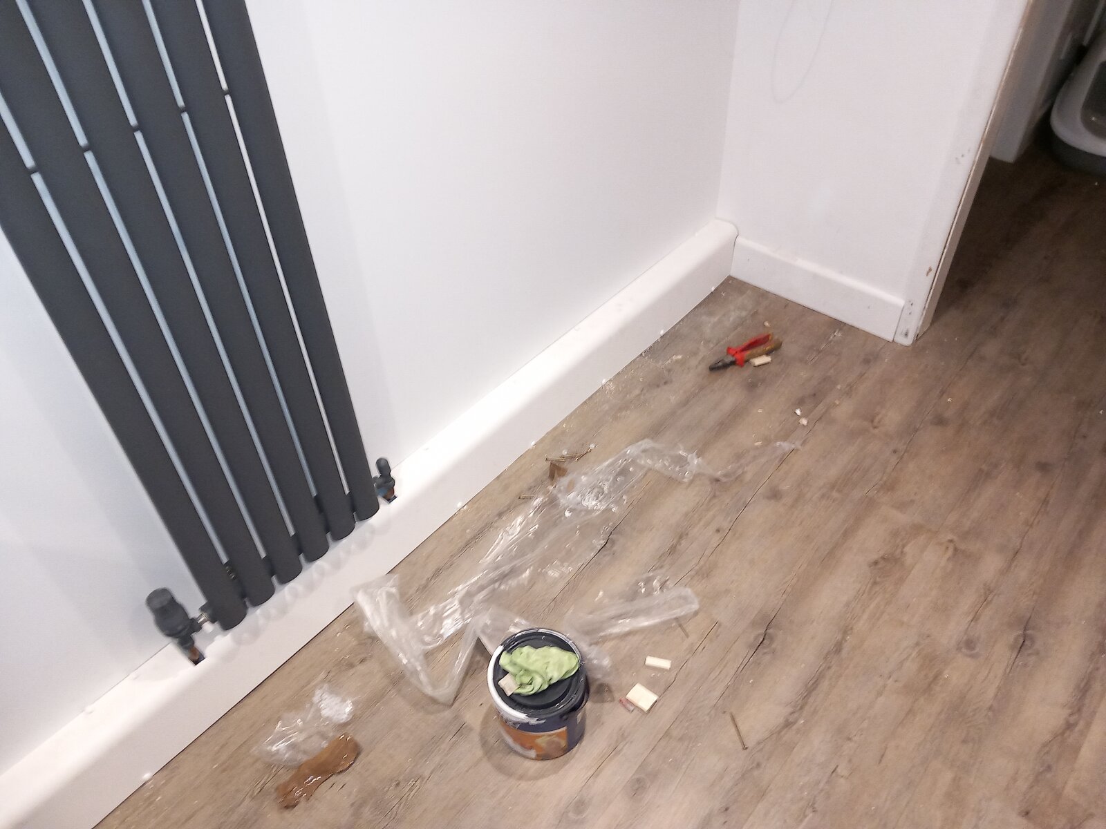

Did the job but customer wants pendock removed as it's too big and doesn't like plastic screw caps on top. Will remove it and run skirting from wall to start of radiator. Leave pipes visible. I screwed in at
an angle to not rub drill on wall.

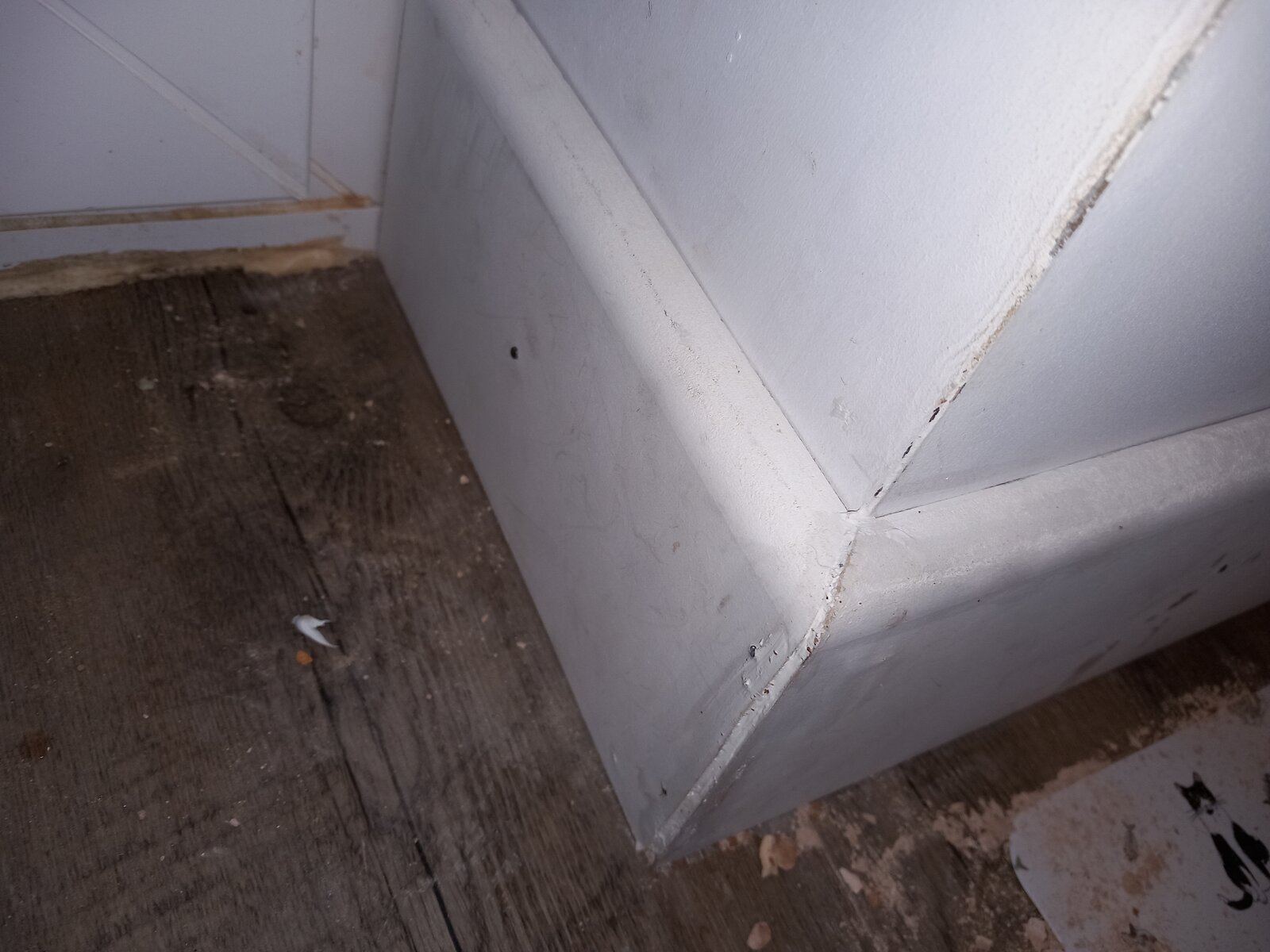

Had mitre saw calibrated but one side of architrave still not great and external corner of skirting wasn't perfect used two 30mm
lost heads on them. Caulked it up.
