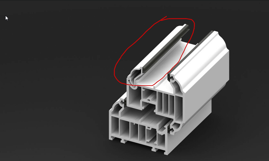

I purchased, measurements all good (used Gatortape) BUT The brackets that are meant to slide under the rubber gasket on the internal beads and the glass has damaged my seals
I have a eurocell windows and doors. The beading used is (image attached)

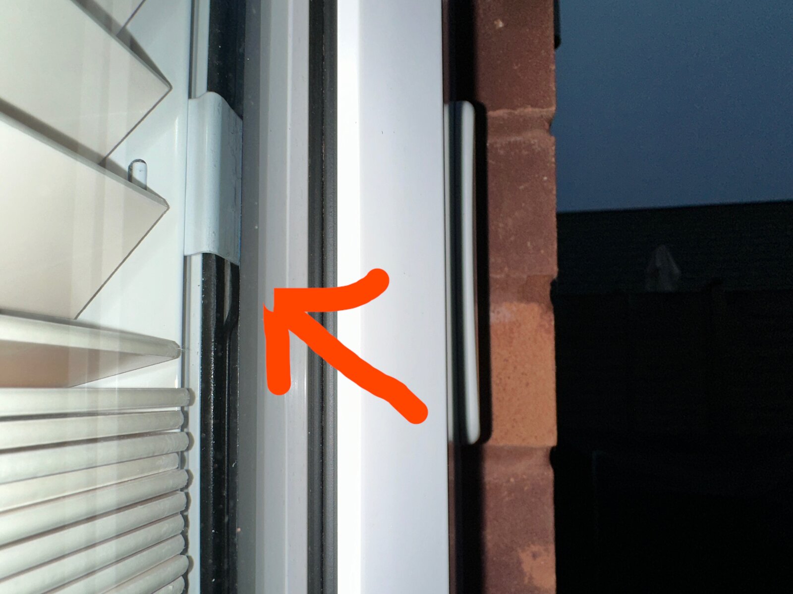

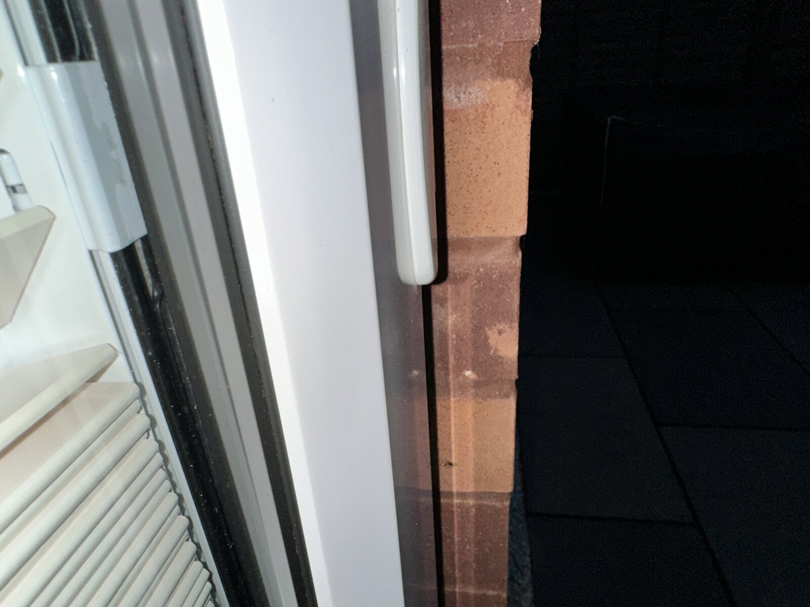

The rubber gasket has two "lips" the first lip the bracket passed through no problem with a bit of fairy liquid... and I used slightly more force to push through not realising the bracket was catching the 2nd "lip" and as this lip sits more proud, then when the bead was fitted this 2nd lip curled forward pressed hard against the glass...
Thus there is no way to push that bracket through for the perfect fit blinds without catching that 2nd lip and essentially tearing it and pushing it back as showin in the pics...
I cannot imagine I am the only person with this and to be fair its not obvious to spot at all... you have to look from out side in and at an angle which I doubt most people dont look at ?
Will this cause me issues ? i.e. do I need to replace the beading (I can do myself but the beading I need totals up to £120) but then if I replace the beading then I will back in the same spot ?
