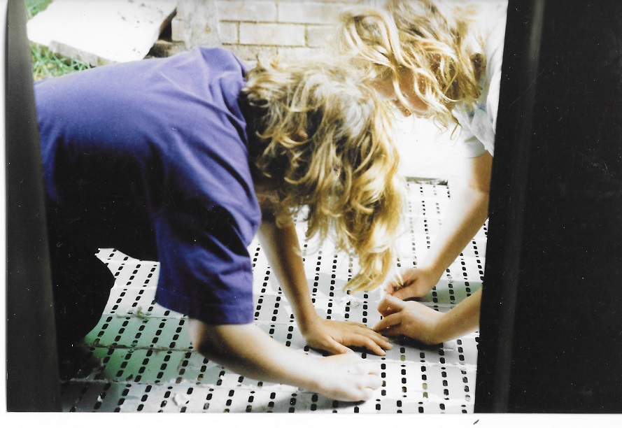

I am building some stairs made with steel stringers and wood plank treads At the top there is a small platform before you step up to the landing. I want to use perforated steel instead of wood for that area.
It is only 700 x 750mm with two steel supports each 150mm wide under them but it needs to be strong enough to take an adult's weight.
I have tried an old 2mm thick scrap piece I found but it bows in the centre with any weight on it so what thickness would anyone recommend ? It will be bolted into the stringers in 6 places, 3 either side with only 330mm unsupported in the centre
Stainless steel perforated cable tray.
I used it to make a 3 foot long bridge from a back door ( suspended floor ) to banked earth garden.

You could use 3X9 inch trays welded together, much strong than a single span.
It was bought from Electrix and similar to THIS
I cannot find the exact match in the current Electrix catalog. The folded sides of the tray make it rigid and thus able to carry heavy loads without bending.
Thickness is 1.2 mm.

Thickness is mostly irrelevant - a flat plate will always bend easily.
The solution is to have the sides bent down at 90 degrees, similar to the tray.

From memories of installing big armoured cables and lots of cable tray, in a previous life - there were two general types of galv electrical tray, the really lightweight stuff, the tray suggested above, then there was a much heavier duty version which had a doubled fold to the edge. So instead of just the edge folded at 90 deg at each side, it would be folded at 90, plus have a second fold back down. Rather like an upside down U, rolled edge.
It was strong enough to support multiple very large, heavy armoured cables and certainly strong enough to walk on.
The holes were punched from the top ( for cable use ) and this left slight burrs on the underside. Used in the bridge the underside was the upper surface that people walked on. Te burrs provided enough "grip" that even when wet the surface was non slip/
I am going down the fabricators to have a chat and look for off cuts. I now reckon,from what I have been told, as there is only 300mm unsupported between two 200mm supports a thicker sheet than 1mm, 3 or 4mm maybe, should be able to take the weight if it is bolted into the supports in at least three places either side or in some sort of frame which could strengthen it further.
