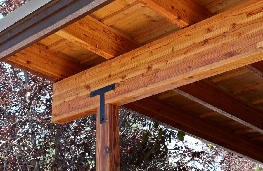

Search glulam beams be a lot lighter than oak but they will need some kind of treatment
Like these
