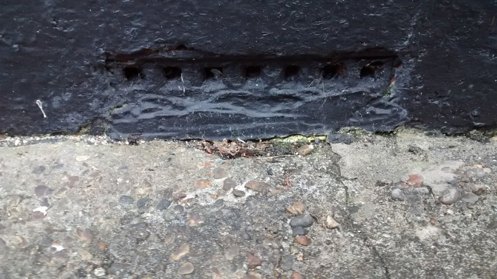

I am going to lower the ground outside to make a channel and make a couple of extra air bricks (mine were covered with concrete and painted over and closed off).

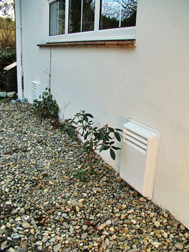

I've currently got old brick airbricks (clue in the name I guess!) but and think all mine are clogged up on the inside (2 I've checked in the room I have removed the flooring are), so might remove all, clear out the void, and replace with plastic ones - these help keep the rain water a bit.

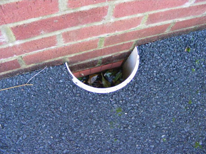

yeah, my neighbour has similar. I'd just want to put a little roof on it to stop direct rainfall. So, is that half a bucket?
I have no idea what it was made from, half a bucket seems like a good shout but an ickle canopy over it - of course, I like it - that's getting really clever, would stop all but really windy rainfall.
This is how my neighbour left one of the airbricks....
