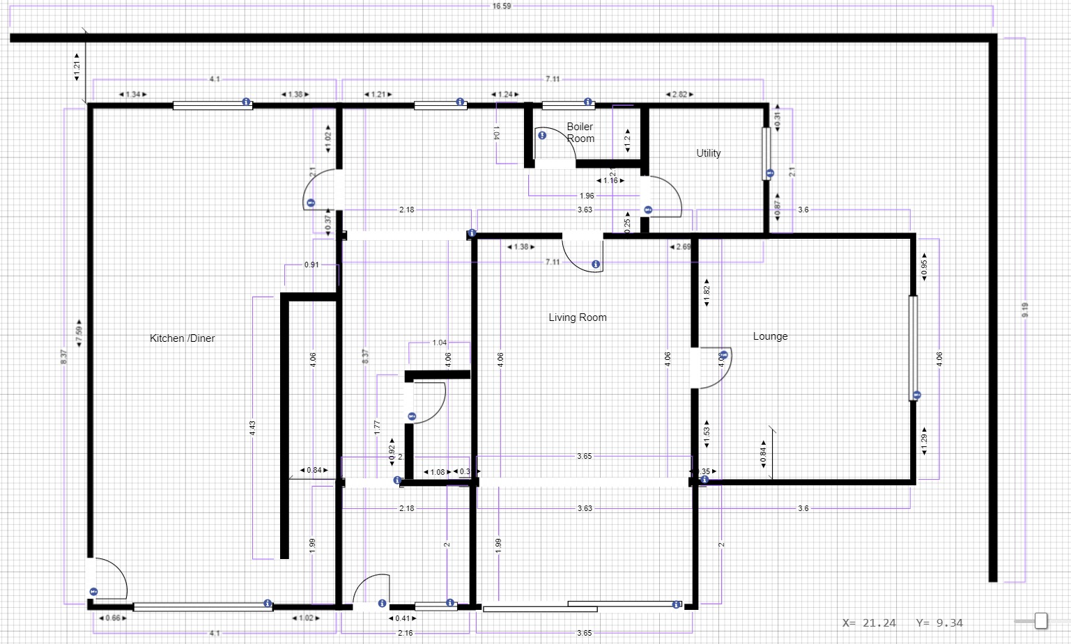

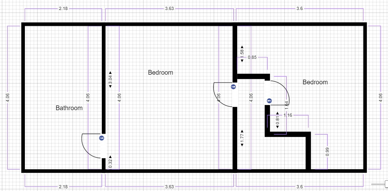

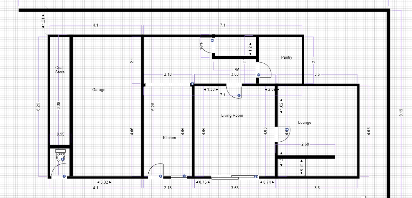

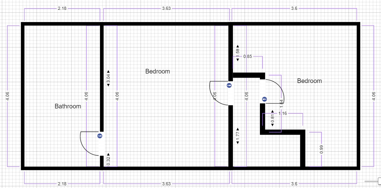

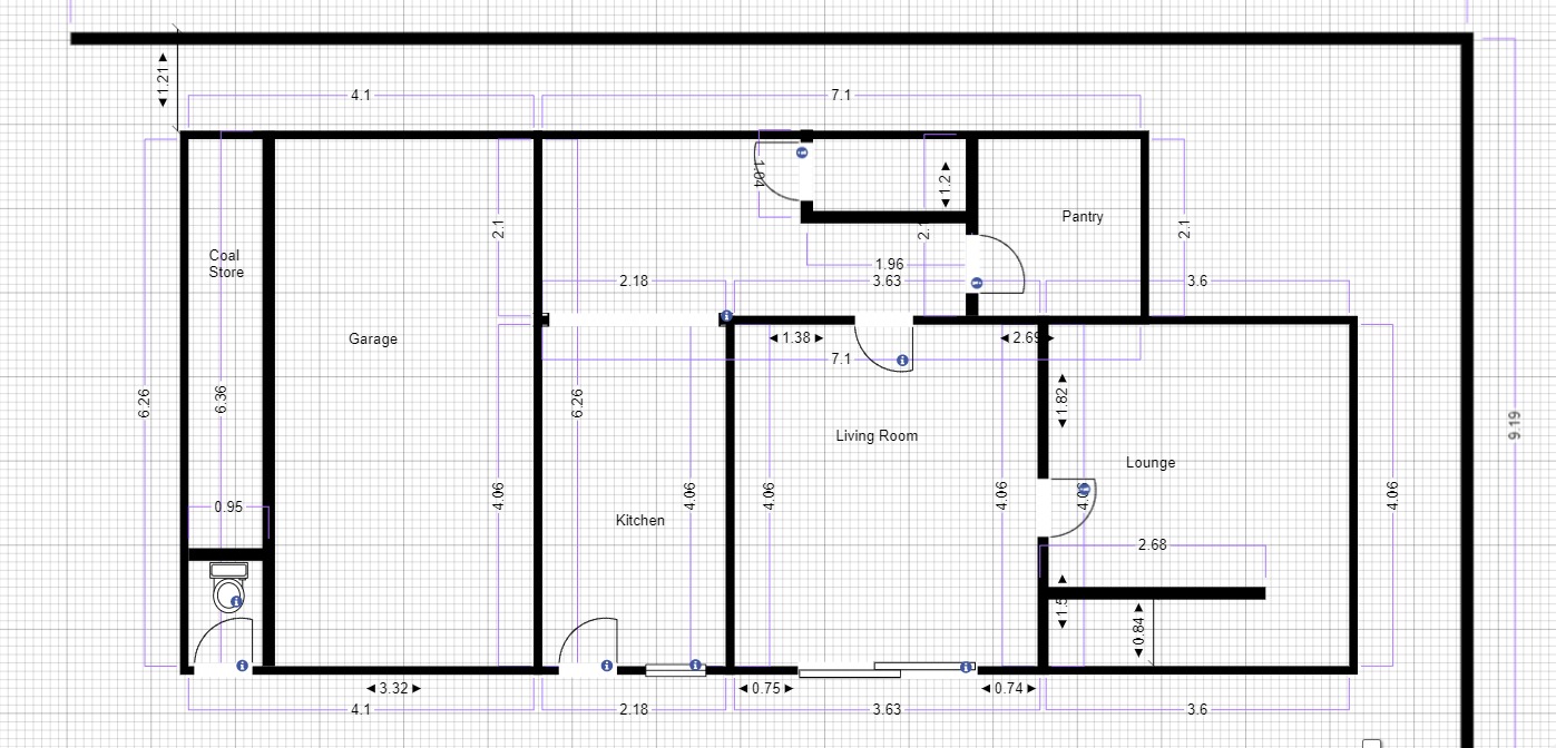

This is the existing ground floor and first floor. The measurements aren't perfect as some are measured by me, some are taken from the listing, some are guesses based on other measurements etc. The house also doesn't seem to be perfectly square so sometimes it depends on where the measurements were taken. I've also guessed the thickness of walls.
The front part is mostly stone construction or certainly faced with stone, from the second room back it is brick with render over.
The first floor is smaller as the back part is single storey. I don't think I updated the measurements of the single storey part, but it should have been 2.3m on the outer dimension, I guessed it a bit under.
I'll post up my proposed changes in a sec...

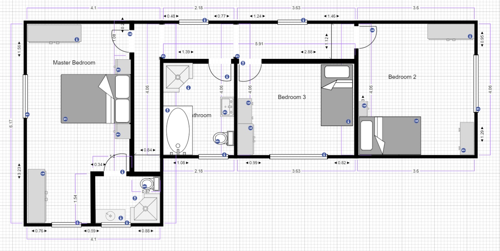

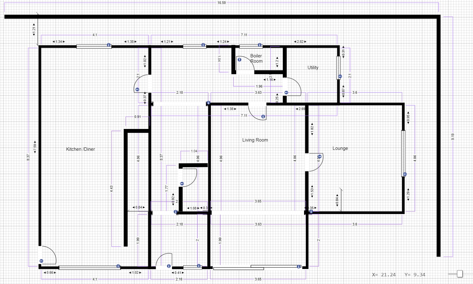

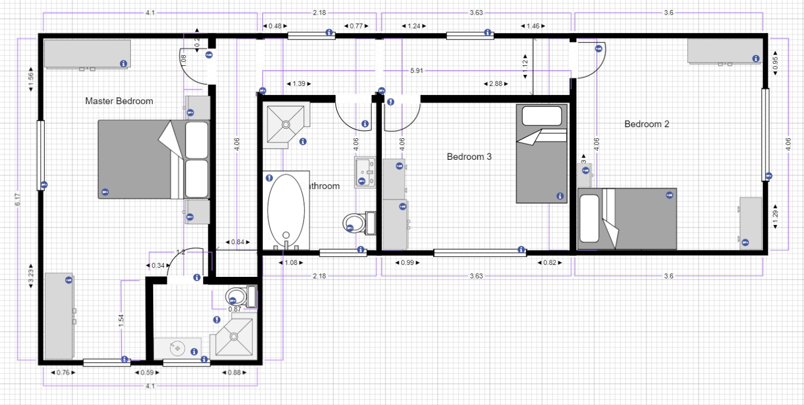

Proposed ground floor and first floor.
So in effect the existing attached garage would be replaced with a 2 storey extension and then that 2 storey extension would also extend an extra 2m to what I would call the side of the property.
The ground floor would also have a single storey 2m extension across the main entrance and the living room.
I'm not 100% finalised on the layout yet, but this would give the basic structure and it gives us enough room.

The road (single width country lane) - is to the right of the plans. There is no bay on the front but I'm assuming that as it lacks any real architectural features which would suggest the front, that the side closest to the highway would be classed as the front?
I'm fairly sure that from reading the PD rules, what I would like to do would not be classed as PD as it would fall foul of the following...
The 2 storey extension goes back 4.1m (replacing the garage which is already there at that size)
I'm not sure if the 2m coming out would cause an issue too, as it is 2m extra from the existing building line - the fact that it is 2 storey at this point probably would cause an issue.
So that's basically it - so first question - is that likely to get planning permission? (The other 3 houses on that stretch of road have all had planning permission for various extensions granted)
Second if I purchase this property and fail to get planning permission to do what I propose, then can I then just use the permitted development? If I can what is the size that I could create? Would I be able to do the following... Replace the 4.1m garage with a single storey extension - effectively converting the garage to a room (but would need rebuilding), then could I also have a 3m 2nd storey above it? Would I then be able to have a single storey 2m extension right down the side including down the side of what was the garage? Or would I even be able to keep the 2m part coming forward?

I tried the local planning department and now have a more in depth informal appointment booked for later in the week.
From what I could tell from the conversation I had today.
The garage would count as part of the original dwelling house provided it wasn't added after 1948 - I don't know how I can verify this.
The 2 storey part at the side wouldn't be permitted.
The rear extension above the existing single story - the person I was speaking to couldn't answer this one. He thought that 3m would definitely be allowed, but 4m was arguable, as technically we are putting a single storey extension above another and neither are going beyond the original rear wall of the dwelling.
A single storey 2m side extension should be allowed.
The only other downside is that any first floor windows on a side elevation would have to be obscured glass for privacy, but there is nothing to be private from and the other windows already at this height are clear and face the same direction.
So it is perhaps doable to nearly the same size under permitted development. Any thoughts would be greatly appreciated.
