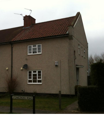

Basically, I will be happy if I can at least get a single storey back extension. I have gone through some applications on LPA website and Appeals site and the main reason for rejection were side-wall/rear-wall arguments.
My LPA has condensed the permitted development assessment into a checklist they go through (attached).
GPDO states that: The rear wall or walls of a house will be those which are directly opposite the front of the house.
Is my front elevation the one facing road giving the postcode or the one facing other road where the main door is?
Because the house has this corbel feature in the roof, although it does not go all the way to the ground, could it be considered as a "wall" making the proposal a side extension rather than a rear extension somehow?
Thirdly, looking at previous applications, there used to be a shed to the side of the house. which is towards the end of the house. This was shown in plans but don't form "original house" but I have no way to prove it. This is not attached to original house in anyway but I'm concerned that the LPA might view it as original structure and do GPDO assessment based on that.
I don't want to chance it because knowing my LPA, they just need a slightest of reasons to reject any application from me and appeals are taking months.
Old Side elevation
Old Front elevation
