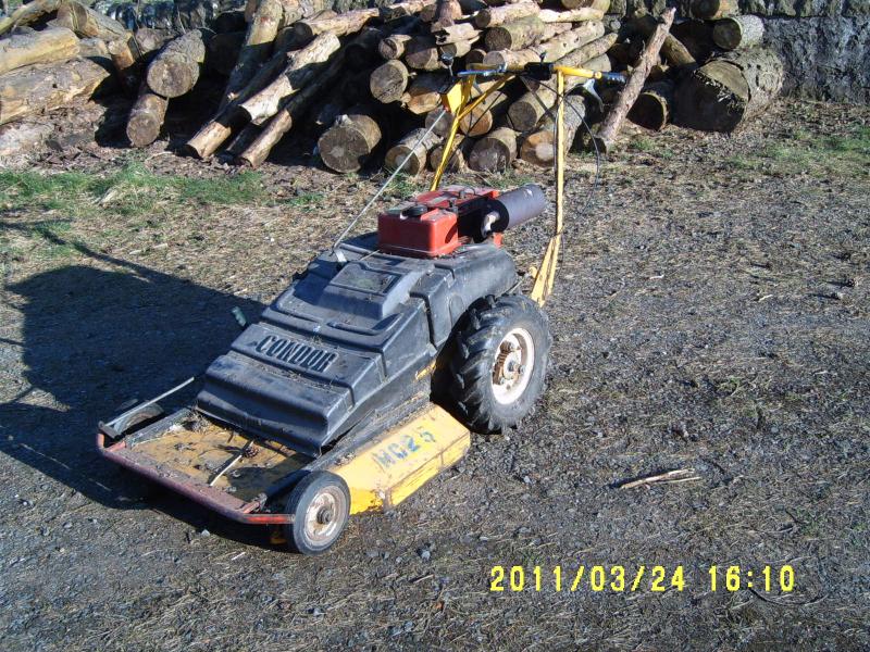

1" thick bramble, may be I was asking too much of a £100 machine? How else can you clear 1/2 acre thats been abandoned for 20 years?
With a £500 machine....?
I would also have held the revs in. But I do agree that for a £100 strimmer that sounds like abuse conditions.
People will make anything that will sell. Yes for £100 DIY it proberly would have being better being electric, but if somone wants a petrol strimmer and only have £100, they have a product for that buyer! They even have a long garden which needs an area lightly strimming onces a year...
If you want to do 6ft brambles that best tool i have seen mounted to the front of a skidsteer loader and could do a 6ft strip at about half walking pace!
