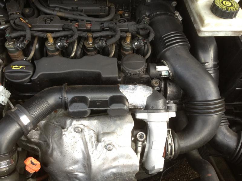

The white part to the right of the oil filler cap in the photos is not attached properly and I need to identify it
Can someone tell me what it is and do I need a complete section to repair it?

I've just been out to look at mine. Pretty sure it's the same lump, but mine's a Tepee. There's a cover on mine that covers most of the rocker box. Anyhow if you're talking about the breather (I assume) pipe going into the air feed pipe to the turbo from the right of the rocker box, then mine looks exactly the same as your photo.
The usual clip together plastic nightmare adored by the French :p
Its the rocker breather take off, and has an '0' ring inside to give it a seal.
Whats up - is it leaking oil or something?

Too often, these parts are just yanked apart when maintenance beckons.....the thing is, with care they can last for ages if everything is lined up before reconnecting them.
Anyway, a new 'o' ring should stop the leak, and if the joint is noisy, the chance are it's long gone anyway.
The part won't be cheap as I guess you'll need the complete trunking - a breaker could come to your rescue if you can be bothered!

It's not clear where it's separated but if it's where the White bit goes into the black bit then you will need a new turbo intake pipe, you could try glueing it :D
Got a complete new turbo arm from the local main dealer
Great service and the cost of the part was £37
