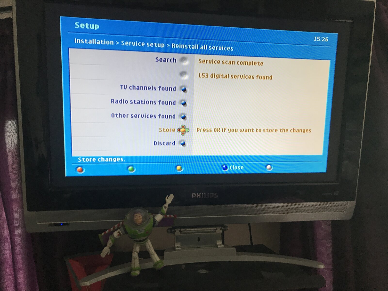

Hi all
I’m having a problem getting Stations to store on my Philips TV , I can go through all the installation & get all the Channels showing onto the set up
Page , then Store them , then can access the Channels no problem , BUT when I either put the TV on standby or Switch it off , when switching off all the Channel info has disappeared
is this an easy / ‘cheap’ repair , it’s only a Bedroom TV , only used occasionally, the picture etc is great & ideally I don’t want to replace the TV

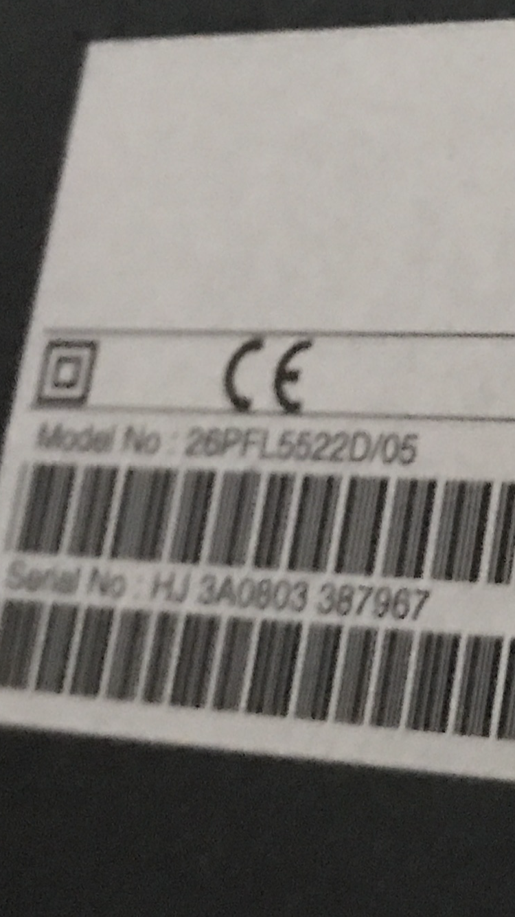

2x pics attached
Thanks for any responses

TVs often use what's known as a super capacitor to act like a rechargeable battery for powering memory storage when the set is off or in standby. If yours has had its chips then that would explain the loss of memory.
The parts are typically pennies to maybe a quid. Finding out if this is the problem, then replacing it without damaging anything else, and maybe then diagnosing some other fault if this isn't the fix is where the money is. What you define as "cheap" plays its part of course, but I wouldn't expect much change from £100-£150 unless you happen to hit it lucky with a repairer who has seen a few TVs with the same fault. That makes this neither quick nor simple nor cheap relative to the price of a new TV.

Hi,
I've had this exact same problem many years ago with a Philips TV which looks like it has the same menu format as yours. We fixed this by doing a special factory reset. There is a special code you type in the remote which brings up a hidden menu and you do something from there. You should be able to discover some possible codes from a quick google. I believe ours was 123654 or something which you type quickly on the remote and it brings up the menu. Sorry if i've been a bit vague it was a while ago and I cant remember exactly but on the bright side, its worked absolutely fine since so hopefully this will work for you!
i've done a bit of experimenting and here's how it works with ours. Turn the TV on as usual and scan for all of the channels as you would. After this, Whilst in on any *digital tv channel* type 123654 in quick succession on the remote which brings up a service menu, then type 123654 again which brings up the second service menu with an option to factory reset. Run the factory reset and scan for channels and see if that had solved the issue.
It's possible your tv has a different service menu code so as I said you might have to google it and try different options. I've also found this didnt seem to work on an aftermarket universal remote so you might need an original philips TV remote if you don't have one.
