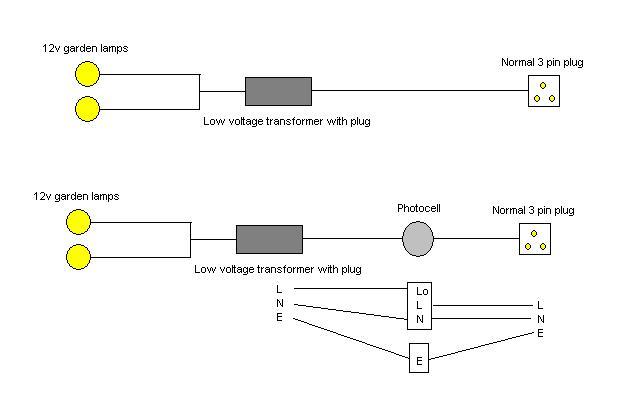

I have some 12v garden lights connected to a plug-in outdoor transformer. I was just wondering if I could turn this into a dusk to dawn set-up by adding a photocell between the transformer and the plug?
Also, the photocell has no earth terminal. Can I just connect the earth in a small terminal block within the photocell housing? Photocell itself is IP44.
I've added a diagram in case I've not explained myself very well.
Thanks for your help guys.
Unless you can find a 12V photocell you'll need to put the photocell BEFORE the transformer as it requires a 240V feed (at least the one I've got int the van does). Otherwise there's no reason it shouldn't work - it's just a case of wiring, switches and electricity-using objects in a line.

Yes, it needs to join, to continue the earth through, even if its unused at the destination
Its rare to find an earth connectio on photocells

I wired mine up as per the diagram above, with the photocell between the plug and the transformer and continued the earth through using a crimp that I left in the housing. Works fine:)
I used this one - although its not a timer and just responds to the light level: http://www.toolstation.com/shop/p62528
