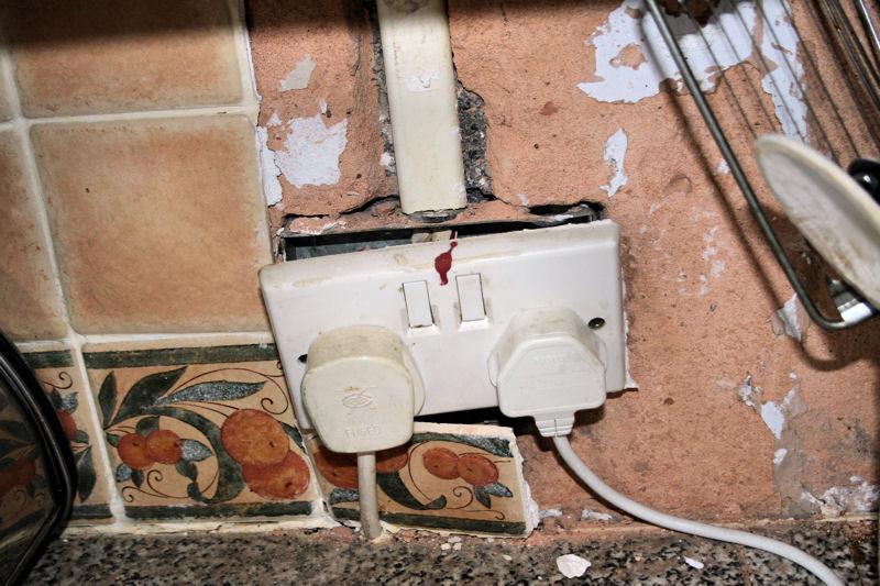

Firstly perhaps the least unusual, and probably perfectly safe except there was no grommet on the cable entry. I hadn't noticed it until today because it was beind the microwave, but the old fridge and freezer were running off an extension lead plugged into an above counter double socket, but installed under the worktop:

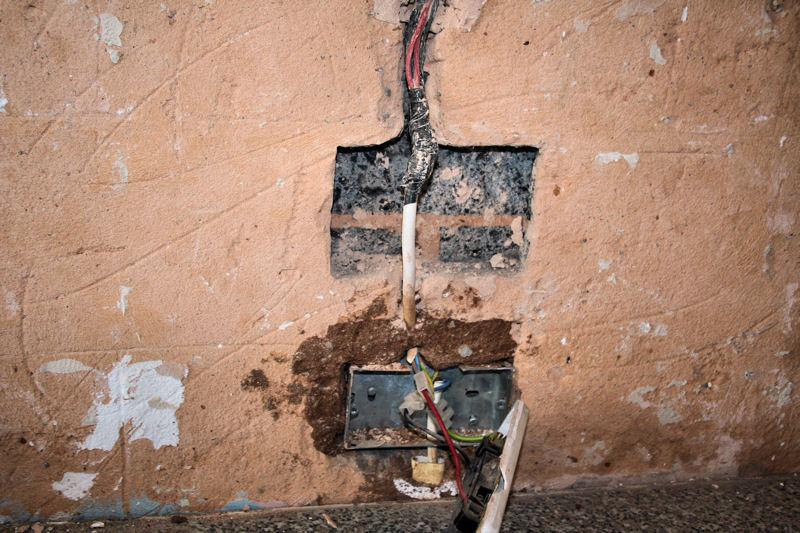

Then on to another double socket, which had obviously been moved at some point but the person doing it couldn't be bothered to replace the cable (easy to do as it is in conduit running up the wall to the roof space above). What puzzles me is why the cable has then been extended a second time. It is also taken from the ring as a spur, which then feeds another double socket nearby (that is the cable exiting the box at the bottom). The earth strands were not sleeved, and I am too afraid to undo the tape incase I make it any more dangerous than it is. When the electrician removes it I will be sure to take a photo without the tape present:

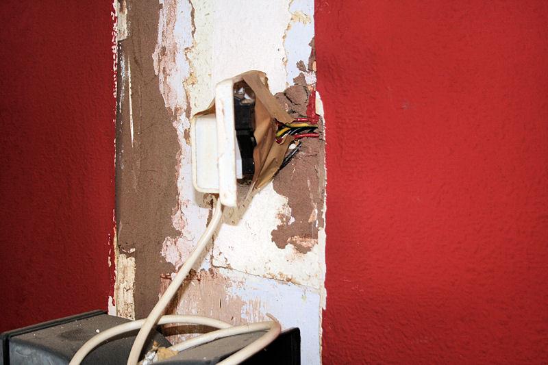

Now for the extraction fan above the cooker. This appears to be run from a single switched socket that is fitted on the ring main. No problem there, except that the socket is mounted directly to wires that just emerge from the wall, parcel tape was wrapped around the whole lot to stop it making contact with the metal extraction fan 'chimney' and the plug was inaccessible should the fuse blow:

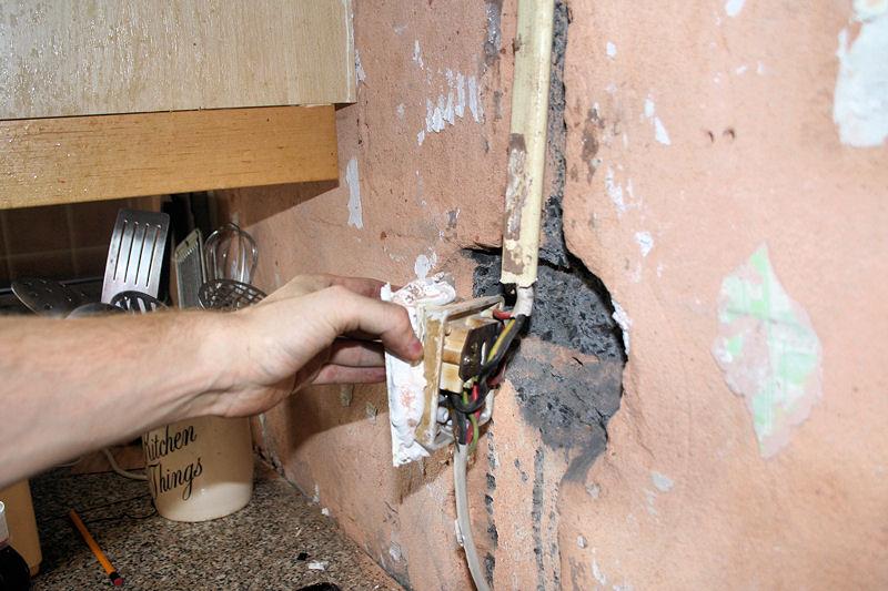

Finally on to my personal favourite - the cooker connection unit. It is on a dedicated 30amp 6mm radial, but again has been moved at some point in the past. Rather than replace the cable (again easily accessible to do so) the old CCU has been left in place and a new length of cable fitted between it and the CCU behind the cooker. There is no isolator on this circuit except for the main MCB. The old CCU had no back box and was wedged into position by the tile adhesive loaded over the top of it:

Anyway, the electrician has been and gone now, and won't be back now for over a week while other work gets done. In addition to that buried cable joint where 2 double sockets were run off a spur (which turned out to be the bare cables twisted together and wrapped in insulating tape, with evidence of heat damage) he also found a wall plug that had completely cut a live wire in two, meaning the kitchen had operated as two radials since at least the last refit. I was quite shocked by this (no pun intended) as it was blatently in a safe zone. There was also a double socket that did not have a good neutral connection (the wires came straight out when the socket was removed).
