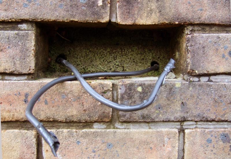

I have a number of these lights to fit ... 9
http://www.tlc-direct.co.uk/Products/GLBRICK.html
The bricks have been left out at appropriate places in the garden retaining wall runs, the front of wall is face brick, a 30mm or so gap then a 100mm concrete block
The question I have is how to physically fit these lights into the ‘omitted’ bricks space.
There are rear holes in fitting to take screws … but these I assume rely on the rear of the light being in contact with a surface … in this instance there is a gap of around 40mm from the back of the light to the rear skin of block work.
I can’t simply ‘do up, until front of light is set flush with face brickwork, as unless the screws pull the back of the light fitting against something to hold it rigid the whole thing is free to ‘wobble’
I have thought of cutting some stone ‘pads’ to go in, fixing through these .. so in effect using them as spacers … but not easy, and messy.
Each pad would be slightly different thickness … ‘infill space’ varies between 20 & 50 mm.
I did think of taking a common pad thickness and setting these in place with a ‘gripfill’ type of adhesive, at least I could set each pad to correct spacer thickness.
An alternative that a neighbour suggested was fixing the whole thing in with expading polyurethane foam, just seems a nit of a bodge - and risk of getting foam on facebrick
Welcome suggestions.
My suggestion is to make wooden spacers of the different thicknesses you need. If you use tanalised timber (offcuts would do) you can be reasonably sure they will remain sound. You could fix them with screws and plugs, then screw the lights to the wood, or glue them in place, or drill oversize clearance holes so that your light fixing screws go through them into the masonry.
Using foam may not necessarily be a bodge, but I agree that it can be messy stuff to use.
I have plenty of treated wood on site ... and if I put a piece of DPC between it and block, it should keep it dry .... Thnx
You could use long screws thru short sections of copper pipe to form spacers [cut to match gap sizes]. No risk of swelling/wrotting timber.
