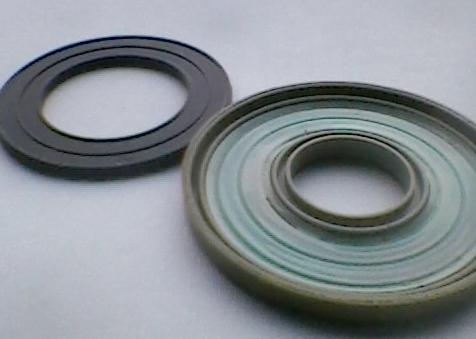

The bearing is made up of two plastic discs with grooves on the inside that are greased and cupped together. When I reassembled the strut, the rubber bushing is rather tight to turn.
Is that the norm for this type of bearing?
This is the bearing type by the way.

Did you separate the two halves of this bearing?
I guess it could be pretty tough to turn, after all there is the full force of the spring acting upon it.

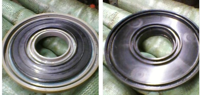

The inside of the strut bearing. No steel balls just surface contact, lubed with grease which I've cleaned off. Its weird.

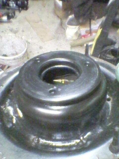

The bearing sits on top of the spring seat.

Taking it one step further, the rubber disc seems to rotate in the upper half but I don't understand which it has tracks rather being flat to increase surface contact and reduce friction.

Its the upper half where the original lube was so I packed it out with rubber grease since the disc is rubber, put the strut back together and that has eased it. Still takes reasonable force to turn the rubber bush but a lot easier. I presume the ridges that run around the disc are to retain lube and stop it being forced out.
That sounds like the proper diagnosis.....of course the stiffness won’t be noticed back on the car.
As there doesn’t seem to be any wear apparent it must work very well!

Well I've now rebuilt the n/s strut having taken the bearing apart, cleaned and greased with rubber grease. With new strut assembled, the rubber bush turns better than when I took it off the car so all is well it seems.
Further to the construction of the bearing, the green disc in the white half is actually thin transparent plastic disc. A weird and wonderful design by the Koreans.
