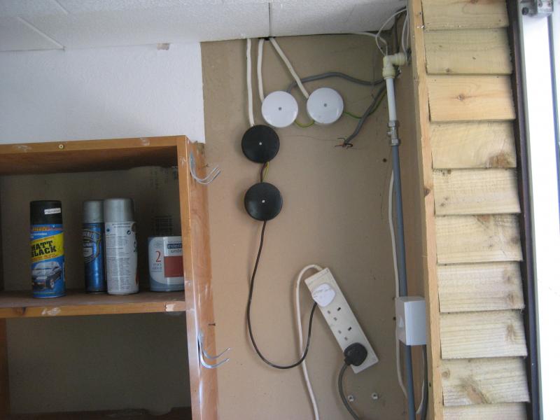

Yes, shed with a bed, lavatory and shower. Outside, on a tasteful set of decking, a hot tub too surrounded by a screened pergola. 8' x 4' pictures of Rome and Barcelona, daisy chained lights and various amphorae and vases (presumably where the car keys were put).
Lovely.
BAS,

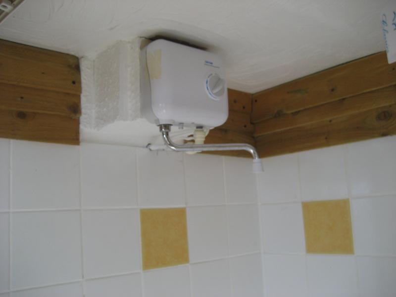

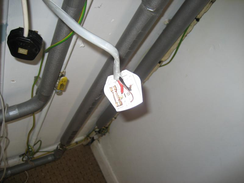

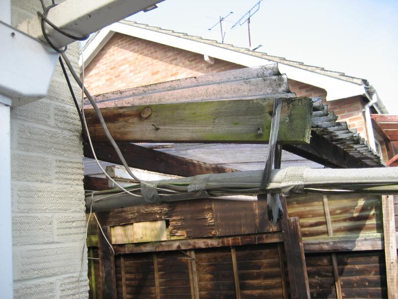

Developer asked for remedial work. There are other delights too - all from the same property, examples being, five T/E cables 'connected' together in the attic space with choc. block and tape but CPC's cut off, or the feed to the boiler T/E nicked in two places exposing line conductor in two places, bedroom socket feed taken from lighting circuit, all CPC's unsleeved, socket in outbuilding covered by plastic flap as roof leaking onto it (adjacent to bed - hope the bed had plastic rollers on the feet) etc etc
Probably the worst, single property I have ever seen for bodgehamptoness - we do not know what happened to the owner but I guess he died of shock.

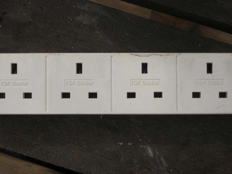

Anyway - look on the bright side - you don't need to do, and the developer doesn't need to pay for, any of that fiddling around testing and inspecting a sample of accessories... :LOL:
