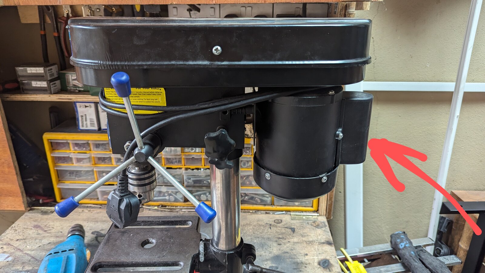

I have an Energer 350W Drill press I bought from Screwfix about 5 years ago.
It has a capacitor behind a plastic casing on the back of it that has melted. The drill will only work if I give it a spin with my hand to get it going.
All the 350w pillar drills from Screwfix (Titan), Clarke etc seem to have the same design so I'm guessing will have the same rating capacitor.
I'm wondering if someone could have a quick look on theirs to see what rating it may have. Two screws involved and I'll attach a pic of the location
The bit of my capacitor that hasn't melted says 'CBB60'
Cheers
The CBB60 capacitor is rated at 14uf.
John

Guess I'll find out as I've just bought a 14uf one
This video suggests its a 6uF 440V capacitor.
