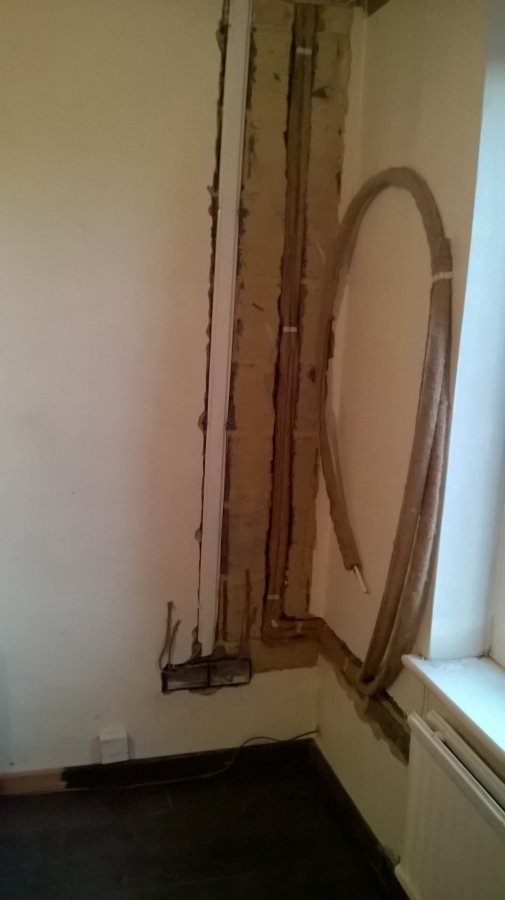

I'm struggling to see how I can achieve the horizontal turn without an elbow in the wall. I would welcome your thoughts on this. Here's a picture of one of the drops that I did. I welcome your thoughts on this
You wont get round that internal corner without an elbow.
Is that okay? Is the Hep system robust enough to have fittings in the wall? I was hoping to avoid it but clearly, not possible in this case.
I wouldn't but you don't have an option the way you've done it.
