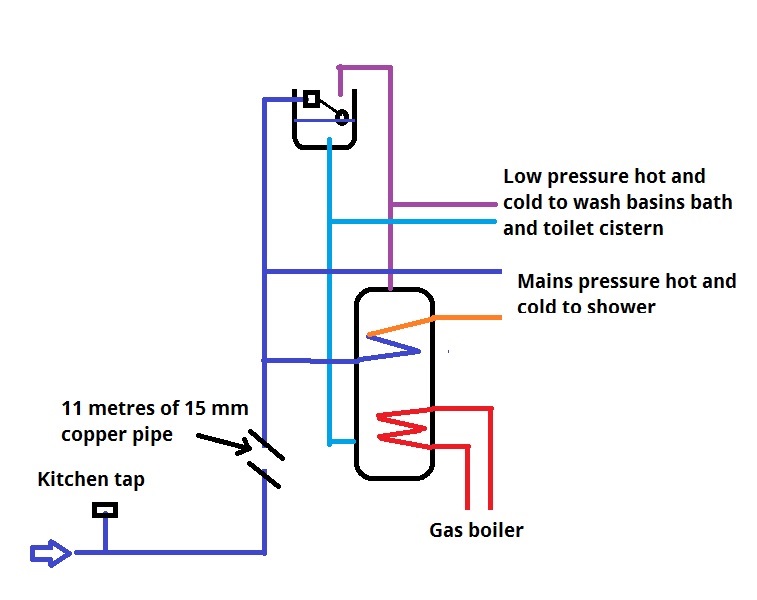

Arr, i could do that but the store i acquired cheap is direct rather than indirect & has the plate hex, pump, switchgear etc already attached.
The same q with pipe sizing would apply to your setup running 2 bathrooms...

Fluctuations in pressure will be minimised by having separate pipe runs from heat exchanger, one to the shower room and the second one to the bath room.
When there is a length of pipe that is common to both outlets the pressure drop along that pipe due to flow to one room will reduce the pressure of the supply to the other room .
HEX
---common pipe------BATH ROOM----------SHOWER
HEX
------------------------BATHROOM
-------------------------SHOWER
Using a large diameter pipe for the common run from heat exchanger to bath room will reduce but not eliminate pressure drops along that pipe when water is flowing into the bathroom. Reducing the pressure drop along the common pipe will reduce the pressure fluctuations in the shower room
A large diameter pipe has a larger water volume hence more water will be wasted before hot water arrives in the bathroom.
The resistance to flow through the heat exchanger will be common to both bathroom and shower room outlets and will result in flow to one room affecting the flow to the other room.
The heat transfer capacity of the heat exchanger will also need to be large enough for the heat requirement of both rooms to be met otherwise temperatures will drop when water flow through the heat exchanger increases.
