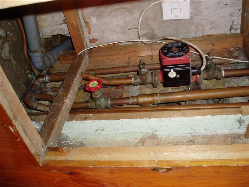

I am hoping that someone/s can give me some advice on choosing a thermostat to attach to the pipework at my mums house.
The house is heated soley using a rayburn, Its very basic there is also a hot water tank and immersion heater for hot water.
If the rayburn is left on for a long period of time then the hot water gets very hot and if the pump is not switched on then the loft becomes incredibly humid and condensation starts dripping from the roof and the ceiling has collapsed before now!
All the tanks are in the loft and it gets like a greenhouse.
I am not aware of any valves on the pipes.
Can I buy a thermostat that clips onto a hot water pipe that would activate the pump when it reached a certain temperature?
Would it wire straight into the fused switch with the pump or would I need a small controller?
Its a bit of a bodge so I am looking to improve it as best I can.

The picture is on its side, granted the overflow pipes need replacing with proper pipe and solvent weld fittings but it's making the Rayburn safer that I really need to concentrate on.

Right I have just ordered a Honeywell L641B1012 High Limit Pipe Thermostat.
I am going to wire the thermostat to the fused spur, C to the live and 1 to the neutral.
I am then going to wire the pump to the thermostat, Live to C and neutral to 1 and then earth the pump also. When the thermostat reaches temperature on the pipe it will call the pump to become live and thus start pumping the hot water around the central heating system so that it does not simply rise and boil the tank.
Does this sound correct?

You can probably make out in the pictures the pipe comes straight out of the rayburn above the gate valve.

The live to the pump connects to 2 in the stat.
I said you'll burn the boiler out, not the fuel, the Rayburn should be ticking over quietly, not roaring away.
