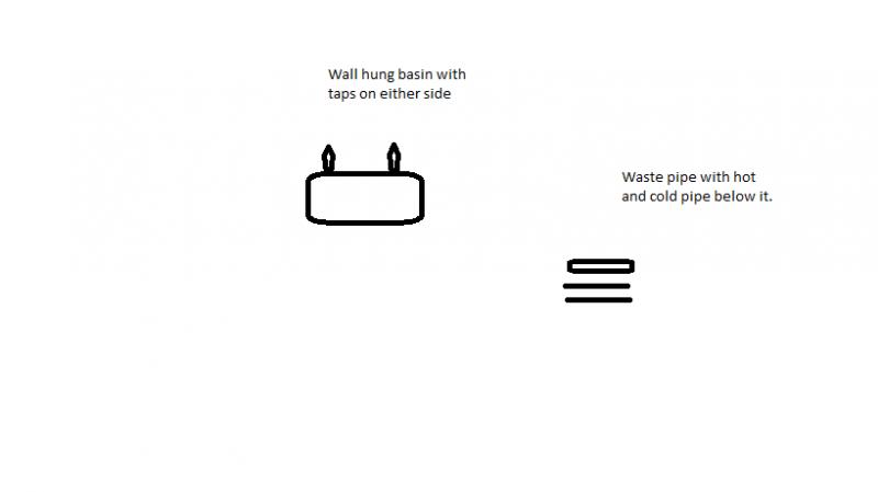

Hey. how would most people pipe up a wall hung basin like the one in the diagram. Go straight up were the taps are. Or run the pipes up the middle of the basin and offset to the taps? Would be piped up in copper no flexis

The pipes will be on show in this case. Yes I mean a basin without a pedistal. Runing in to the room above the skirting board.
It aint goint to be too pretty but I'd run both pipes parallel up to the centre of the basin, and then branch out where the bends couldn't be seen.
You'll have to dodge the drain though as thats central too!
John :)
Ok thanks so you'd run the pipes up central the offset them as tight up to the taps as can so bends can't be seen much. Any ideas for the waste with that wanting to be central too?
Its only my opinion really - things that are central could look ok, but offset could catch the eye.
I'd pipe up to the waste, then dive off left and right around it. Flexi's could help here.
If the basin is tight in a corner, I guess you could come up the wall then go off horizontally - the more the pipes are hidden, the better really.
Is the waste covered by ceramic that usually clips onto the bottom of the basin?
John :)
What do you mean by.''I'd pipe up to the waste, then dive off left and right around it. Flexi's could help here
There's no cermic that clips to the bottom of the basin is all on show.
I would take the pipes along the skirting, as you say they are now, and then turn them up, along the centre line of the basin as high as possible until the waste gets in the way. Then, take the hot to the left and the cold to the right, keeping the pipes as covered as much as possible.
