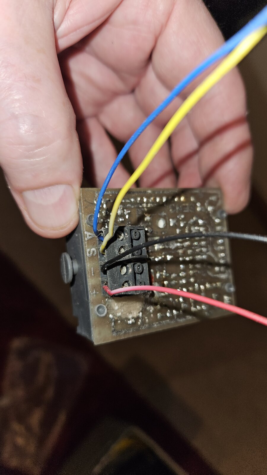

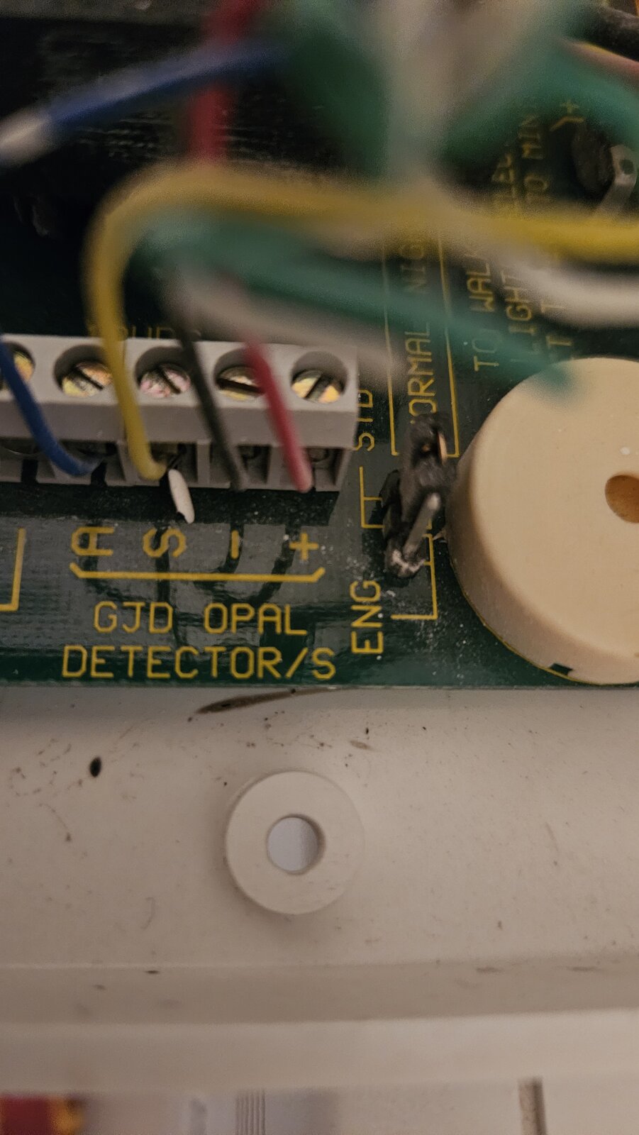

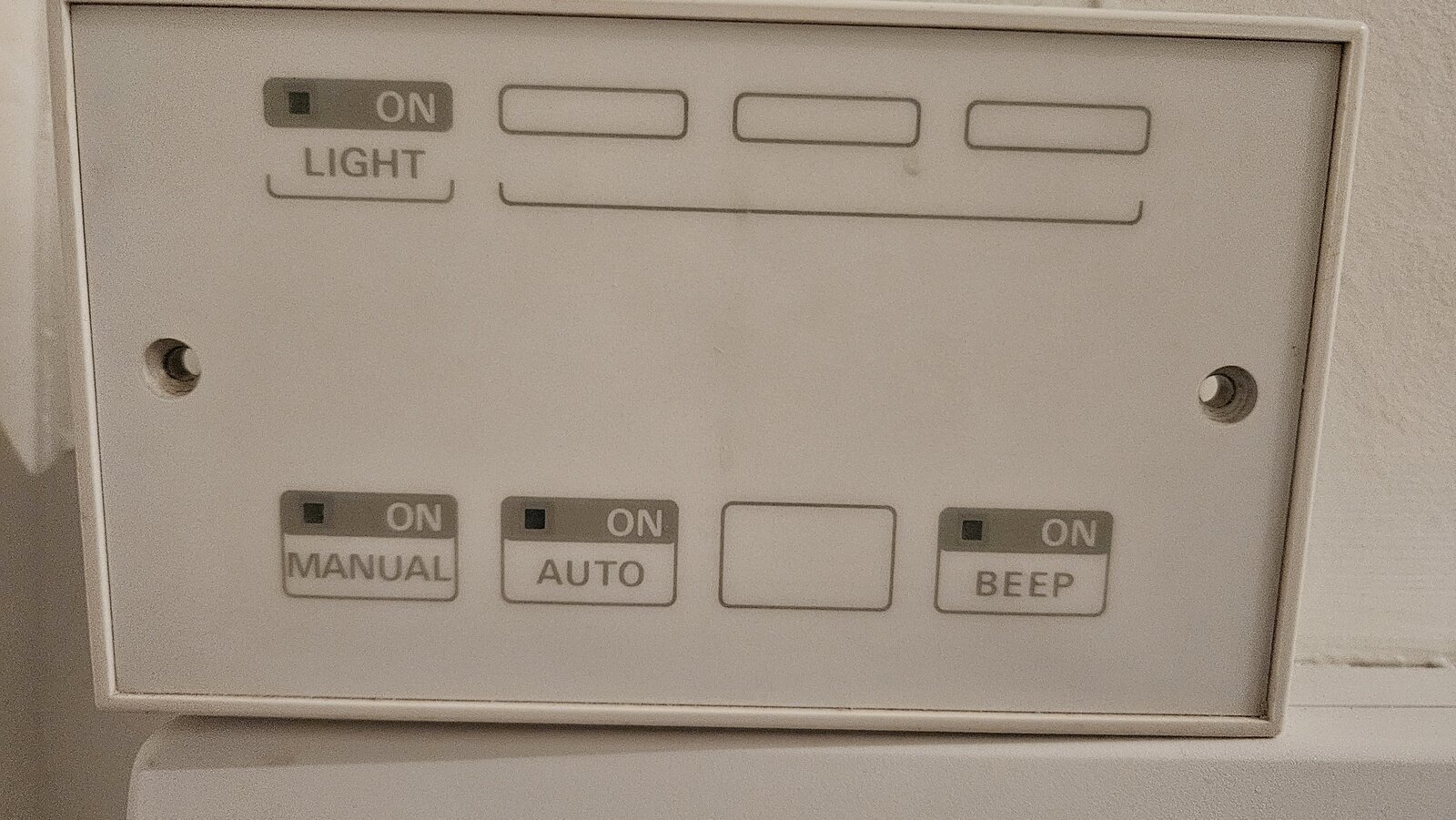

HI, i need to replace a pir which is connected to a ' control panel' and would appreciate advice on what exactly I should be looking for.
Hopefully the attached pics explain the situation. Until tge lens on the pir shattered it was connected to a HI, i need to replace a pir which is connected to a ' control panel' and would appreciate advice on what exactly I should be looking for.
Hopefully the attached pics explain the situation. Until the lens on the pir shattered it was connected to a halogen securiity light but I would like to replace this with 2 x LED lights
First pic is control unit, second, internal, third pir internal .

Ok you have a gjd lighting system …they still make the detectors they are opal XL …PM me for details on best price for these
