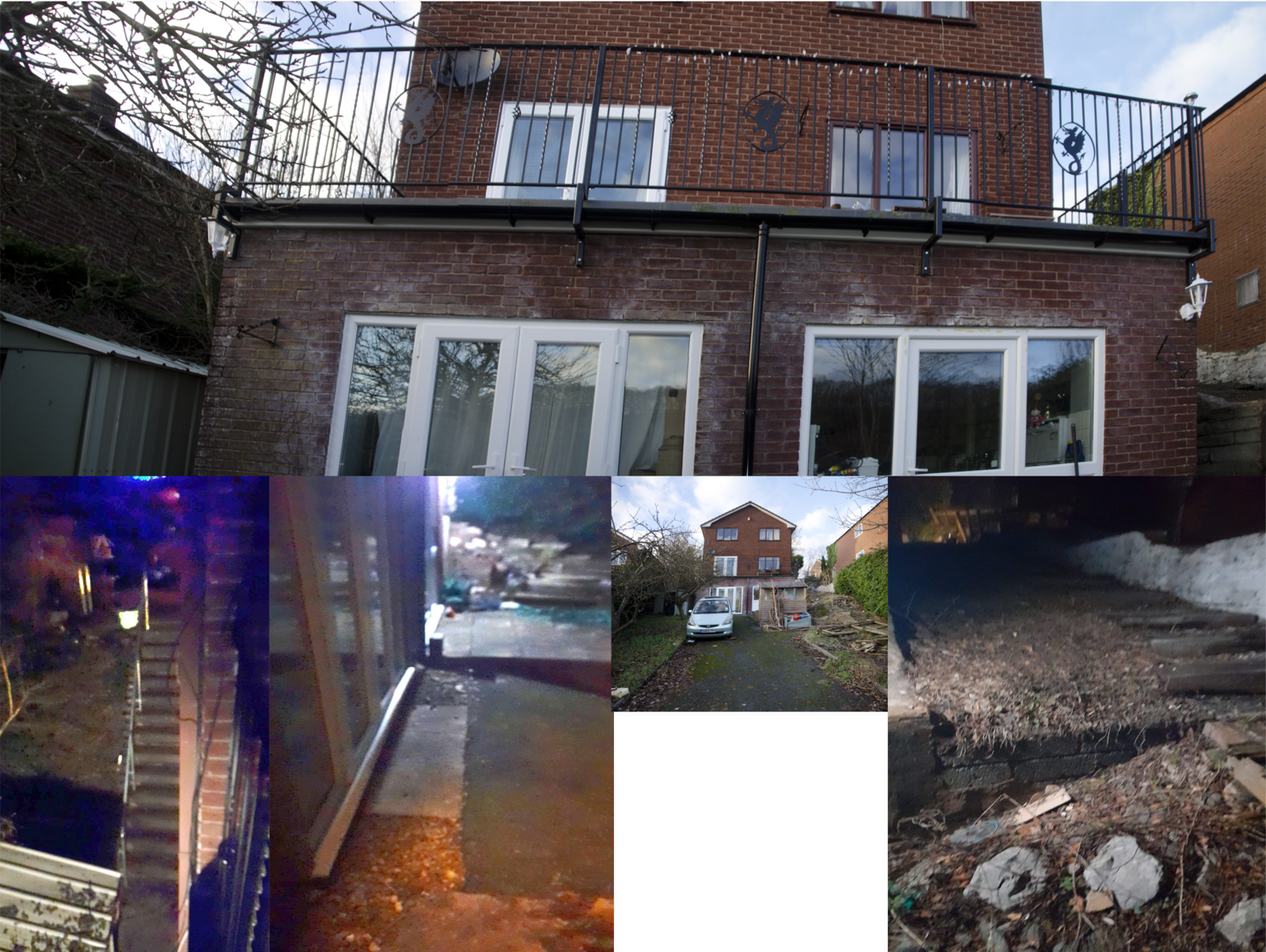

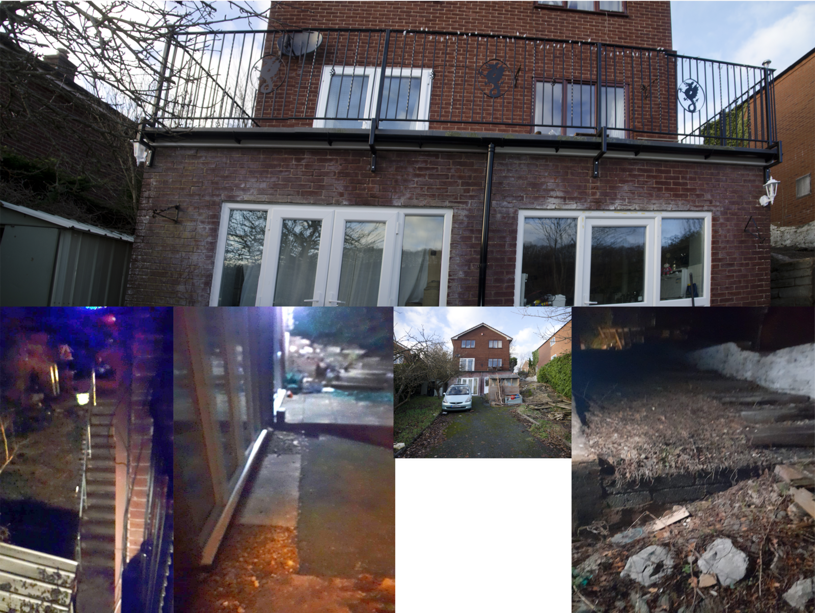

I have just replaced two 150 watt I would guess flood lights, with two coach lamps, with just 800 lumen smart bulbs, positioned so I can see both in front of house and up the side, 1674352344973.png it is not clearly flooded in light, it is a large area to light with just two bulbs, but it is enough to see from car to house and around side of house to front door, to get a PIR to control light around the corners is not going to happen, this was what was wrong with the original set-up, they would switch off when I was half way up the steps. So new bulbs are smart bulbs, so I can switch on before I leave the car, and off once in the house. So down from 300 watt to 18 watt.
