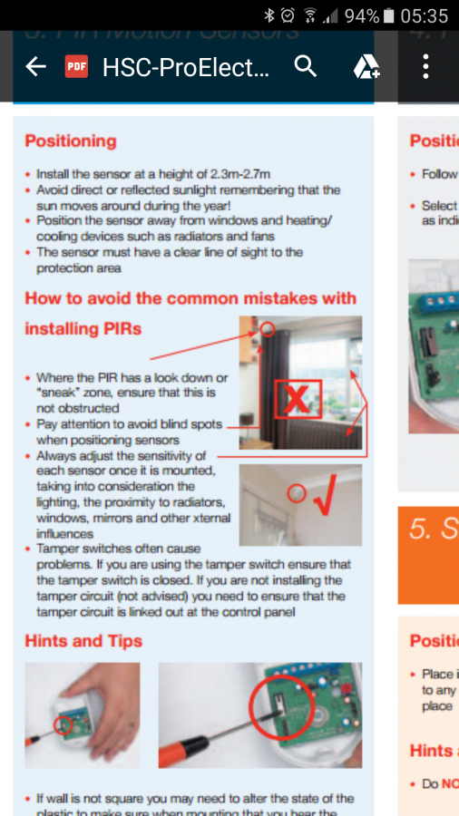

After much consternation, I decided to position my PIRs so that they are facing the windows/bifold doors. The thinking here was that, it would deter any intruders that are peaking in and considering an entry.
With the plastering now done (after the cables were positioned as described above), I am now concerned that the PIR's will be generating false alarms by someone walking outside the door or a animal walking across the door on the exterior side.
Is this the case and any advice on the matter will be gratefully received. Thanks
Your external sounder, decoys and any signage should be your deterrent.
Its bad practice to direct motion sensors towards windows. But i wouldn't worry about if its in place.
