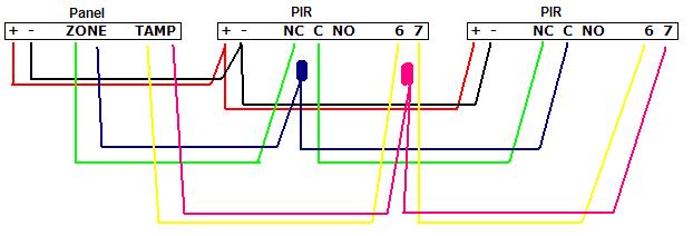

I only have 6 zones on my alarm unit (Optima XM6) and 7 rooms.
Can I spur an extra PIR (Apollo C) from one of the existing PIR's or will this overload the zone that I spur from?
I realize that if I can do it, two rooms will be covered by one zone.

How do I wire from one PIR to a new PIR so that each PIR works separately?
Conections are :- (power 2 terminals) (12v) - & +. (Alarm 3 terminals) NC C NO. Tamper NC (2 terminals No. 6 & 7)

This is how I have my PIR wired.
[GALLERY=media, 21655][/GALLERY]
I want to wire a second PIR from this one so that they both work independantly from each other.
Something like this - colours mean very little. Use what ever colours are already used.
Thanks a lot.
That is very good and easy for a plonker like me to understand.
I assume that the black wire (ZONE) has been removed from the first PIR C & extended to the second PIR C
Then The red wire (TAMP)removed from first PIR 7 & extended to the second PIR 7.

Yes correct twist wires together and use a small terminal block to prevent the wires shorting against the pcb.
Ideally, twist, solder and insulate.
As I said, colours in the pic mean very little - substitute my colours for yours.
