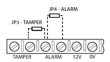

I just wanted clarity on something please. The PIR wiring method I used following the manual is:
I connected a wire from zone 2 (on control panel) to terminal 1 (tamper on the PIR) and the other zone 2 wire from control panel to terminal 4 (which is alarm on the PIR). Is that correct? Should the zone be configured with wiring method DEOL. Am I right?
Thanks,
Abu
first tamper last alarm, the elite 24 only has two terminals for a zone.
the zone wiring type depends on the resistors used, so double pole/ eol is 4k7 alarm and 2k2 eol, if your using different resistor values then you need to select the appropriate wiring type.
That's fine then. My understanding is correct. I am using the built in resistors. Tamper 2k2 and alarm 4k7. Cheers.
Just re-read your reply, is EOL another name for tamper then?
no end of line is the resistor at the end of the line, it would only make it confusing to go through the different types of eol available but your straight with what your using now so lets leave it that way.
