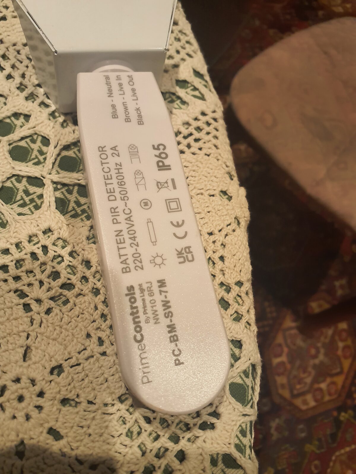

How do you adjust this, I had similar from cef once and the instructions said you need a remote.
This one has no instructions
Yes I know I could contact prime light or Google the postcode and go there and ask :giggle:

None of the "codes" apparent in Photo 1 yield any result from my Search Engine,
nor does the "PrimeControls" or "Prime Light" name !

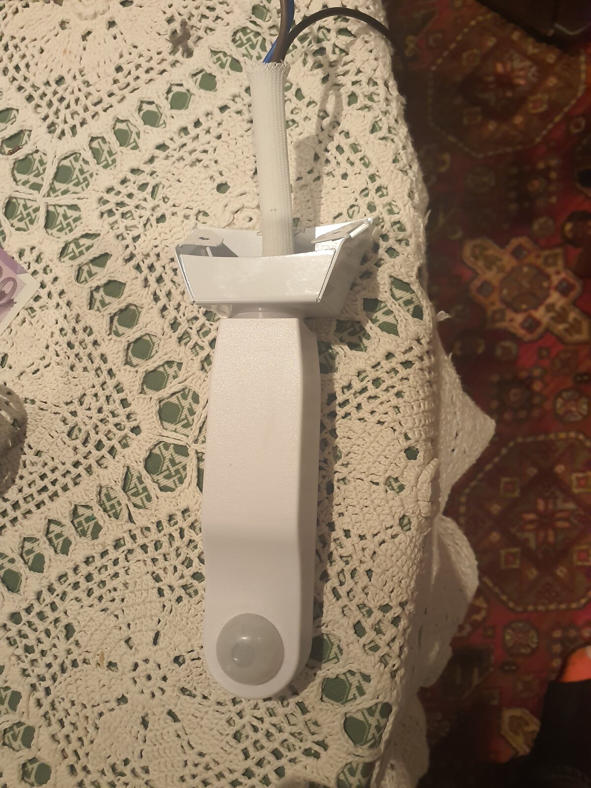

Looks like it bolts onto the end of a strip light so it wouldn’t need any adjustment it’s only looking down from the ceiling ….

The "code " on them is actually the UK postcode and it does indeed come up with Prime light who are actually a Uk company, amongst other businesses in that area in North London. NW10.
Though may originally not be of uk origin.
They are on brand new fittings on a site, I have yet to attend and were Installed by other contracters, hence no instructions.
That bracket fits onto round bulkheads, but any fitting with the correct bracket.

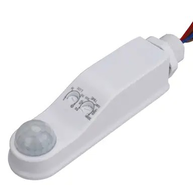

Similar are now becoming quite common here though usually have adjustment like below.
You drill 20mm hole, fit using a locknut and wire into the supply, a simple way to convert any internal fitting .
I now think these have been made special and incorporate some form of corridor function where the light reduces levels with no movement and hence are preset.
I quess i will need to phone prime light
The cef one was on the ceiling and as you say the pir side worked fine however the timer was only about 5 seconds unlike the 20 minutes quoted in the instructions.
That also said you need a remote? to adjust them which was no help
