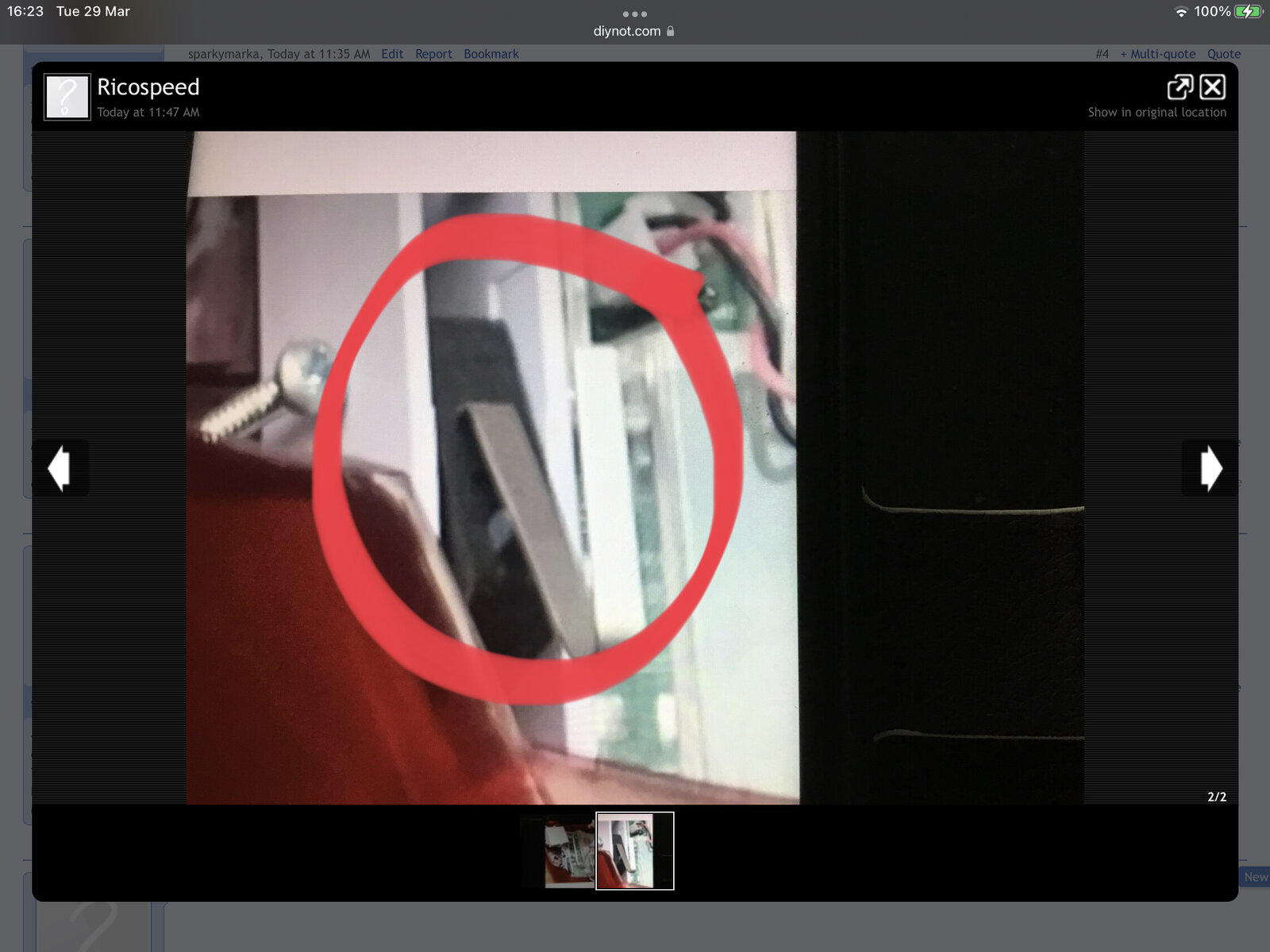

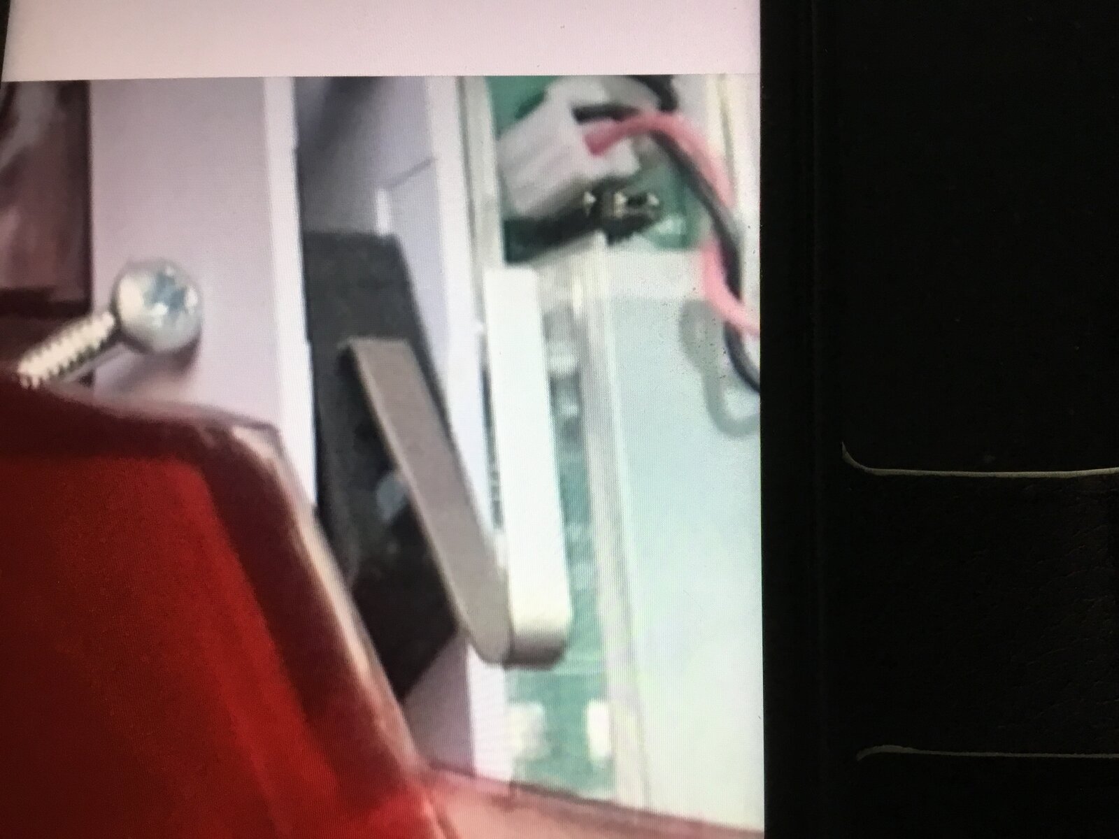

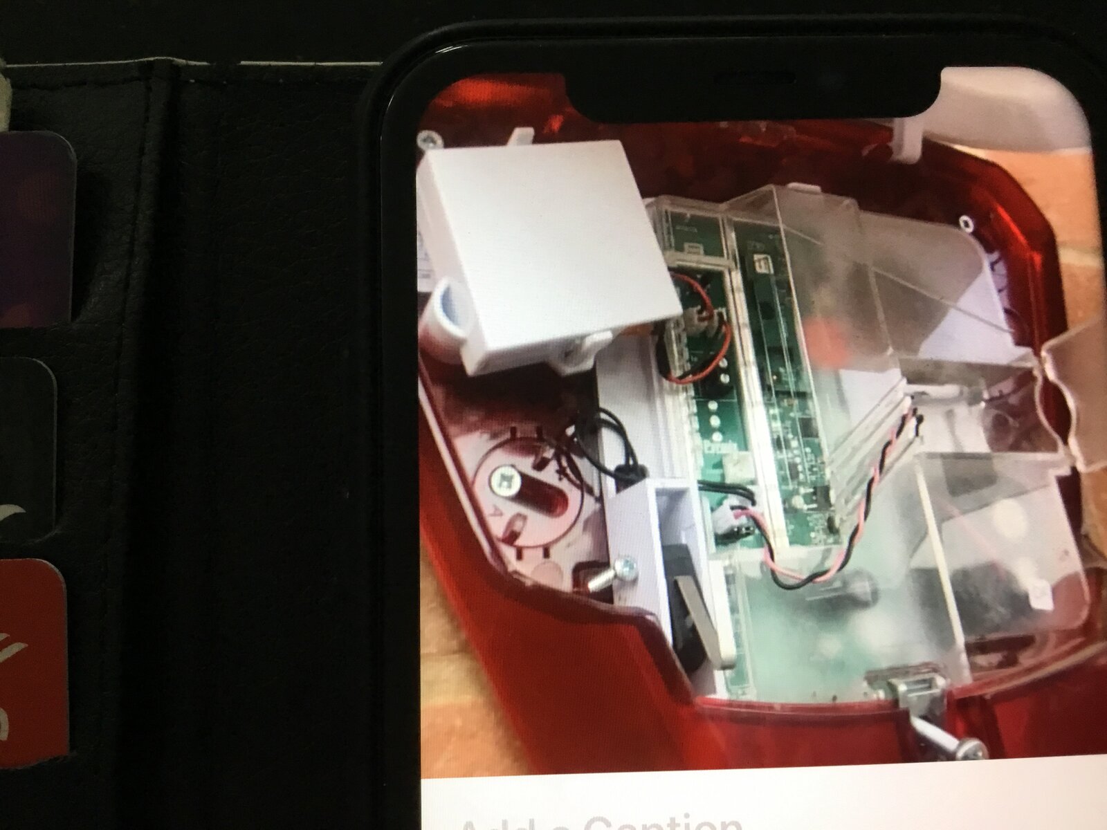

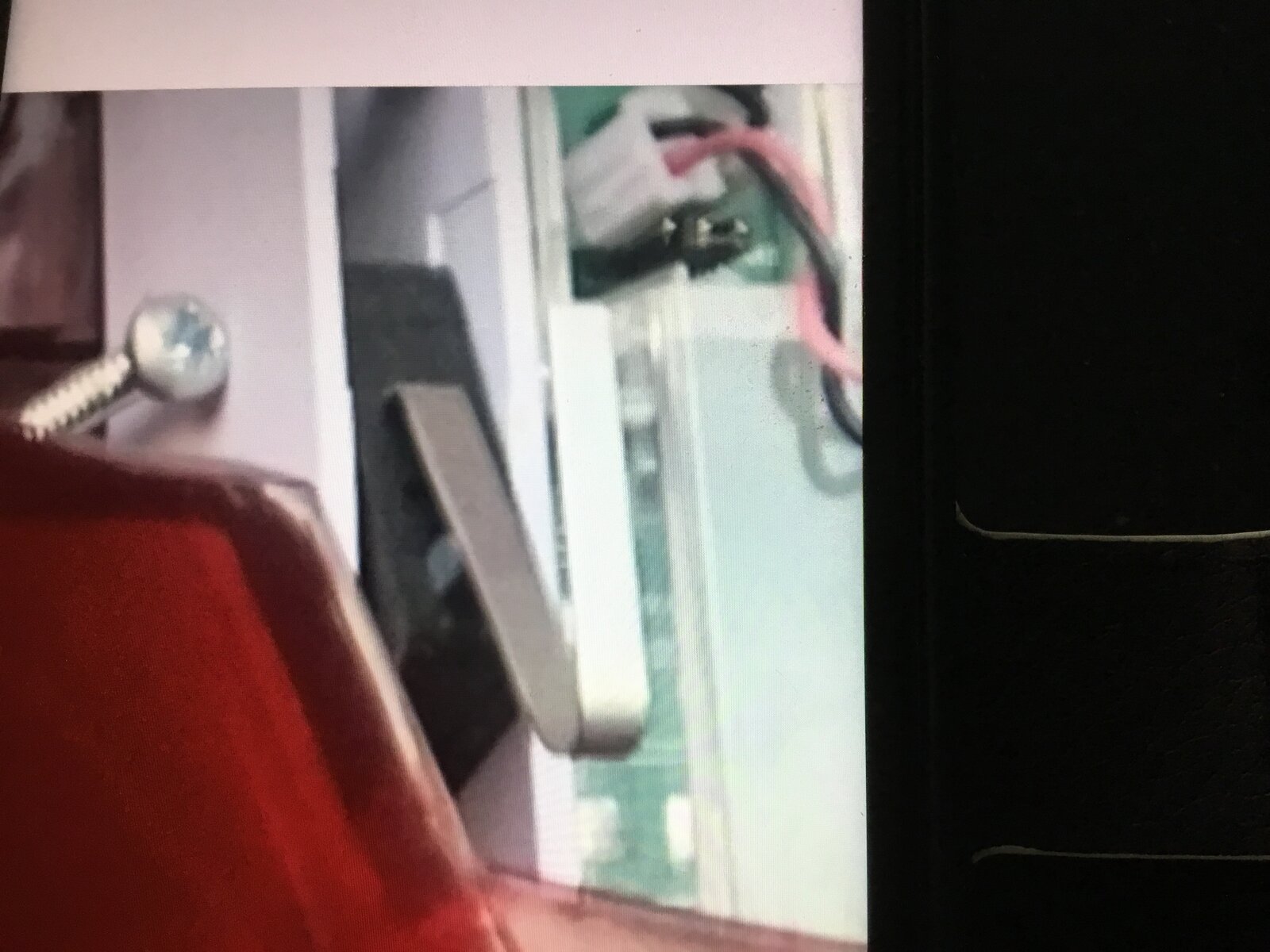

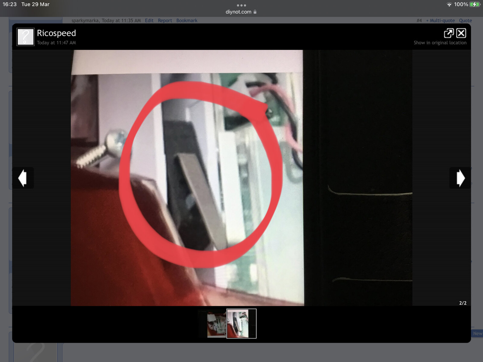

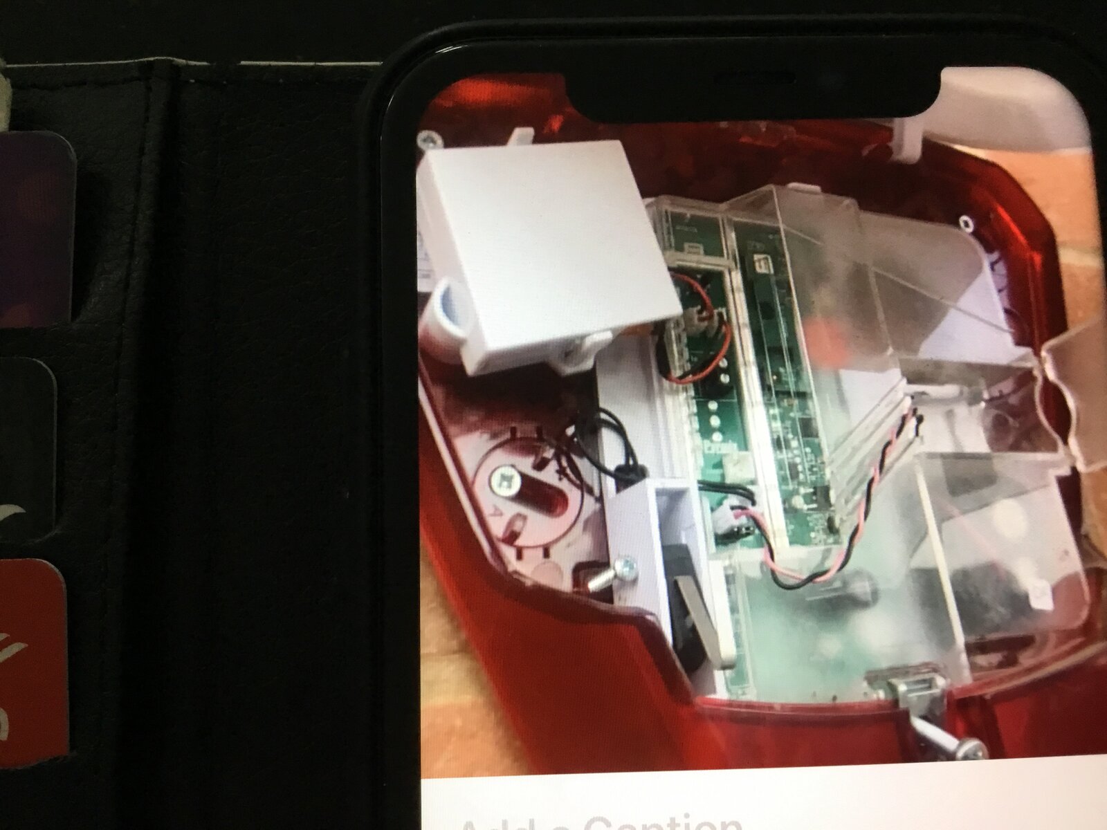

Replaced batteries outside reset all good then a while later alarm keeps triggering showing siren tamper unable to clear it I have had to switch it off at mains Any help please before I have to get someone in to look I feel it must be something simple. Have changed batteries before with no problems so I’m baffled this time Thanks
Have you checked that the tamper micro switch is closed correctly on bell box lid.
Adjust metal lever if necessary.
You will get clicking noise from switch when lid closes onto lever.
Can hear the click on switch but will reconnect batteries and retry that Thanks any suggestions are welcome
Can’t do it until this afternoon so will let you know
Have tightened up the loose screws you can see
