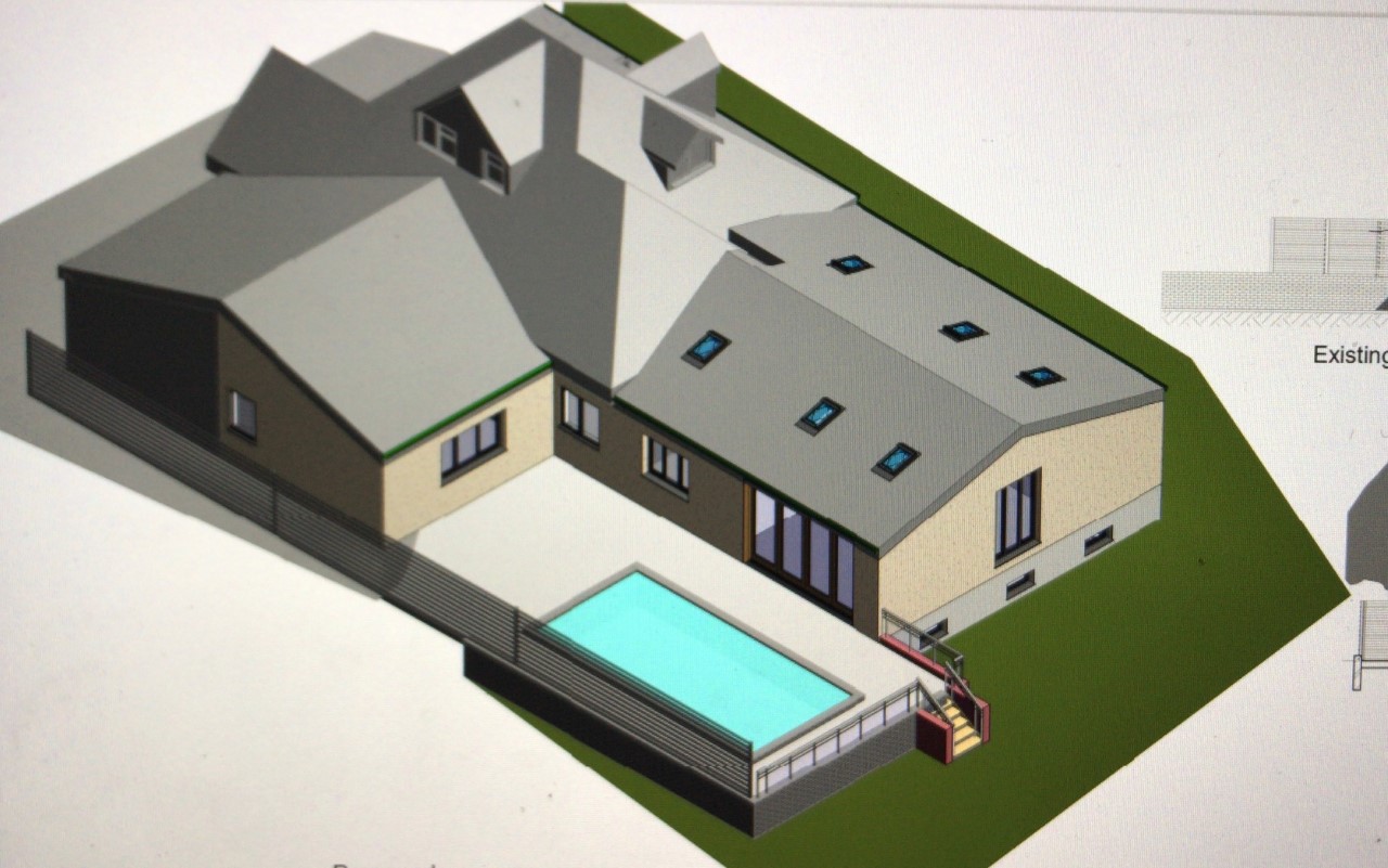

Can I kindly get some opinions on Flat v Pitched roof, please? I am stuck between the 2, and have been for a while! I have added a few pictures below.
Dormer Bungalow
Area of extension in question is approx 100m2
North facing garden
Pitched (Spec'd at 17.5 degree pitch):
Like the look Externally as it blends in with the existing property
Vaulted ceiling
Probably will last longer
Flat Roof (Note: It will be a complete flat roof and not exactly as showing in picture below)
Like the look Internally
Will let in more natural light
Many thanks in advance :)

You were born, you will die, & flat roofs leak.
Pitch it & channel that rain back into Mother Earth where it intended to fall, not into the kitchen/bathroom/swimmin pool in a drip drip fashion.
Pitched with larger roof windows that are electric.

I would work out the structure of each before you decide. If you can build a hand cut roof off of a ridge support beam then I would go for a pitched roof. If the pitched roof requires deep trusses then you will have to box the roof windows and that's not a good look internally. In that case I would go for a flat roof with lanterns. PS; quality flat roofs built properly will last 40 years.
