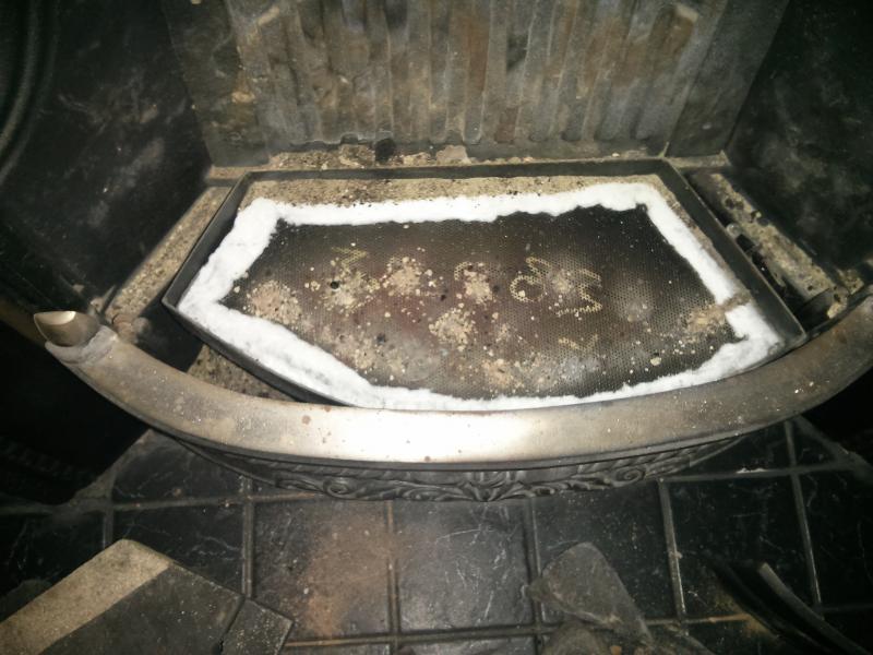

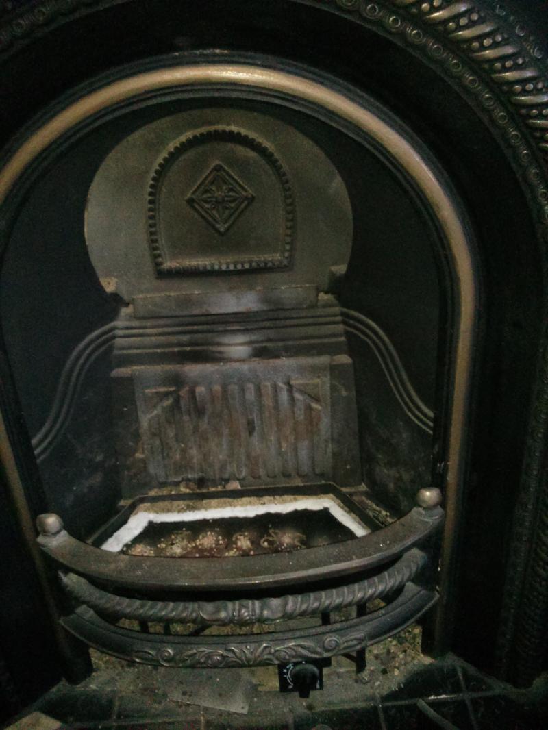

I moved recently and now own a gas coal-effect fire, pictures attached.

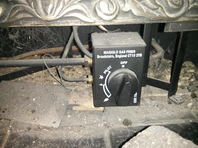

The marking on the burner controls says Magiglo BM733 and I've had a look for an online manual but can't find one specific to my model.

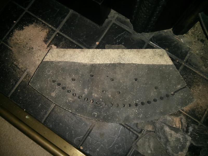

I lit the fire yesterday to see how well it burned and it was very uneven. On inspection some of the bricks were mis-placed and it was generally very uneven. Also one piece is broken.

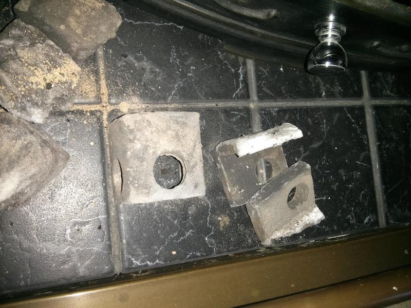

Can anyone tell me the correct pattern (if indeed there is one) for placing the bricks on the grate? Also is it possible to order a replacement for the broken piece (or even a complete set of replacement coals)?

The damper plate is fixed in an open position, it doesn't move

Bm733 is the gas valve number not the fire model number so you wont find it by searching that you should have a data plate on the fire somewhere they are usually faint or burnt off though so good luck
Your fire looks like or is very similar to the Magiglo 'custom' 16 (L16)
The broken part is called an 'aeration tube', small aeration tubes have one hole in each face (= 3) while larger aeration tubes have two holes in each face (= 6) depending on the fire model.
Use the link that 45yearsagasman has suggested and look for *manuals* at the bottom of the page (with red background) and choose *Custom 18/18 MF280* a .pdf file, this will give some idea rather than nothing.
Suggest maybe to contact *Gas Appliance Spares* Preston for advice or browse on their Magiglo page for further info on similar models, some coal set pics are not available.
http://www.gas-spares.co.uk/Catalogue/MAGIGLO-FIRE-SPARES/FIRES-NG

It looks like a recent Magiglow, since taken over by Burley. Best to PHONE them:
http://ww.magiglo.co.uk/contact.htm. Ask to speak to Chris Astley-Jones. They now won't sell to the public, will give you the part numbers, and an outlet. They will probably, if asked, send you a users booklet. The coals are fitted in a less than precise manner, compared to most.
