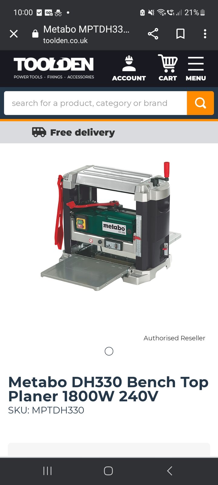

Something of this ilk possibly, "Fisher Price" derives from tool snobbery and a derogatory term for tools aimed at the D.I.Y market.
I am a Makita/Festool type Tradesman and don't mind spending more to get quality. But this tool will be used in frequently.

That is a good point and something I haven't thought of. Primarily I tend to buy timber "sawn" and then go from there, so basically its to remove the sawn edge and reduce the thickness "if required". I suppose, thereof i can use belt sanders and such like to achieve the end result of want.
That lumberjack is a titan clone and as such is really a do it yourself tool. The planer bit is rubbish due to the bit of thin tin used for the 90 deg edge to the base. The thicknesser bit is okay but I wouldn't call the results professional. I do have a titan one and it's okay for what I do, purely DIY but I wouldn't expect a pro to turn up at my house with one.
I've put loads and loads through my Titan. I bought it for one job and it just keeps going. I keep the plain bush bearings lubricated as I expect they would wear quickly if they go dry. Mine runs at about +/- 0.1mm across the width which is good enough.
