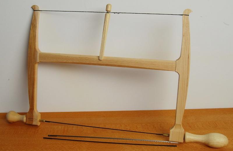

As stated above, cut the curve with either a bow saw or a bandsaw - jisaws are only really any good on thin materials up to an inch or possibly two:
Above: Gramercy 12in bow saw

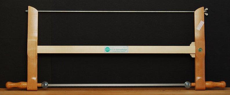

The problem with bow saws is that nobody makes them any longer in the UK (the last UK firm was Marples) which leaves only tools like the Gramercy above (although it is possible to purchase a kit and make your own) The Gramercy blades are excellent quality, but to use then in an older-type British bowsaw takes some modification of the tool. The alternative would be something like an ECE German turning saw:
Above: ECE German turning saw

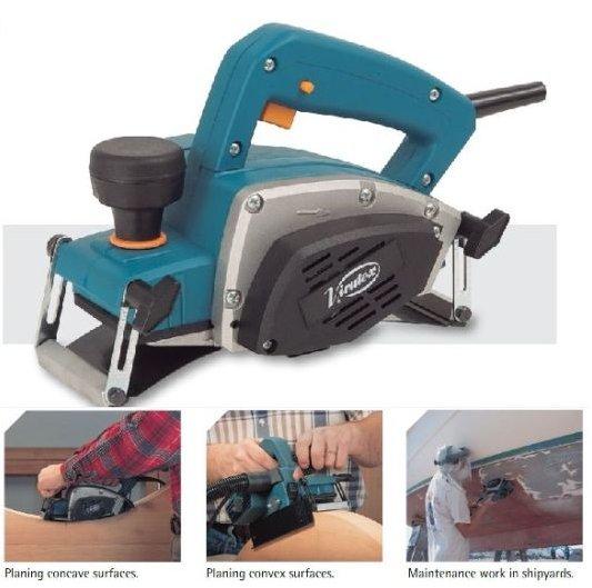

Not always the case. Curves can be planed with a power planer, but it does require a very specialised power planer made by Virutex to do this:
Above: Virutex CE96H compass sole power planer
Apart from that the other way open would be to use a router, template and trimmer bit (for widths up to 2in) or a router and home made jig for wider/long pieces. Is there any reason why your curved shape couldn't be copy routed from 1 to 2in wide stock and then glue laminated to make a wider piece?
