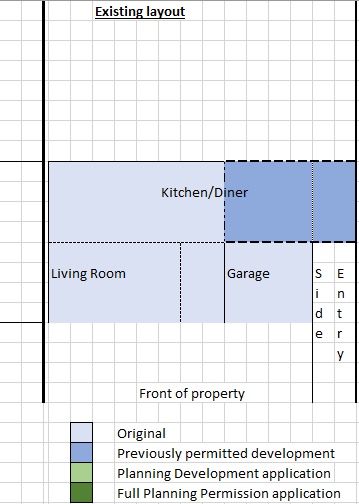

Hi. I’ve had permitted development refusal for a single storey extension at the rear of the property due to it being connected to a small existing PD which was built prior to my purchase, and subsequently the new extension then spans more than 50% of the original building. If I apply for planning permission I will be able build more but I will then lose the corner of the extension due to the 45 degree rule relating to my neighbours nearest window. I’m trying to look for a way around this and was wondering if anyone had something similar.

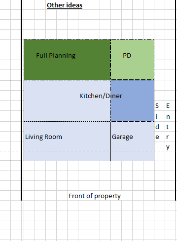

I thought about getting PD for the small extension and then planning separately for the rest, would I get away with that??
Thanks in advance

Aren't the PD and full planning the wrong way round on the alternative diagram?

If you were to build that small "PD" extension on your diagram then it could result in outright refusal of the rest, so you could end up with a choice of nothing additional to that or knocking it down and starting again from where you currently are.
You could just apply for planning permission for a design that respects the 45 degree rule. Could you bevel the corner to maximise the space without impacting on your neighbour?
It might be better to work within the rules rather than looking for ways to break them.
