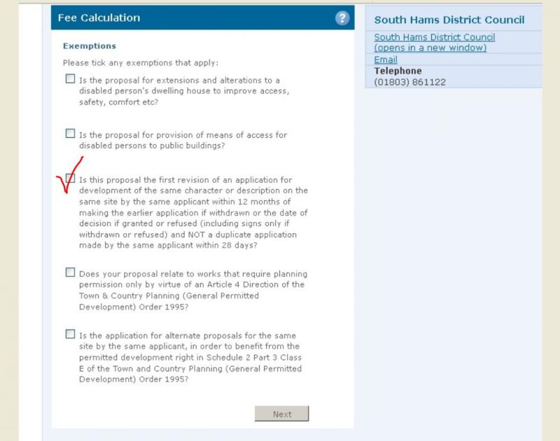

Your client is correct, there's a box to tick on planning portal that says if an application is granted or refused you are exempt from fees.
It does say that the application should be the same character or description but I've changed a double storey extension into a single storey extension and still not been asked for a fee. Why the Council can charge for NMA applications or discharging conditions when you can submit the whole application again with the required information, I don't know.
Off planning portal
Is this proposal the first revision of an application for development of the same character or description on the same site by the same applicant within 12 months of making the earlier application if withdrawn or the date of decision if granted or refused (including signs only if withdrawn or refused) and NOT a duplicate application made by the same applicant within 28 days?[/b]
The rules say that a second application can be made within 12 months - even if the original application is approved - as long as the second application is of 'similar character or description'.
Whether changing from a flat- to a pitched roof would maintain the character of the original application is a moot point. One suspects that the LPA will take the view that it would not, and would require a fee and a new application.
