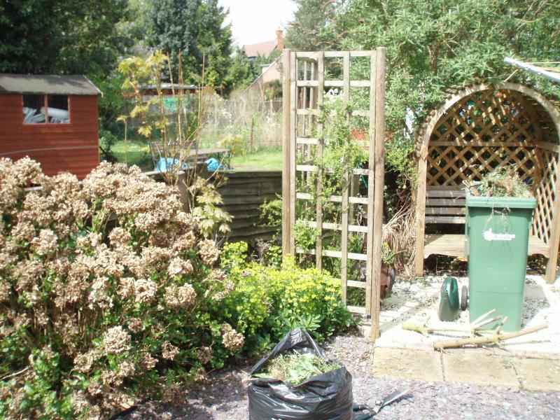

It's 560mm high from the lawn so looks like we're going to have to apply for permission then :(
Hope the pic worked this time. We dug down a bit to level the lawn area as garden was on 3 levels before we laid the lawn which seems to have shot us in the foot a bit.

Well at 560mm its obviously well over the defined limits so you may well have to apply. The planners sometimes take into account the neighbours views and sometimes they do not, unfortunately they (the planners) are a fickle bunch and cannot be predicted. If you end up applying for permission ensure you put in any evidence you can that supports your case (ie photos, supporting statements etc, additional sections showing site lines etc) to try and prove it does not overlook at all, if that is what you firmly believe! You should also get your immediate neighbours who support your application to write in letters of support after the application is registered and open to comment from the general public.

The Planning Act is quite clear on this issue: where the ground slopes or is uneven you're entitled to take the highest ground level where the structure meets the ground. As your garden appears to slope away from your house, the highest ground level will be nearest the house. If that results in the other end of the decking being a metre above ground level, then so be it. It's still lawful.
Hopefully, you'll have photographs showing the previous patio. Might be of use when stating your case to the planning enforcement officer.
