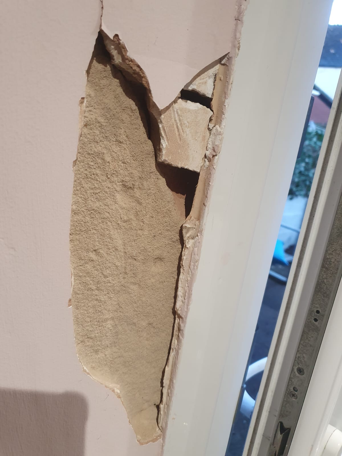

Hi how would you fix this crack near my back door ?
Got any wood glue. It's PVA so mix a bit with water 4 to 1.
Remove loose plaster.
Seal with PVA.
Let that dry for a couple of hours.
Toupret powder filler.
Fill in 2 or 3 goes allowing an hour between fills so it sets.
When dry sand smooth
