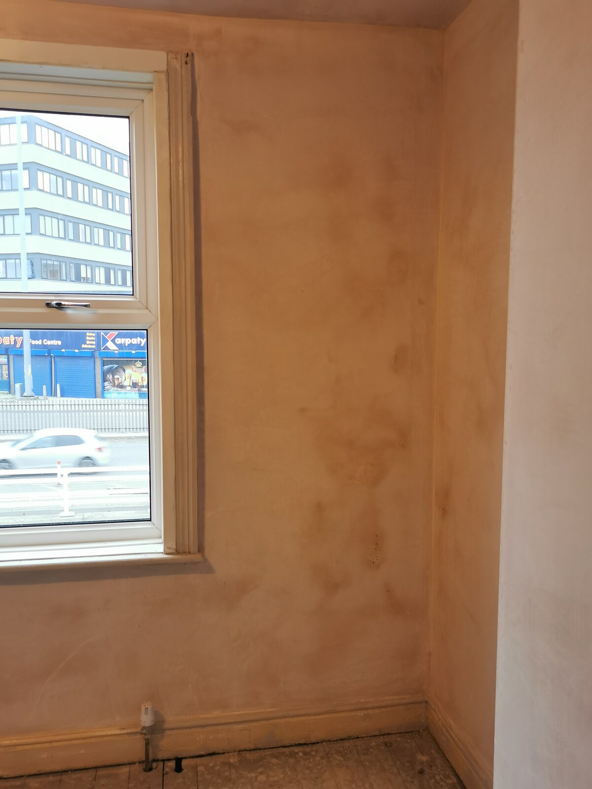

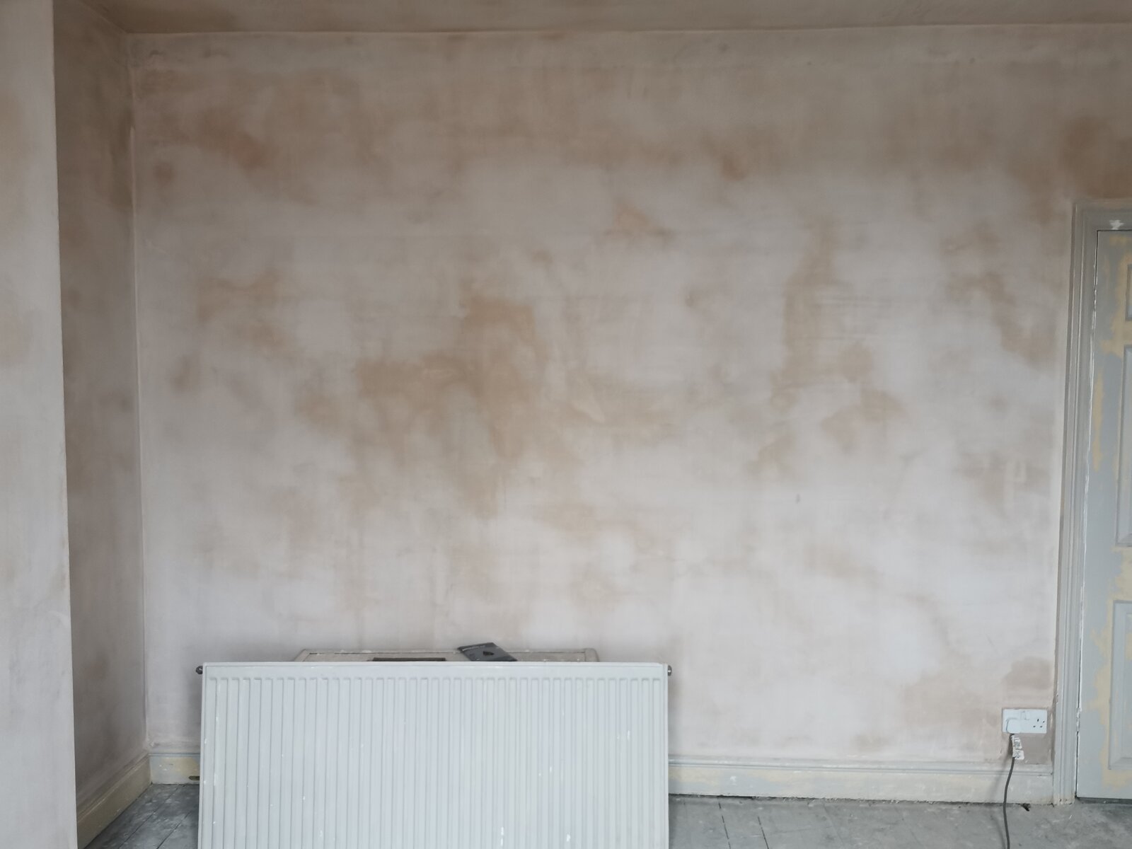

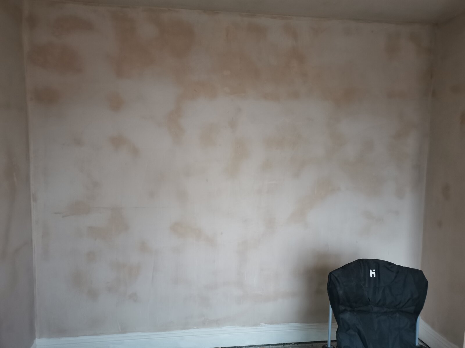

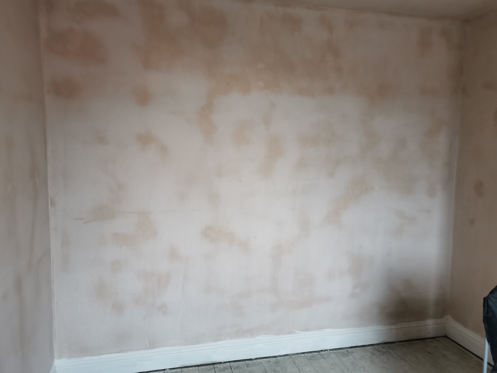

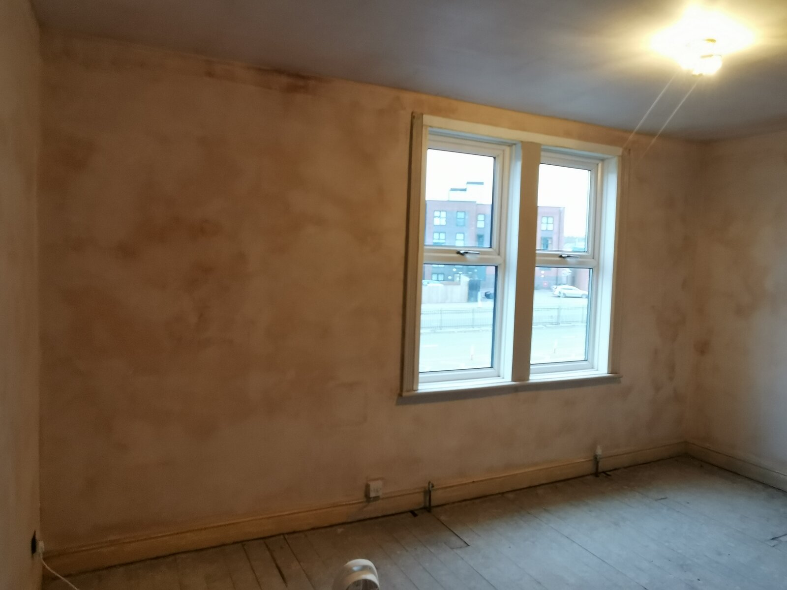

Hi,
I am currently refurbing a Victorian terrace. Plasterer skimmed the middle floor bedrooms on 25/11 (now over 6 weeks ago) and it still hasn't fully dried out- see pics. It's a mixture of. External and internal walls which aren't drying.
Property is unoccupied while I'm refurbing and the central heating is drained down to comply with the insurance. So the property is cold. I have tried using dehumidifiers and fan heaters to assist but I'm only there weekends/ weeknights as I'm doing the project around the day job, so it is cold at night/ most days. The cost of the fan heaters/ dehumidifiers is now becoming prohibitive.
I need to get this to a position where it can be painted as it is now holding up me finishing off the project- any ideas welcomed.
As I see it, either need a way to get the plaster dry OR a solution that lets me paint onto it with it still partly damp. I've had conflicting advice on the second part- plasterer has said to just paint it but a builder is telling me it will just flake off
Thanks in advance for your advice

you can use a porous, breathing, non-vinyl paint which is designed for plaster that is not yet fully dry, and allows it to continue drying.
The best-known is Dulux Trade Supermatt (and not anything with a "similar" name)
Having no vinyl, it is not very durable and will not withstand scrubbing, but it will look decent and you can decorate over it once drying has finished.
use two mist coats
open the windows whenever you can
I would not paint over any plaster that is still chocolate brown (very wet) as it will not dry.
Other paint manufacturers make similar products, labelled "paint for new plaster" but read the description and instructions carefully to make sure.
have you insulated the loft?
you can speed up drying by setting ordinary desk or room fans (not fan heaters) to blow on the walls, but you will have to ventilate away the water vapour that evaporates off. It is lighter than air so will rise through the house and escape through the loft hatch if you leave it open.
The evaporation will make the house (even) colder until it has finished. You will know, because the windows will stop misting up at night.
The damp will make timber, especially doors, warp and crack.
Do not put glue on the walls.
Grab a fan and put on. Will rapidly dry it out with air movement and better than heat.
Just a standard summer fan. Can put on timer if you want but I would leave on all the time. People don't believe me then are shocked at the rate of drying.
Dehumidifiers are best but the cost can be high
