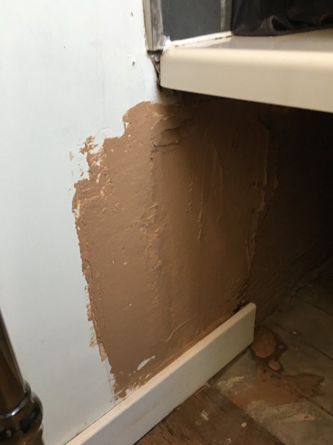

Rubbed down the surfaces with sandpaper. Wiped away the dust. Applied 50/50 PVA and allowed to dry for 24 hours. Applied second coat and immediately mixed plaster (thistle multifinish). Applied first layer of plaster and let dry for 24 hrs. It started to have a crazy paving look but adhered well to the wall.

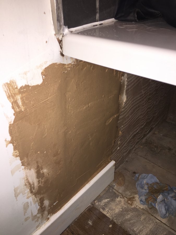

Following day I used the left over plaster in the bucket (still wet) and applied it. Smoothed it all. Looked really good.

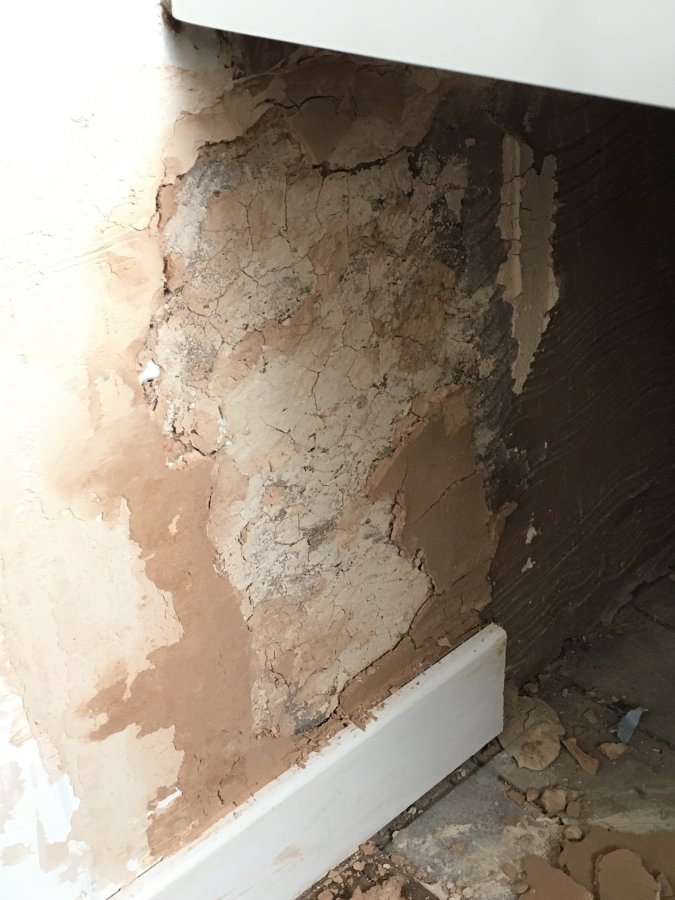

Today, had a look and the second layer had the same crazy paving look but worse. It looked like the plaster was coming away from the wall. Managed to take off the chunks with my hands.
First layer:
second layer:
And today:
I am doing something very wrong here.

Setting too quickly is usually because the plaster is old or the bag has been left open.
If mixed plaster has already started to set, it's unusable and should be thrown away. It can't be thinned by adding water or anything else.
Yes indeed, sounds like the plaster actually set in a few minutes due to not being fresh enough, and now you have set plaster dust mixed with water which wouldn't ever go hard.
