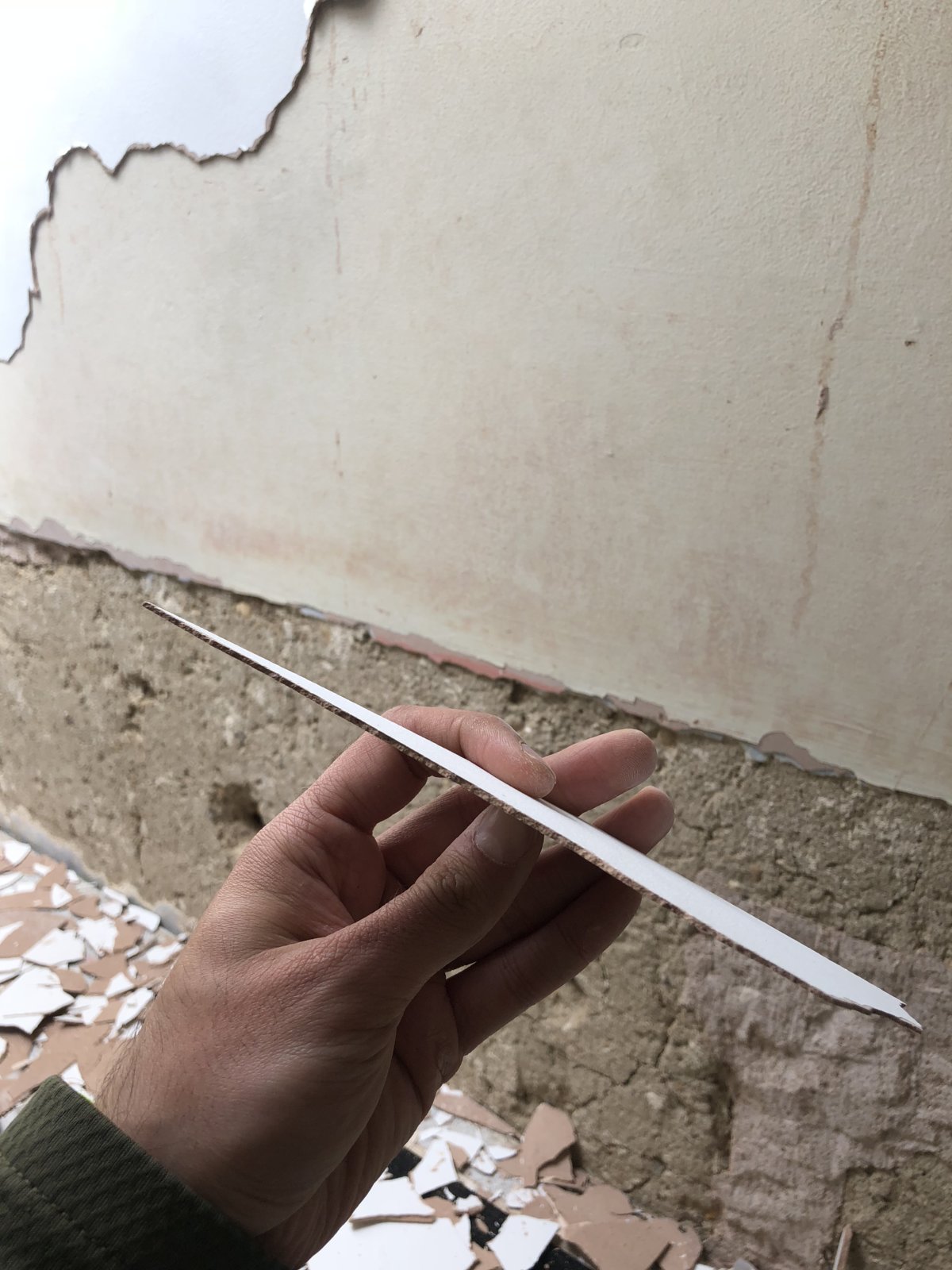

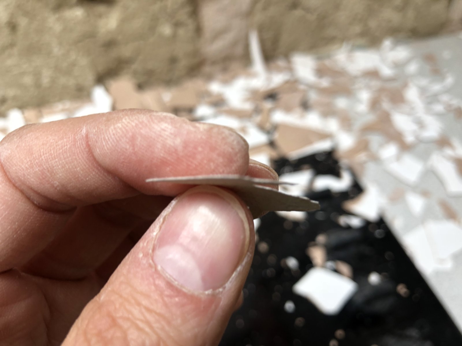

I recently purchased an old flat and removed the old kitchen splashback tiles. Then above it the plaster skim layer (I believe) simply peels off and leaves a very thin layer of something behind (PVA maybe) and then the old plaster which seems in good condition.
What are my options for redoing the skim over the old plaster and what are the steps involved?
Can I simply put 9mm plasterboard over the old plaster?

1. after hacking off then glue 1/2" plaster board to the raw background - dont trust the existing coats of skim etc. this will make the upper surface proud.
2. make good the hacked off exposure and then skim after prepping with SBR.

Thanks, I decided to go for option 1 as the plaster was clearly blown.

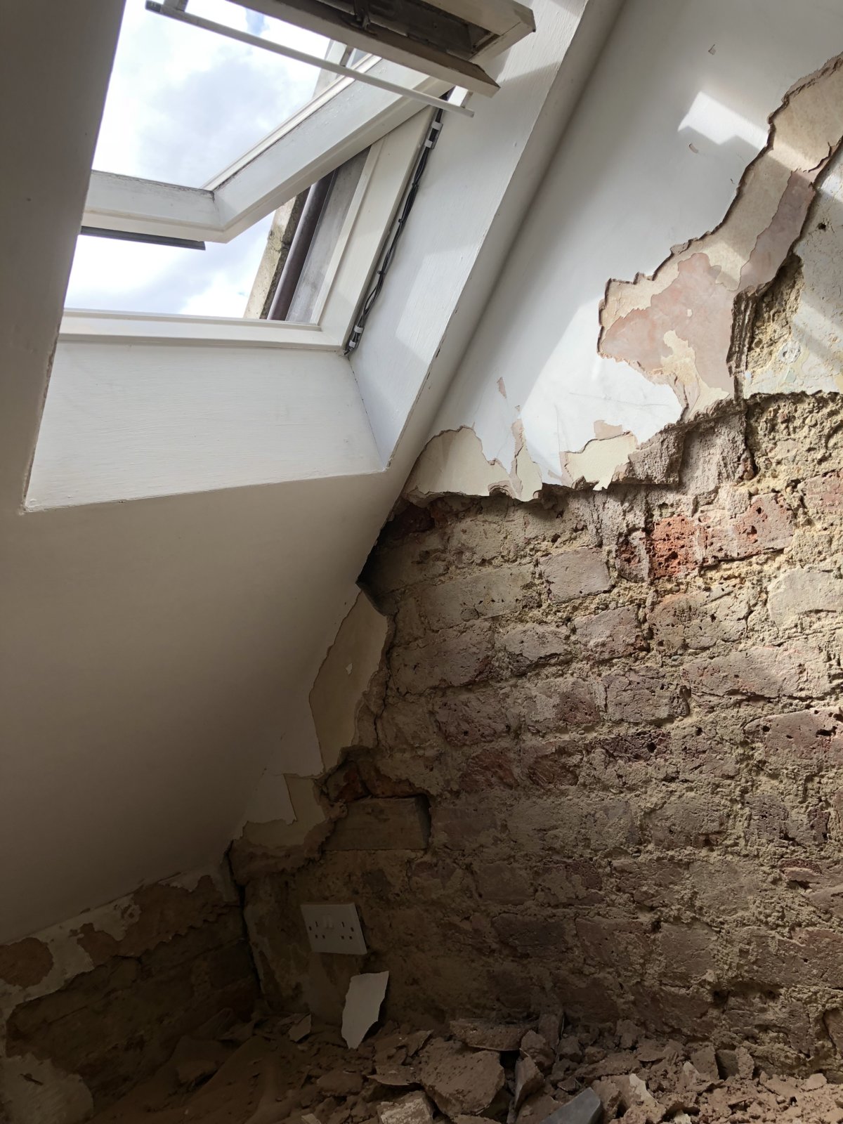

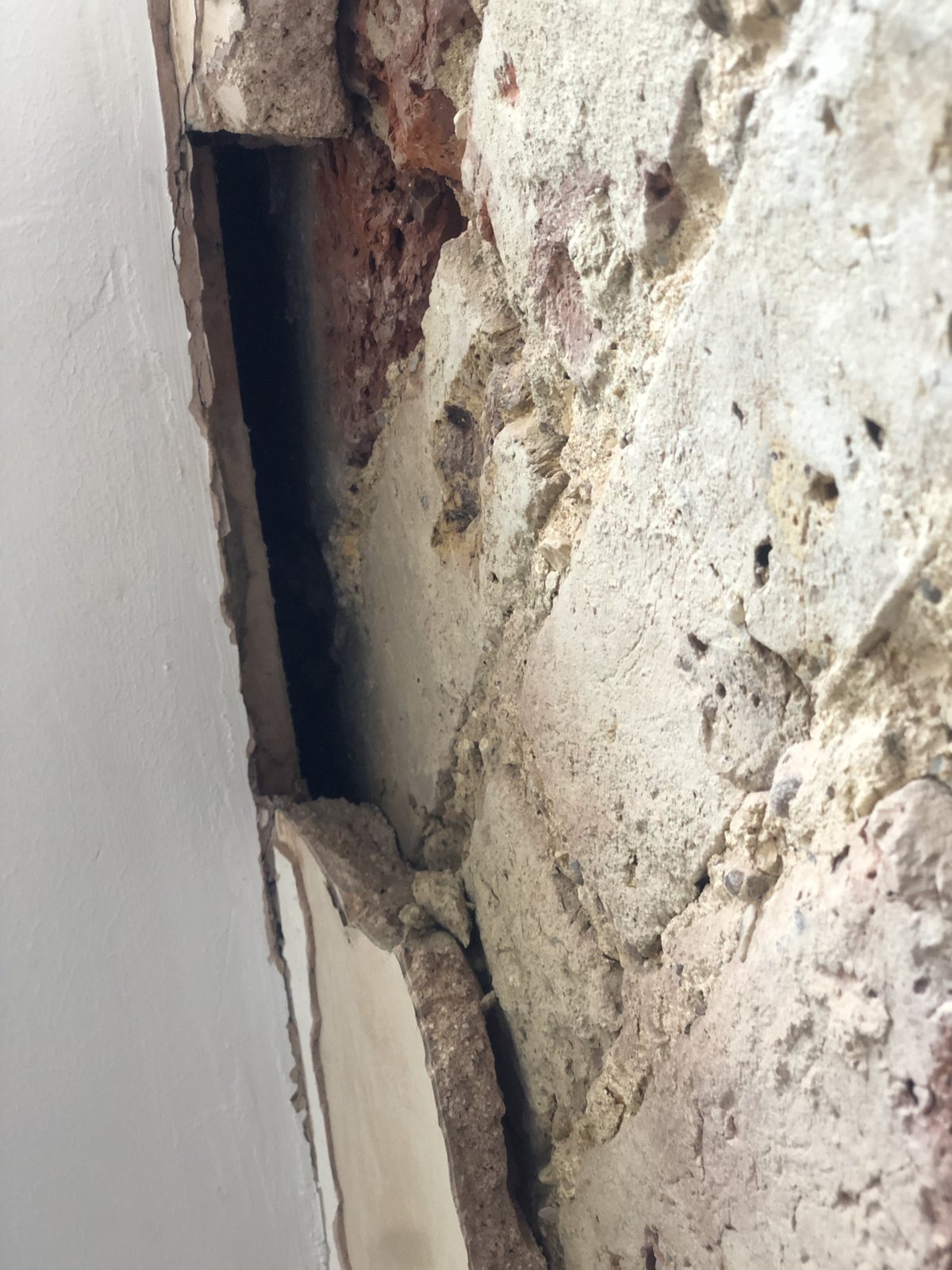

The plaster under the window has metal mesh. Is there any chance the plaster could have structural properties or is it safe to remove it from around the window and roof panel?
use a knife to cut all inside corners before removing the plaster.

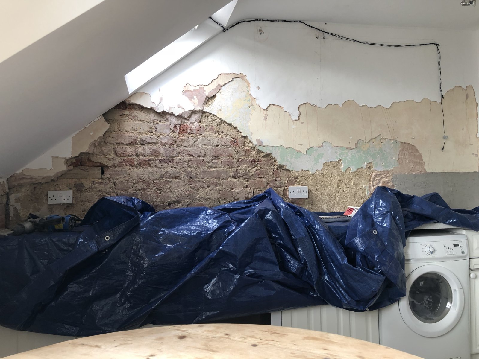

i dont understand which panels of plaster you now want to hack off - can you mark them/crayon on a pic?
leave the mesh alone after exposing it then post pic of all exposed surfaces..
theres a wood block - maybe it ties in to a rafter. maybe the mesh has some tie-in purpose too?

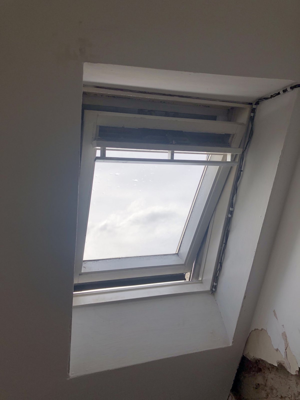

is the roof window tight against a parapet on the party wall?
plaster is typicly non - structural.
I am taking off all the plaster on the vertical wall. The metal mesh/lath just falls off with the plaster.
Not sure how the window is installed but hope this photo helps.
