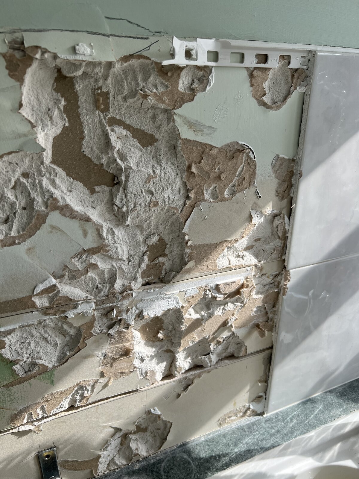

Hi. I’ve got the old tiles off but there are a lot of holes where the adhesive has pulled it off. I’m not tiling but would like it ready for a tiler when I get one. So. Do I skim the wall, can it be just tiled over or do I cut out the damaged area and put new plasterboard up. See photos. Area is only 130cm x 60cm
Thanks.

I wouldn't bother taking it off and just get a bag of Bonding plaster and skim it up to fill the bad spots and give the tiler a flat surface to work with. Give the Bonding a scratch finish which will help the tile adhesive bond better.

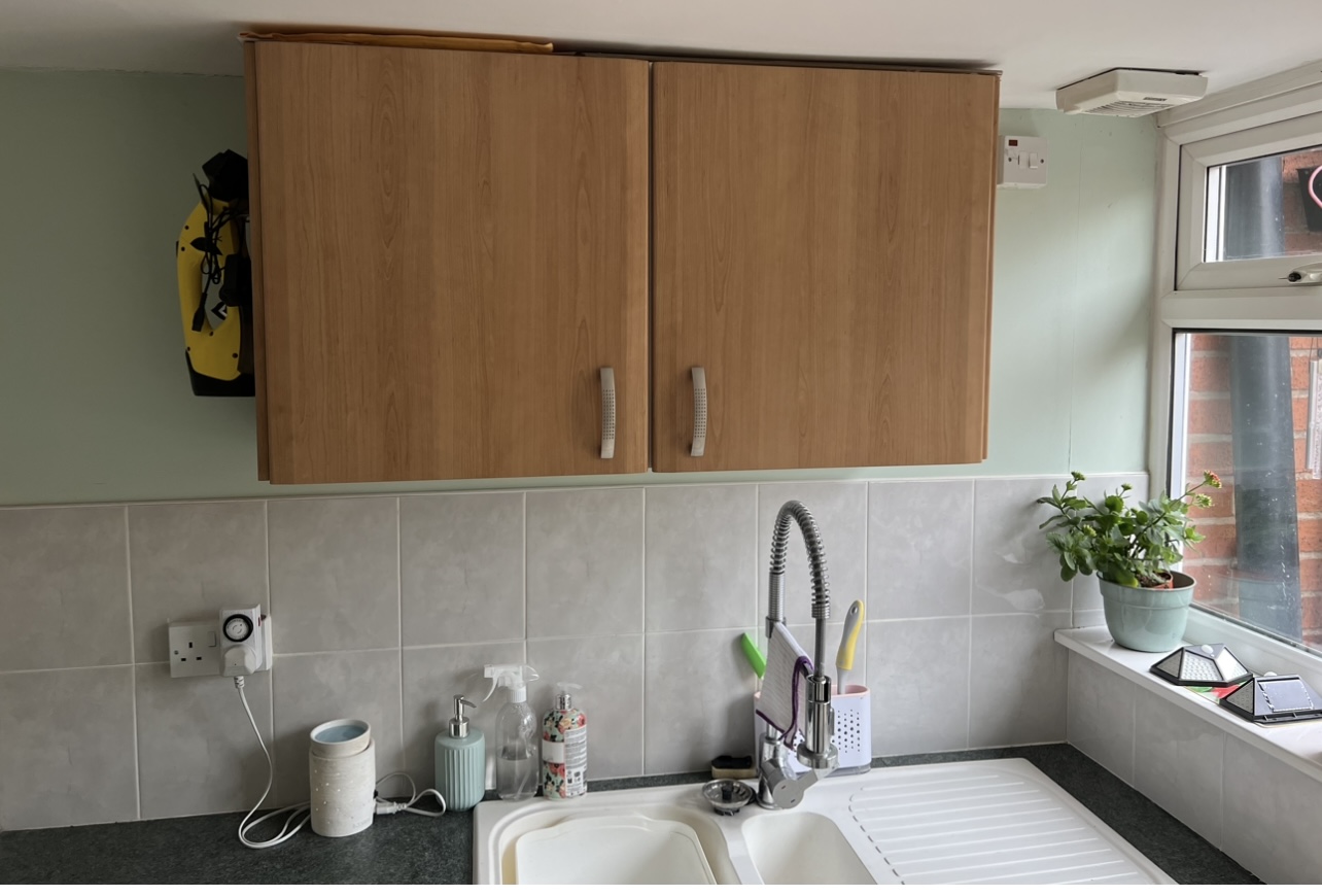

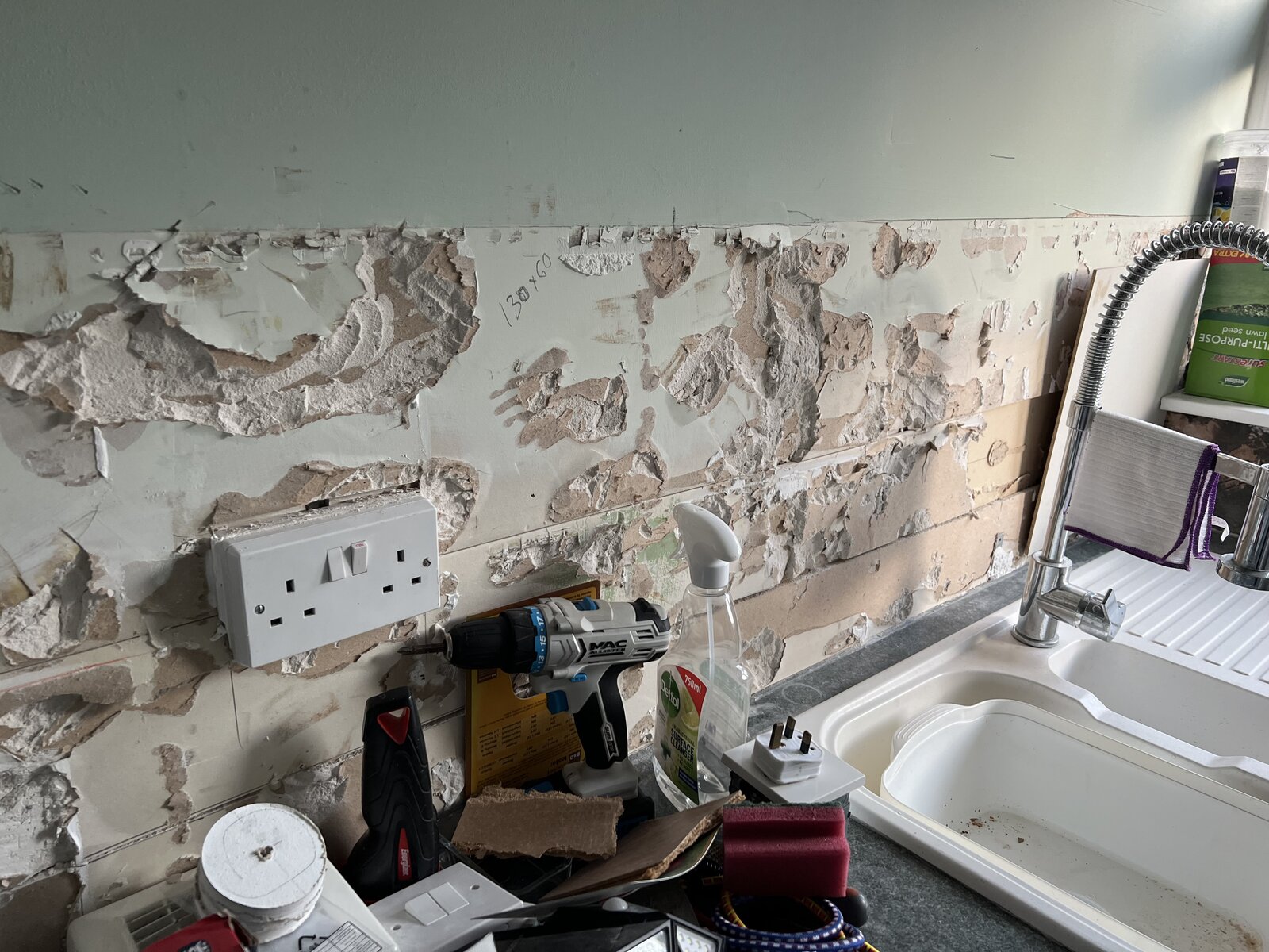

It’s a utility room, and yes it will require tiling.
It’s the tiles from the double socket going towards the window.

Splashbacks are not really wet zones so you can run a sander over the exposed plasterboard, & use any cheap filler to make good any holes or deep gouges.
Use thinset powdered adhesive if you can get a small bag or if not then any other adhesive will do - comb the wall and butter the back of the tiles.
If the original tiles are still intact then soaking them in water for 24 hrs might enable you to scrape them clean & re-use?
Only simple tools are needed to scribe & cut the window ledge shape.
A tile scribe and basic pliers will work - after scribing the tile you can nibble away
with the pliers to form the shape.
